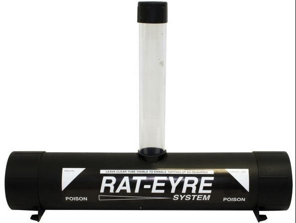

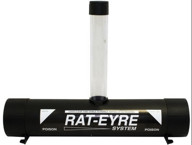

Regarding external insulation, rodents and other animals like softer insulation and use it for their nests. Coating with something they don't like? what wwould that be, ( please don't say a poison as this was mentioned by one Dairy farmer using Primary Pro to insulate his pipework on the production line 🥺)
The problem is the rodents, not the insualtion as 100% they will be eating other things and getting into all sorts of places. What's needed is to remove the rodents, traps or other ways
I had an issue with water rats and used the same rat eyre and that sorted them
