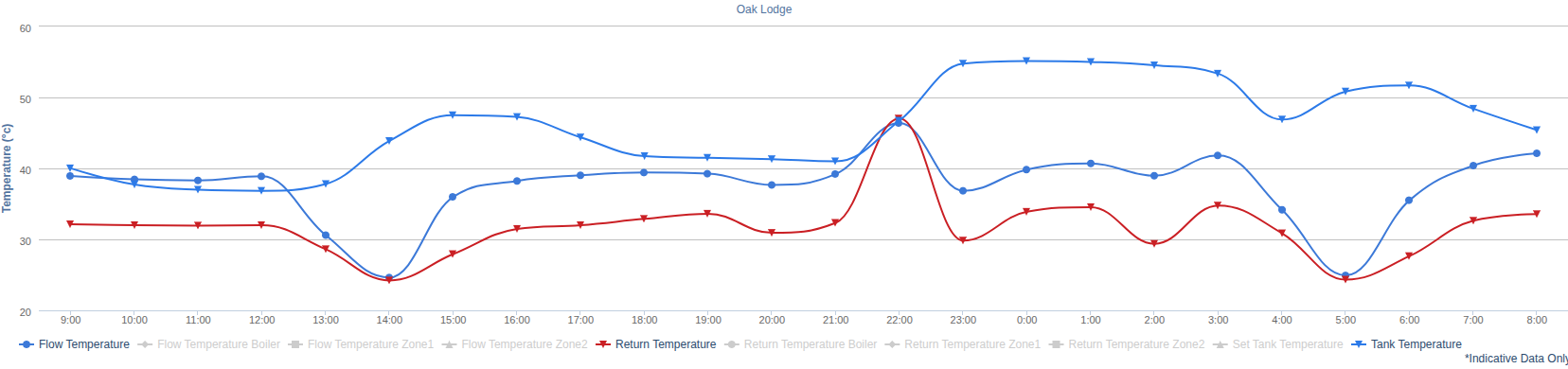

Looks like your graph is just from one of the temperature sensors (some have upper & lower fitted) - i would question with that consumption and tank size if 55C and 3x heats per day are required.
We do 1x heat to 47 of the full 250li per day and it covers washing up, 2 showers + kids bath per day
I believe there is a single sensor mid-tank - this is the label on the tank
This is yesterday's daily graph from MELCloud

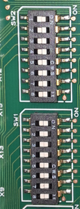

I looked at the dip switches on the FTC 7s today. On my units, they are tiny rocker switches, rather than slide up / down. Is the dip switch "on" when pressed down on the side where it says on?
Posted by: @f1pIt's the white points to the side with ON
I presume that Home Assistant project you screenshot earlier would tell you the current positions as i can tell which one i think you are running
So, if the rocker is down at the ON side and up on the OFF side, it is ON?
Yes I do have Home Assistant, but it is using the MELCloud integration to gather stats, so nothing shown with regards to any FTC DIP sw settings.
Posted by: @f1pDown to the side marked ON is ON
I am pretty sure that on mine, they are set the other way - the ones that are supposed to be ON have the sticking up bit up at ON side, and are pressed down at the OFF side... I did take a photo, but the detail is not good enough to really tell. I'll check again.
