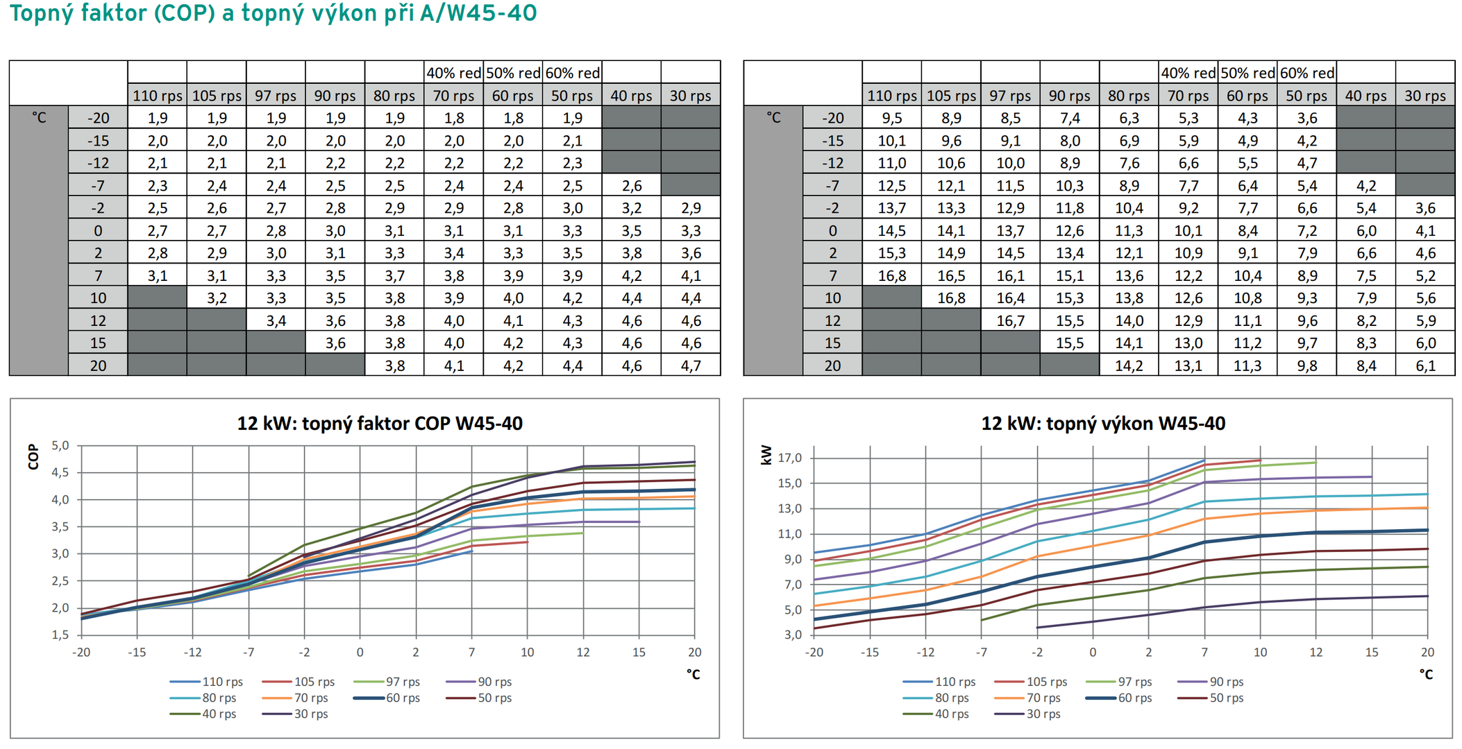

Your energy: 12 kWh
Posted by: @davec
The suggested replacement of the Vaillant 12kw ASHP doesn't look to modulate down very far with a minimum heat output of 5.8kw, so considering a Grant 12kw which has a much lower minimum heat output.
ASHPs do have a minimum compressor speed. The minimum heat output at that speed depends on air and water temperature.
12kW Vaillant with 45/40°C water has a minimum power of 3.6kW at -2°C air, 5.2kW at 7°C air.
That's because Vaillant labels according to power at -7°C air, so the same machine is a "18kW heat pump at 7°C air / 35°C water" and "12kW at -7°C air / 45°C water".
No idea how Grant labels their heat pumps, some manufacturers go for the bigger number, others are more honest, but make sure you're comparing apples to apples and check the actual capacity of the heat pump at your actual air and water design temperatures.

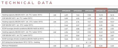

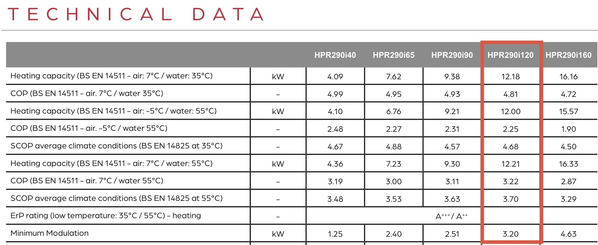

Hi @bobflux thanks for pointing out the difference in the manufacturer’s spec lists.
When I check the Grant tech specs, to try and compare the modulation range against the Vaillant table you provided, it states a minimum modulation of 3.2kw heat output, the missing info is at what external temperature this is for.
IMG 0137
This is an important detail that I am looking at while trying to decide what ASHP to go for as a replacement for our Peak unit. Following my own heat loss calculations in Heat Punk it has come out with a 8.5kw heat loss at -3 for our property. This differs from the Heat Geek calculation of 10.3kw as this was done with an internal temperature target of 21 degrees and we only want to target 18 degrees. This would be with 40 or 42 degree flow temp at -3 to achieve our target temp.
This heat loss looks to put us in between model sizes either too small or slightly oversized, so the minimum modulation for the heat output of the ASHP will hopefully allow us to avoid too much cycling when the external temperature starts to increase.
Looking on the HeatPumpMonitor website their Heatpump database includes minimum modulation tests with real world installs. At 15 degrees external the Vaillant 12kw will bottom out at over 5.5kw heat output while pulling ~900 watts. The Grant 12kw also at 15 degrees external bottoms out at ~3kw heat output with a draw of ~500 watts.
Vaillant page: https://heatpumpmonitor.org/heatpump/view?id=5
Grant page: https://heatpumpmonitor.org/heatpump/view?id=34

@davec
Posted by: @davec
At a wild guess a low external temperature in order to flatter it!  If they were proud of the figure they would bother to tell you the information you actually need!

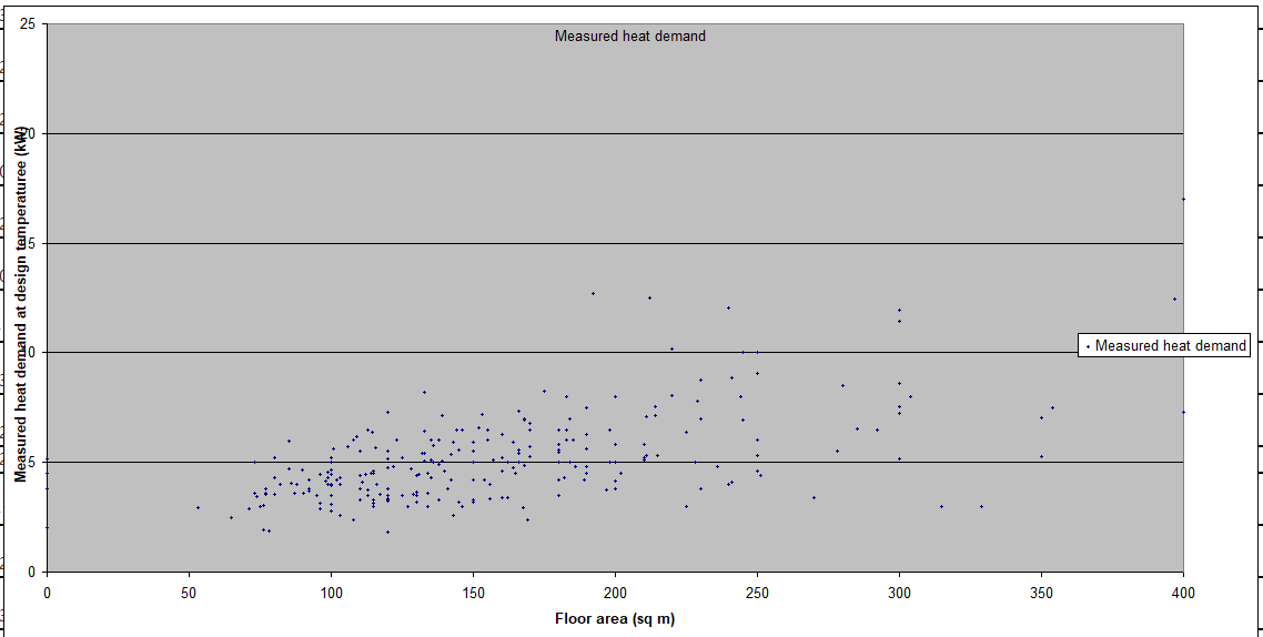

Regarding falling between model sizes I was in a similar position, being apparently stuck between model sizes.  In the end I put effort into refining my heat loss estimate by using information from gas consumption.  Surveys said 16kW, my own calculations 10.5kW, measured consumption was 7kW.  The last is a perfect fit to the Vaillant 7kW, and turns out to be one of the best decisions I made.  The difference between 10.5kW and 7kW is accounted for entirely by air change rate.  If this calculation hadn't worked out I would perhaps have gone with the Mitsubishi 11.2 for which full modulation data is available and wouldn't have touched any heat pump for which I couldn't obtain the modulation data on the grounds that, if they dont or wont provide it, they have somethin g to hide.
Of course this may well not apply to you but its worth observing that following scatter plot, taken from heatpumpmonitor, shows measured loss vs floor area for about 250 systems.  Notably only one system is both <200 sq m and >9kW
