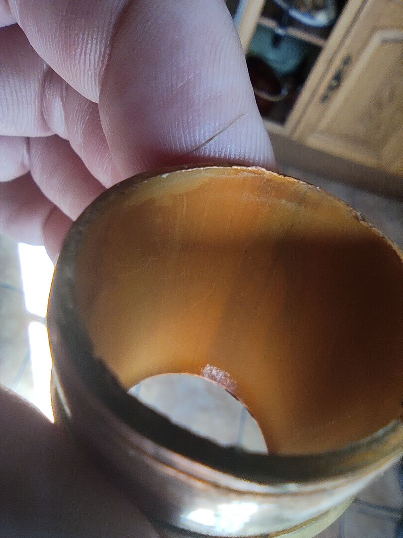

That sounds like text book biofilm (I used to work on very high purity water systems for IV use and experienced it several times). If you still have the pipework you cut out, can you swab it out to see if it’s slimy. If it is, then that’s the cause of you colouration and corrosion.

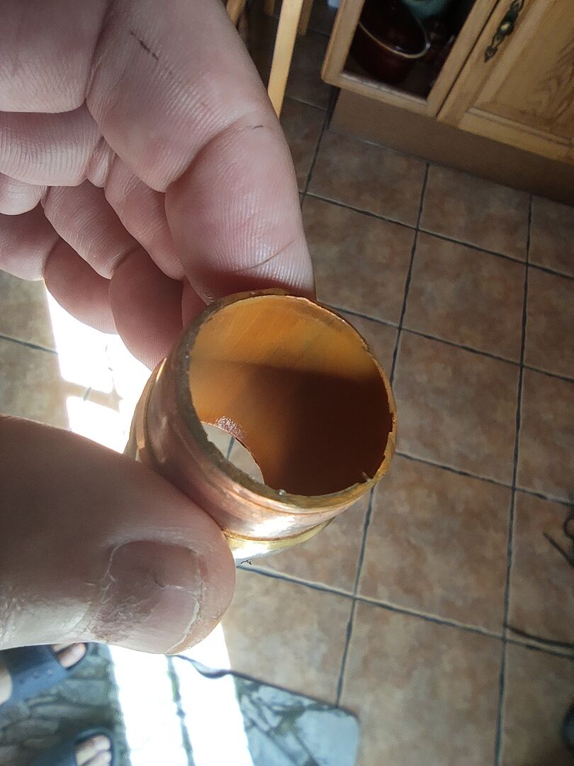

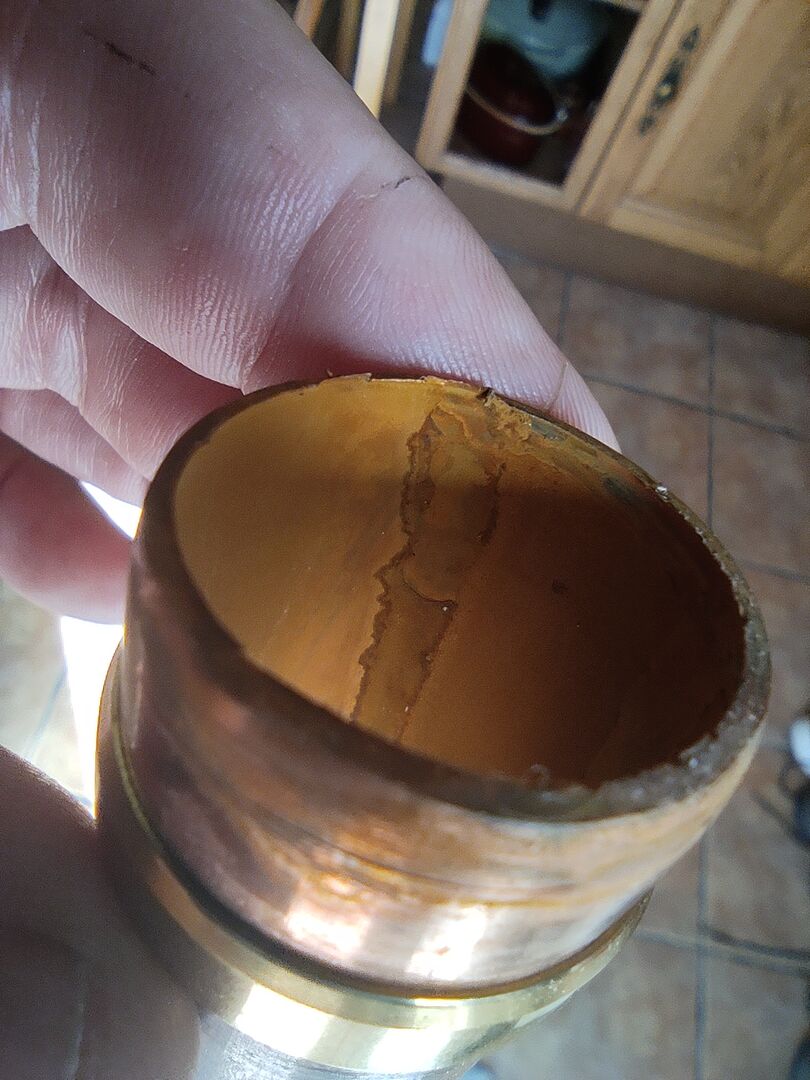

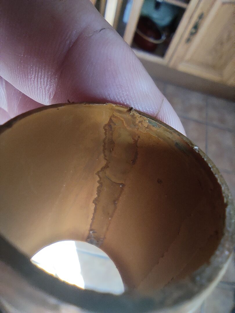

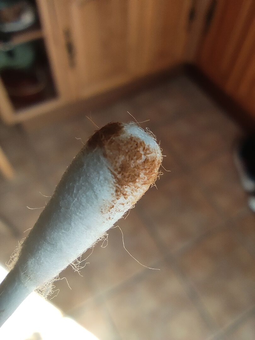

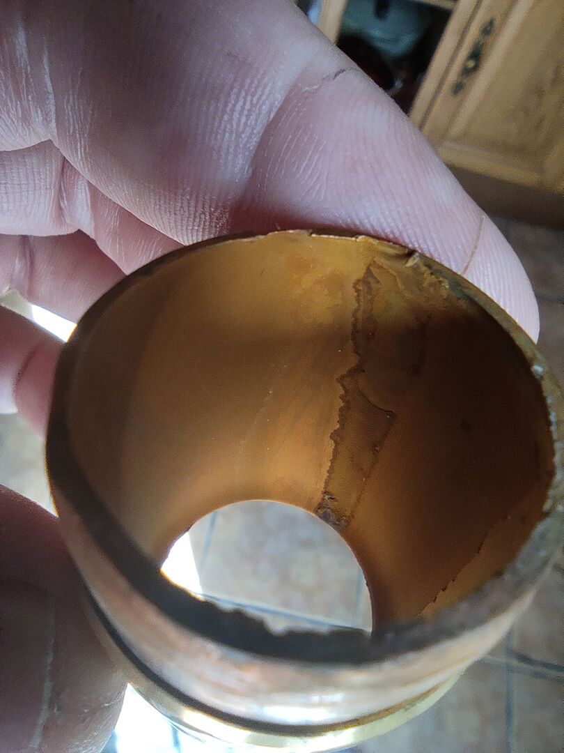

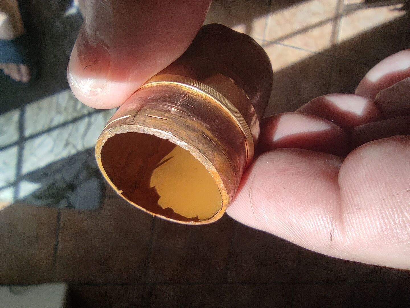

It's definitely not slimy. It's dry and powdery.
When I swabbed some on a dry cotton bud, I could see extremely fine orange dust in the air in the sunlight streaming in through the window as I dislodged it.
Some pictures, as best my phone camera will manage:

That’s not biofilm. Looks like a very fine particulate rust, but fine enough that I doubt it will do too much harm. If the cleaner doesn’t shift it you might have to live with it, as long as the inhibitor stops it getting worse.

@old_scientist You will probably find that most of it has settled out in the rads or the volumiser. Anywhere where there isn’t laminar flow.
I had a somewhat similar situation, I had just over 300L system volume but the installer only added enough inhibitor for 100L. I found a little black sludge when taking off a couple of rads for decorating. But I just rinsed them and added the correct amount of sentinel inhibitor. I know that BG has switched from ferrnox to sentinel, as they did it for me as part of service. If you are going to be servicing it in the future, might be worth getting some test strips, but they have to match the inhibitory system you are using.
