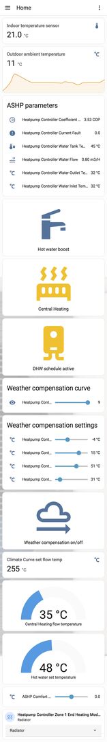

I have found the setting which changes from rads to UFH so that looks like a good workaround if I need it. That said, coasting nicely at 35°C LWT presently and 21 indoors which is perfect.
I have slightly redesigned by dashboard with a selector at the bottom so I can easily change the above. This is the main dashboard I use for the control side of things. Strangely with weather comp turned off the WCC set outlet temp defaults to 255°C. No idea why.
IMG 5380
I'm minded to keep it as it is for now and then just use off/on automations to trigger if OAT is milder (probably above 12°C or thereabouts)- as we are approaching the spring and slightly warmer weather.

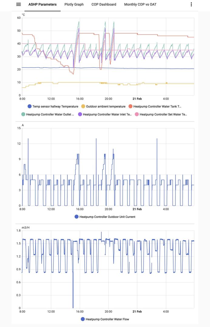

IMG 5357
Please excuse my persistence, but I am struggling to understand what triggers the pump on-off. I presume it is some internal check or external signal. So, as a consequence to this, RWT approaches LWT, as there is no fluid motion.  Would you agree ?

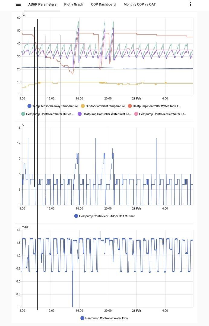

Posts: 3109
Posted by: @tasos
I don't think so. If you look at the bottom of the three charts, there there is always water flow, apart from one brief moment near the DHW spike. I have essentially the same pattern on my Midea charts. The step changes in water flow do appear to coincide with the on / off periods of the compressor (shown by the middle current chart) and the ups and downs of the LWT. But I don't think any of us has worked out exactly what the control logic is, or how it is implemented, which is to say we are all struggling!
(@benson)
Posts: 301
@tasos as above the pump is always running...

(@tasos)
Posts: 87
@benson My system is a "simple" one: no DHW, no defrosts, no decontamination. So it is rather easy to decipher control logic. Would it be possible to see some data from a "simple" period of your heat pump ? i.e. just heating ?
Midea MHCV10WD2N7 R290, 5.8kWp energy community solar power.
(@benson)
Posts: 301
Posted by: @tasos
@tasos the graph above from around 2100hrs shows the longest space heating run I'm going to have a plot for, without a DHW reheat. This is when LWT set point was 35°C.

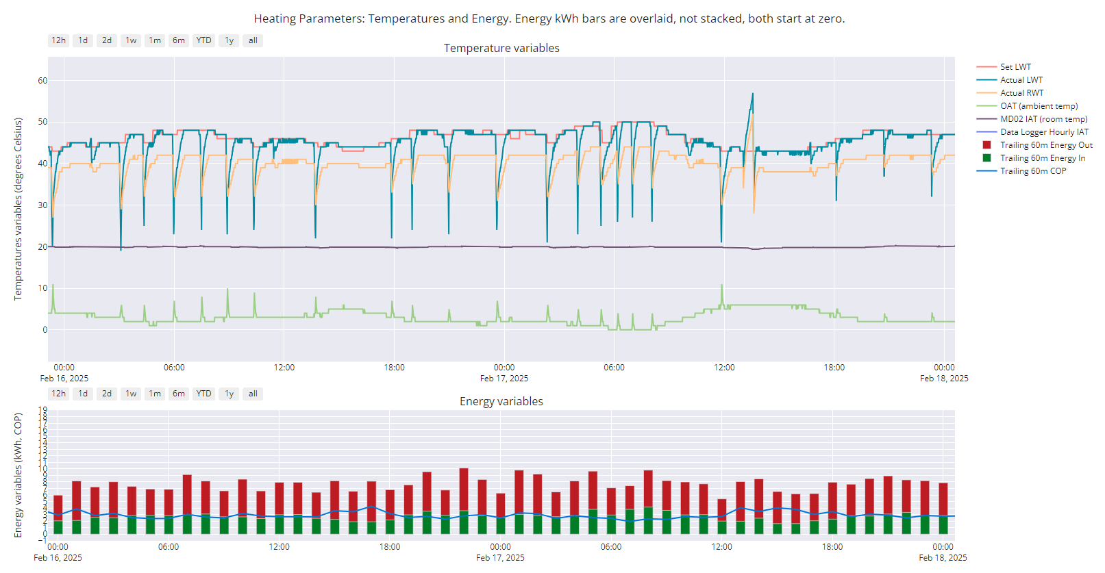

(@tasos)
Posts: 87
Hi all. I have made some progress regarding cause of cycling.
First thing I noticed, is that cycling is exaggerated when set LWT is less than 40 C. For example, have a look at this diagram:
no cycling
As you can see, as a result of OAT being below 10 C, set LWT is above 40 C and leaving LWT is around there.
However, in this diagram:
21 2 26 orig
set LWT seems to be below 40 C, causing the system to cycle.

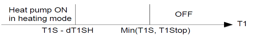

Now, why does this happen ? Well, I think because of "water temperature hysteresis of activating heat pump" logic:
coupled with lower LWT limit in heating mode (dT1SH is 5 C and lower LWT, 35 C for my setting).
To figure out the exact details, 1 minute plots of a couple of cycles would be very helpful.
This post was modified 8 months ago 2 times by Tasos
cathodeRay
(@cathoderay)
Posts: 3109
Posted by: @tasos
That is a very abnormal period, almost all defrosts (LWT below RWT) and two steady state runs (both afternoons, second one also has a DHW reheat). It is not normal Midea slow cycling, that chart tells you nothing about normal Midea cycling. It does tell you a bit about steady state running, when the actual LWT does approximate to the set LWT.
In the second chart, the OAT is mostly around 10°C, and that is in the normal slow cycling range.
