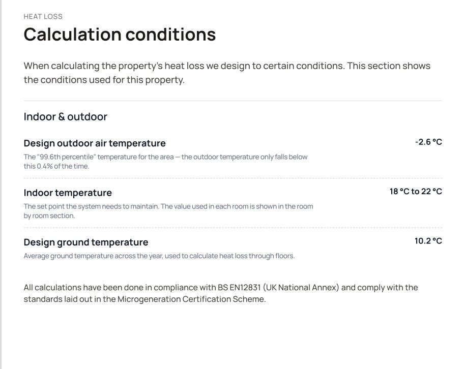

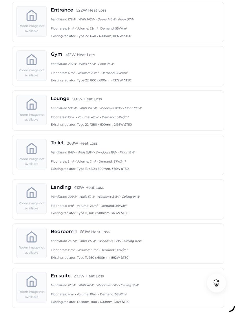

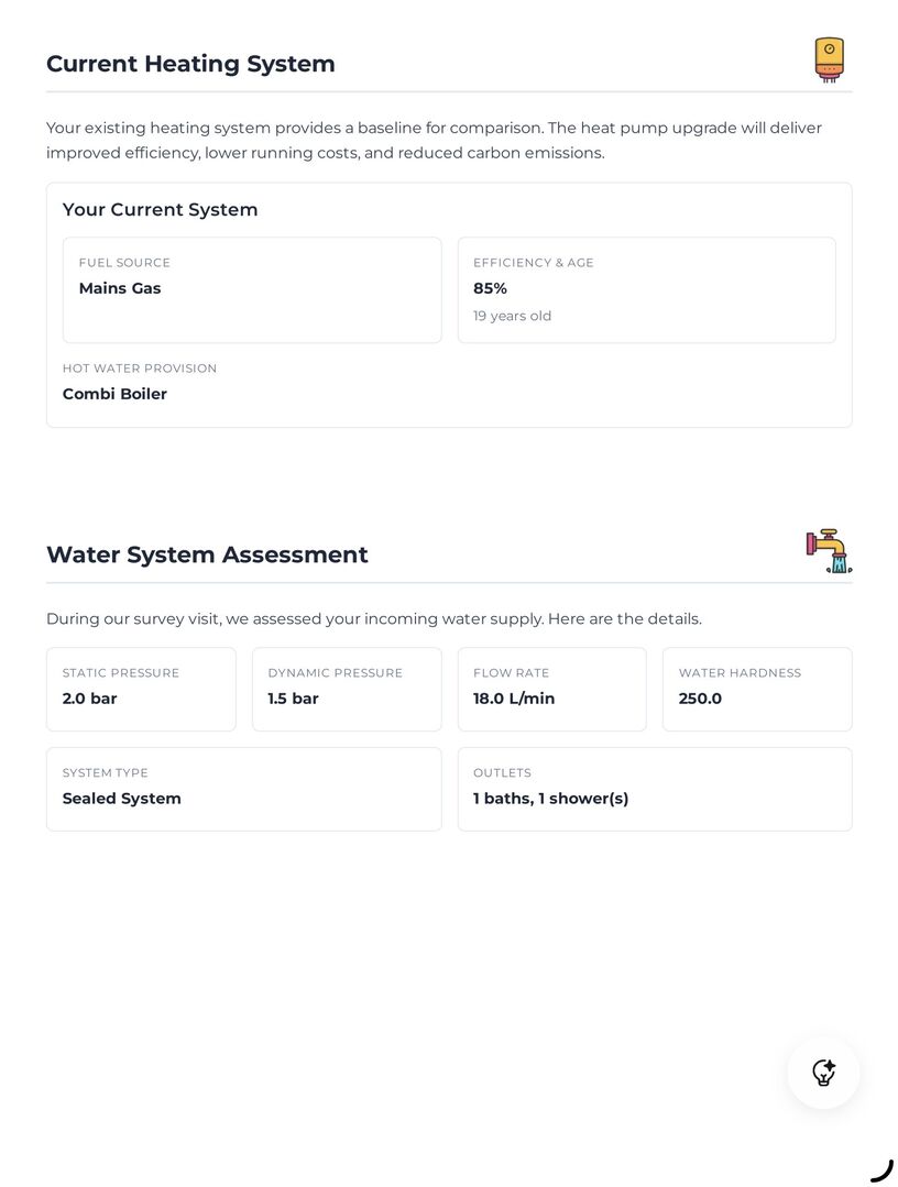

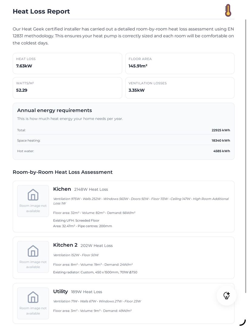

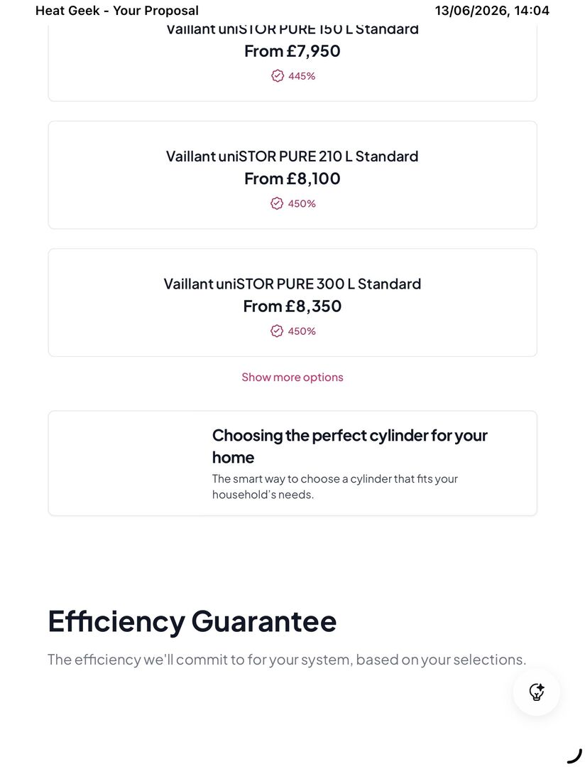

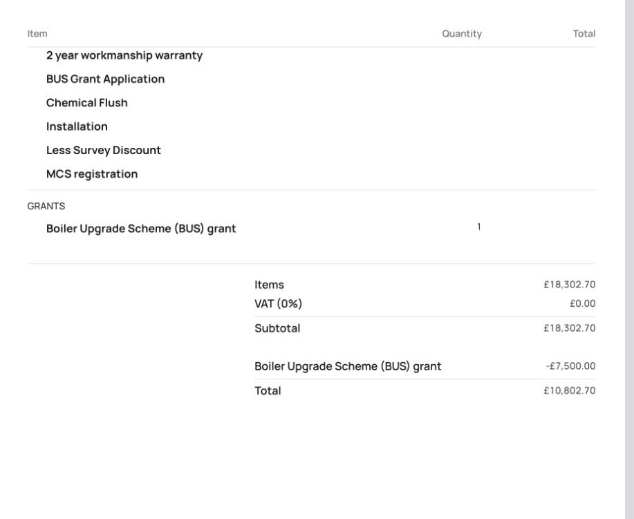

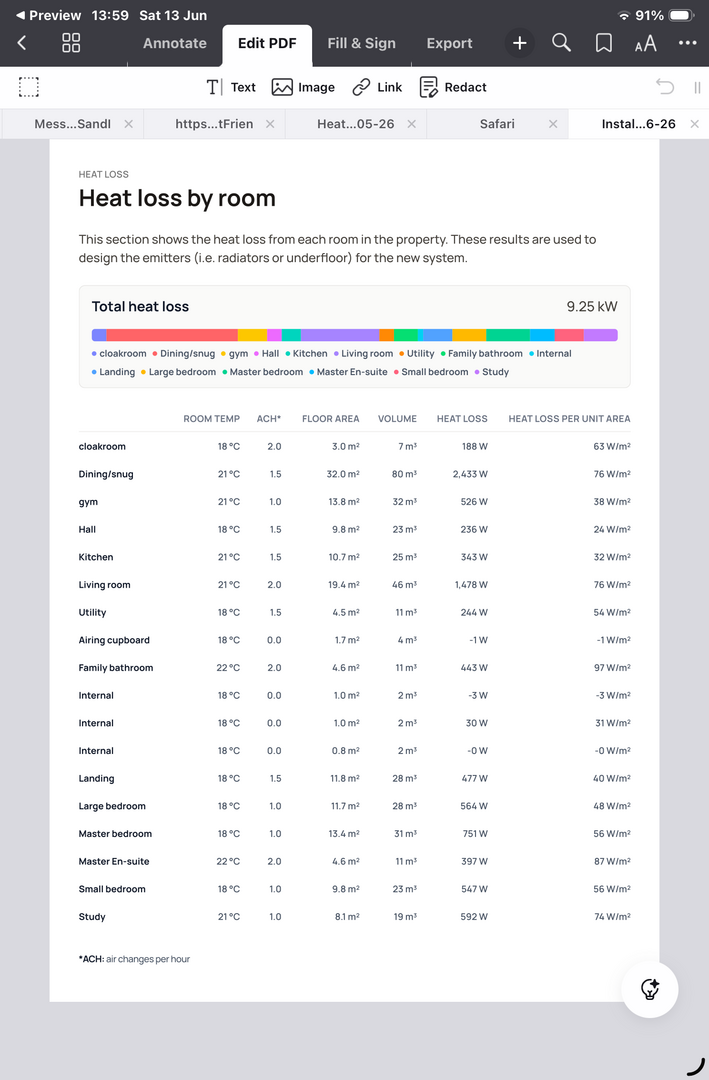

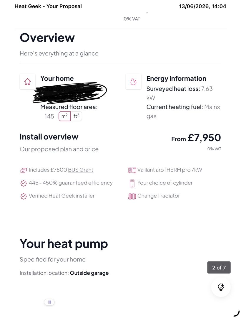

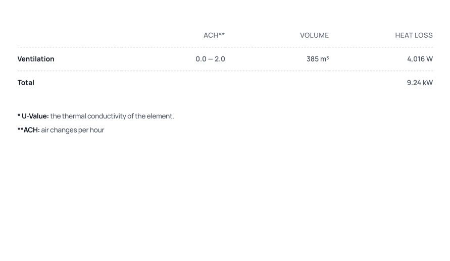

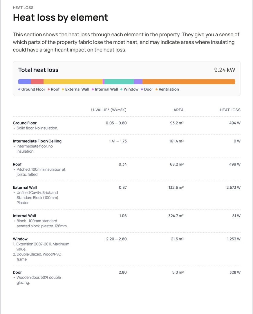

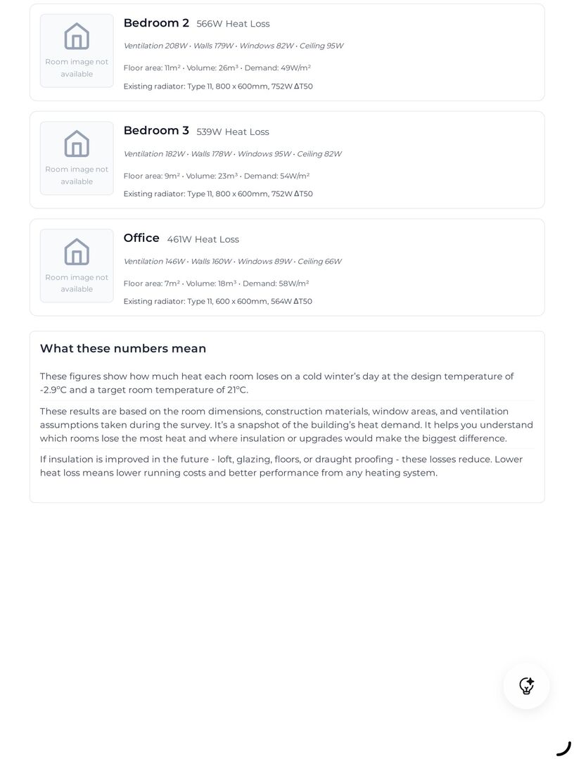

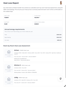

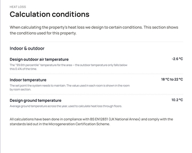

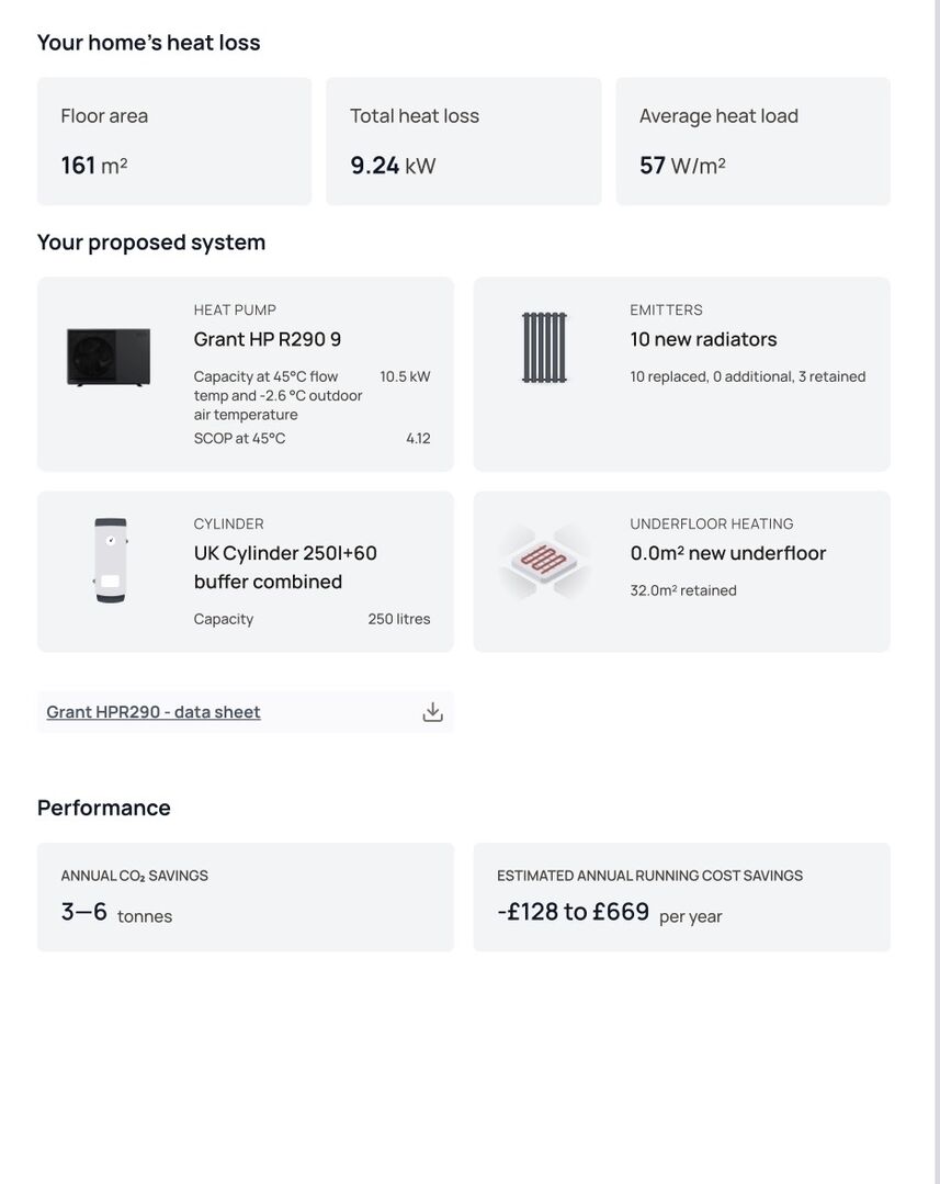

Thanks for your responses! Here some screen shots from the proposals. Any comments will be gratefully received.

Thank you, the heat loss figures vary but not by too much.
The costs are significantly higher than what we saw, but that is partially explained by the large number of radiator replacements at least one of the quotes includes (we had a couple of rads to upgrade).
It does seem that you have some "low hanging fruit". Like the cavity in your external walls is unfilled and the insulation on the roof is suboptimal. I would first address these, since they have very high ROI.
These measures will reduce the heat losses and:
- reduce the number of radiator upgrades (so a lower cost of installation)
- lower your energy bills (independently of whether you have a heatpump)
- have a smaller heatpump, better suited to your home (much better than to end up with an oversized one after insulation)
After this, I would get a new epc completed, which tends to enable many installers to estimate the cost of a heatpump installation on line, without a survey.
In the meantime, you can also use your gas usage data in the RHH calculator to obtain some indicative measure of heat loss and pump size.
This may not be what you would be looking to do since you were looking to install a heatpump, but may not add too much time since these insulation upgrades are fairly common.

Whats your current gas annual usage, does your house cool a lot at times or stay reasonably warm, do you have half hourly meter readings.  The ventilation loss is very high, have you got draughts?
As @batpred says you have some low hanging insulation upgrades.  What is the urgency to do the heat pump, could it wait a few months while you do those?  That said it might not make a material difference if you did them after installing the Heat Pump. Heat Geek are recommending the 7kW Vaillant so unless you can get your loss below 5 (the next size down) then you are going to be going with this anyway.  I would avoid the 10kW Grant though, its almost certainly well oversized - unless your loss really is 9kW, which is unlikely, and will certainly not be the case if you do the insulation upgrades.  Also heat geek are committing to a specific efficiency, and a good one at that, another reason to go with them.  Perhaps push them for more rad upgrades, although given the efficiency they are committing to the argument for doing so is weak.
If you can provide the info in the first sentence and comment on urgency we can advise/narrow your options/sequencing further
@jamespa I noticed that in the Heat Geek design consultation output - heat loss report. For ours (and almost all our rooms are airtight), half the thermal loss was shown under ventilation- not credible. Eventually they updated ours figure to the highest band of the gas usage.

The house does lose heat. If the heat is off over night during winter it'll be cold in the morning. The open fireplace in the living room is the only draughty spot in the house. Annual gas consumption is 14,313 kwh. Cavity walls are not insulated and its not an option. Loft has some insulation and more will be added. However, we've been told that this won't make much of a difference.
