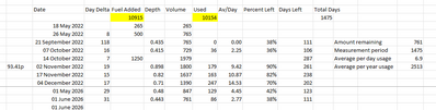

@jamespa I used an ACH of 0.5 in most rooms aside from two (both of which have wood burners) where I used 3.5 - I went with what was suggested in HPunk (if I recall correctly).
We don't have gas - being rural, the village has no gas main - all we have is oil - I based an estimated HL (independently from HeatPunk) based upon oil usage averaged over four years and this gave a figure not a million miles away from HeatPunk. We actually run our house at 18-19 degrees so I ran an option in HeatPunk with those temperatures so as to cross correlate. The figure that I wrote in my entry above is -2 to +21 and is probably more aligned to what an installer would use in a HL calculation.

Your oil consumption suggests a loss of 7kW which is way different to the Heatpunk results. IMHO, you need to get to the bottom of this discrepancy before proceeding. Do you use the wood burners much and how did you get to an estimate of 12kW based on fuel usage? You are right that installers will design to room temperatures 18 (bedrooms) - 21 (living rooms), its mandated in the MCS rules.

I'm sorry, a moment of old age stupidity - our annual usage averages out at 2513, not 1250. I'd made a calculation mistake several weeks ago and corrected it but then misread the latest data - so, twice what I said originally ! what a numpty !

Ah 2513 vs 1250 makes a big difference. Roughly how many evenings and for how many hours do you reckon the log burner is on for in a year. If we then assume 5kW and add it to the yield from the oil we should get a total heat input. Divide that by 2900h and you get your core heat loss estimate If you separately divide the total by 3000h and also separately by 2000k, these give two useful limits in addition. However but this is based on 20C room temp.
Im guessing your daily average room temp is perhaps 17.5. If we assume that the average OAT in the heating season is 7, then thats a deltaT inside vs outside of 10.5 as opposed to 13, so if you multiply the figures you got in the previous calculations by 13/10.5 you more or less correct for that. If thats consistent with 12kW then you have reconciled things, if its not then there is still a bit of working out to do.
Annual consumption is a bit rough and ready, but good enough for a sense check which it sounds like you have already done. Better is to plot consumption vs degree days (or average OAT), easy with gas, more challenging with oil however you may need to get some logging going and do that if you want to convince many installers. That said the 14kW guy sounds potentially sensible.
