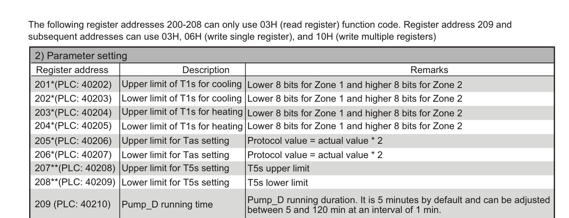

I just realised that there is another setting I need to change but this is not one I can change via modbus- temperature lower limit of T1S heating zone 1. This is preventing the outlet flow temp from dropping below 35 when running in set flow temp mode, I believe….
You might be able to, have a look at address registers 201 to 208, in particular 204 (from the wired controller manual modbus table). Try reading it first to see if there is anything there.

@cathoderay I'm not quite sure I can do that with my setup in terms of looking at the address registers? The svenar device will just provide me all of the read only and adjustable registers as entities in HA. Furthermore I cannot find temperature lower limit of T1S heating zone 1 anywhere in the serviceman settings- thus I do not believe the manufacturers intended this to be adjusted and is one of the read only ones.

I can't even find it in the manuals, apart from in the modbus table. I wonder, where did you find it, and that it should be 35°C, which seems rather high eg UFH systems will often be below this?

Posted by: @cathoderay
Registers 200 until 208 are read only according to the modbus table overview.
(@tasos)
Posts: 87
@mosibi I confirm this and the value in my machine (R290) is 35. But this is for radiators, If you tell it you use UFH, it will get lower. In fact it would be 25. As it turns out, zone 2 uses UFH in my setup, and this limit is in the higher 8 bits of the same register (even though I don't actually have a zone 2).

Posted by: @mosibi
I think it might be writable (horrid word). In my version of the modbus table, it is in section 2, Parameter Setting, as opposed to section 1, Running Parameters.
(@mosibi)
Eminent Member Member
Posts: 30
Registers in the 200 range are indeed in the “Parameter Setting” part, and that is also what has make me doubt, but a few of the different modbus register overviews (I collected multiple from different Midea heat pump types and clones) have a statement about the registers we are talking about.
IMG 1209
That and a strong wish to not break mine or others heat pump, made it that I implemented it read only. But if somebody is willing to play with it and has successfully updated the values, I am very happy to also implement it
