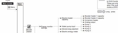

Can anyone tell me how to get into the menu item: Service> Energy Monitor settings> Water Pump input> Pump 1-4 ?
I can get past the 0000 password, but if I tick at Energy Monitor settings, it only offers: System Shut Down> Yes/no
Similar at Auxiliary settings, but others e.g. Pump speed; Commissioning wizard will open and Running information will open with additional password 540
Is it possible that some items are only available with the entire system shut down?

@skyecraig Many thanks. Could you please describe where we are after carrying out any mods and what is necessary to restart?
