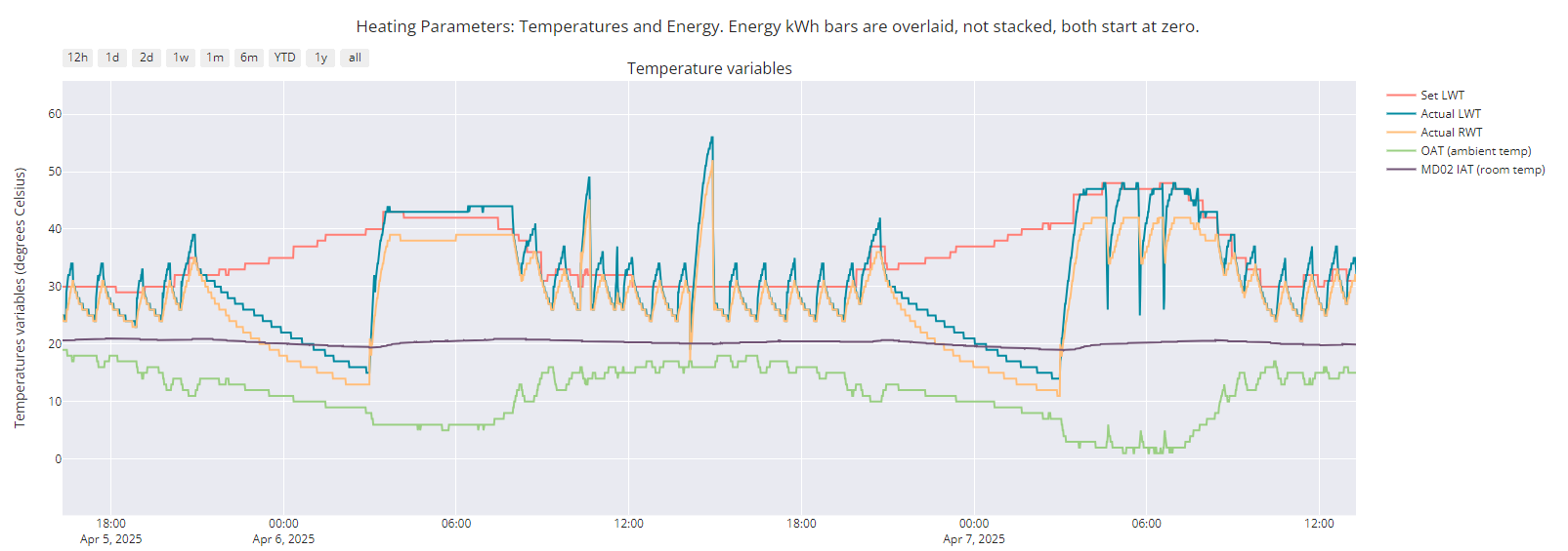

Is this (setting the LWT, where the lower limit is 35 degrees) on the home/main page? If so, this has sort of come up before and I think it may be important. On my R32 unit, if I have set the weather curve end points inside the FOR SERVICEMAN menu to say 30 @ 15 for the right hand end (higher OAT end) and then put the unit on WC using curve 9, then two relevant things happen:
(1) when the OAT is 15°C and above, the set LWT will go down to 30°C, and the actual LWT will cycle, but the average will be about 30°C, see this chart which also has just about everything else as well including steady state and defrost running plus overnight setbacks):
(2) I cannot set the LWT on the wired controller home/main page. If I attempt to do so, I get the 'Weather temp. set function is on. Do you want to turn it off? message, 'weather temp. set function' being Midea-speak for weather compensation. In other words, it will only run in weather compensation mode. I cannot separately influence the set LWT. To do that, I have to turn weather compensation off.

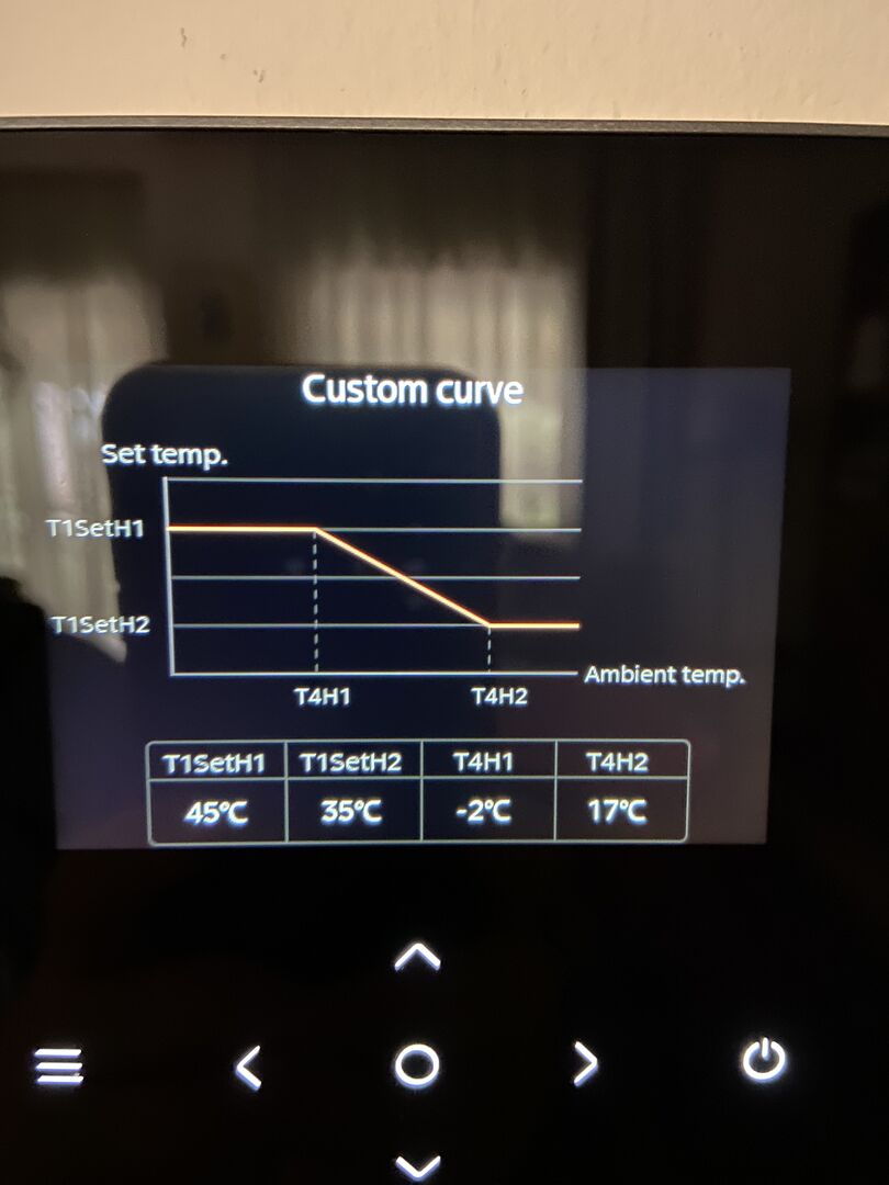

But on R290 units, it seems you can set the set LWT even when on weather compensation (which I still think is odd), and if the unit's default lowest manually set LWT is 35 degrees, then that over-rides the weather compensation setting?
Indeed I can set the end points of our wc 9 curve from the main menu of the wired controller. I have never entered for Serviceman menu yet in our installation. The 35 degrees I was mentioning is the lowest temperature I am allowed to set at either points of the wc 9 curve (with 74 degrees being the highest), at least from the main menu. Not an arbitrary set LWT value while wc is running.
And even though I have not entered for Serviceman, I have skimmed through various midea R290 manuals and have not found a relevant entry in the Serviceman menu (i.e. defining wc parameters from Serviceman menu). But I may well be wrong on this.
Indeed the chart has just about everything, including consistency in behavior. How do you explain the increasing gap between actual LWT and set LWT in the time intervals around midnight? Is this a constant pattern?
It's the setback (2100 to 0300). The unit sets the set LWT, but (obvs) doesn't use it when it is not running. The same thing happens during the summer.
