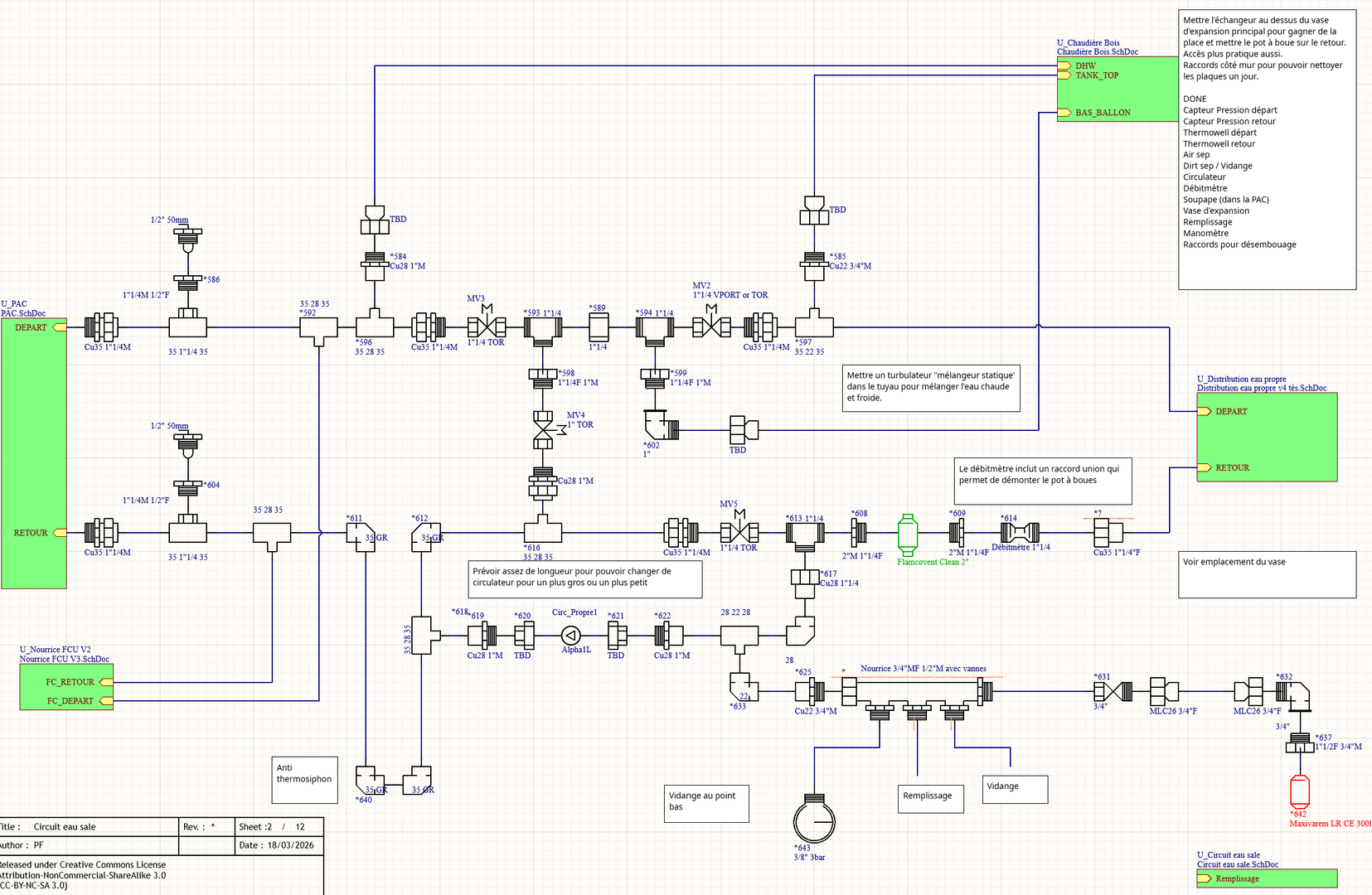

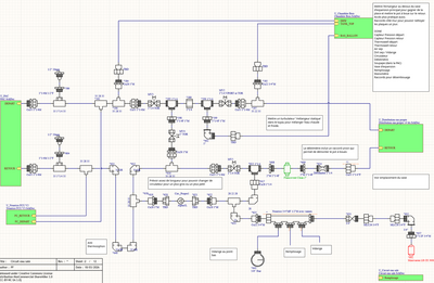

The future installation schematics are finalized and I'm ordering the parts.
I figured out, my favorite electronics/schematics/PCB software can draw a schematic and make a BOM with electronic components so... why not with plumbing? Since the house is huge, there are so many parts and fittings, this is sooooo damn convenient!
Great to read this. Your application is exactly why a heat exchanger should be used. How big is it?

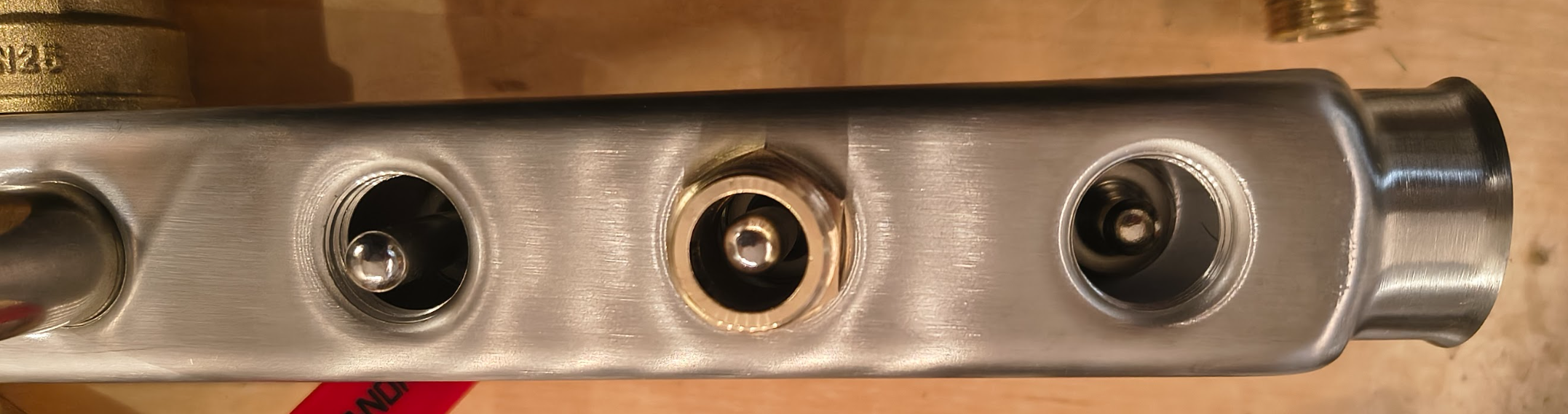

Was looking for a way to measure flow and return temperatures on manifolds.

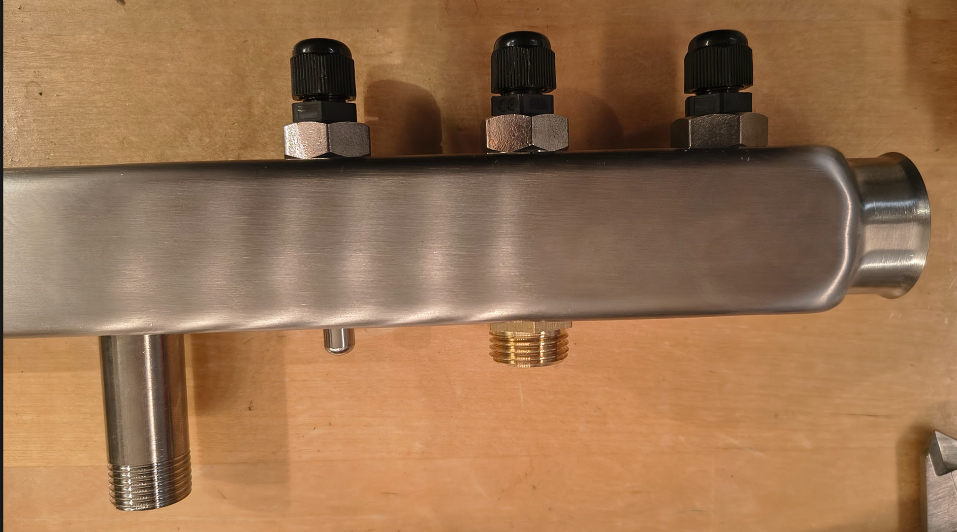

Introducing the aliexpress stainless steel underfloor heating manifold, which has 1/2" threaded holes on top and bottom, and 1" on both ends.

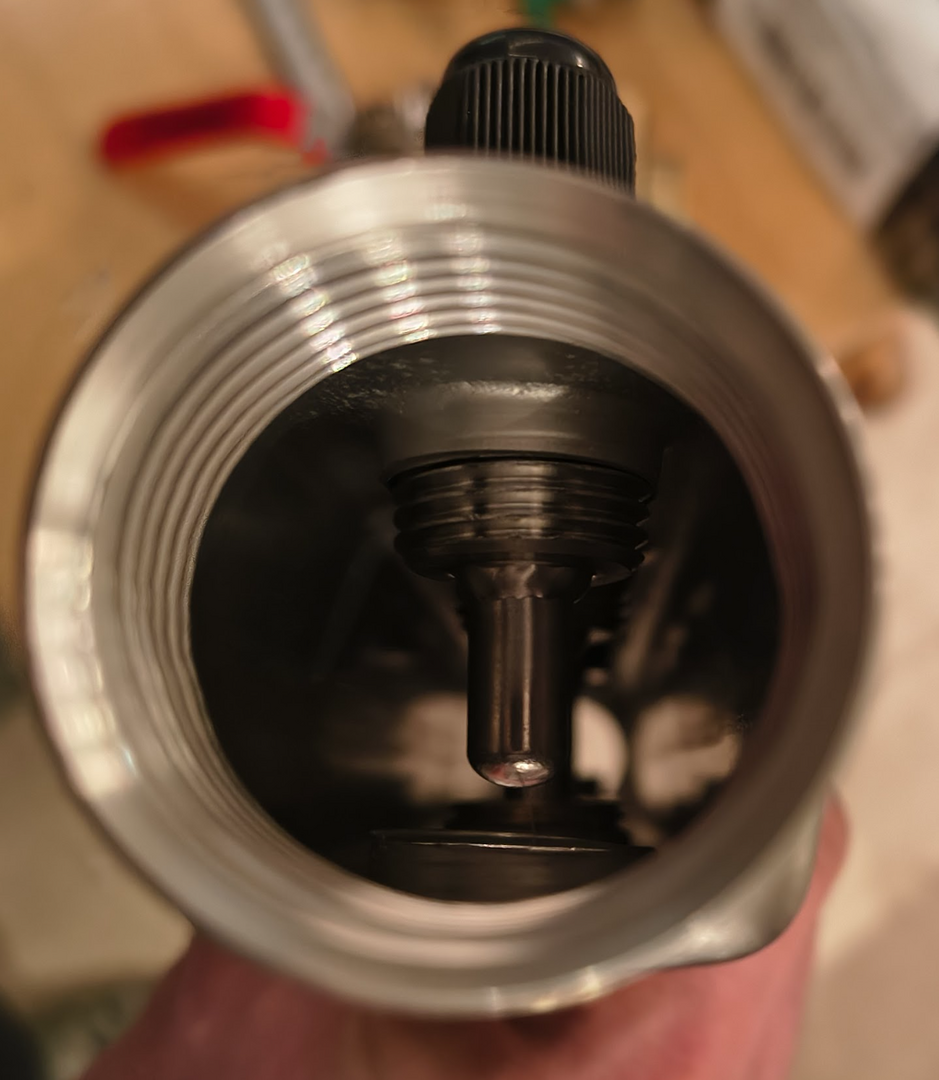

So an aliexpress 1/2" thermowell can poke all the way through into the return pipe to get the return temperature for each circuit.
Cheap, convenient, quick assembly, no hassle.
A shorter thermowell can also get the temperature in the manifold.
