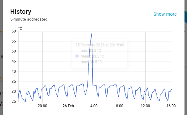

Im not sure from your description exactly what frequency of compressor starts you are seeing. Here is a plot of mine at present, a bit less than one start per hour. Mine is definitely 'good' as judged by the compressor starts vs running time over a whole season. Anything less than 6 starts per hour is sometimes considered 'acceptable', although if it is as much as 6 it suggests a well oversized heat pump and/or that increasing system volume might be a good idea.
