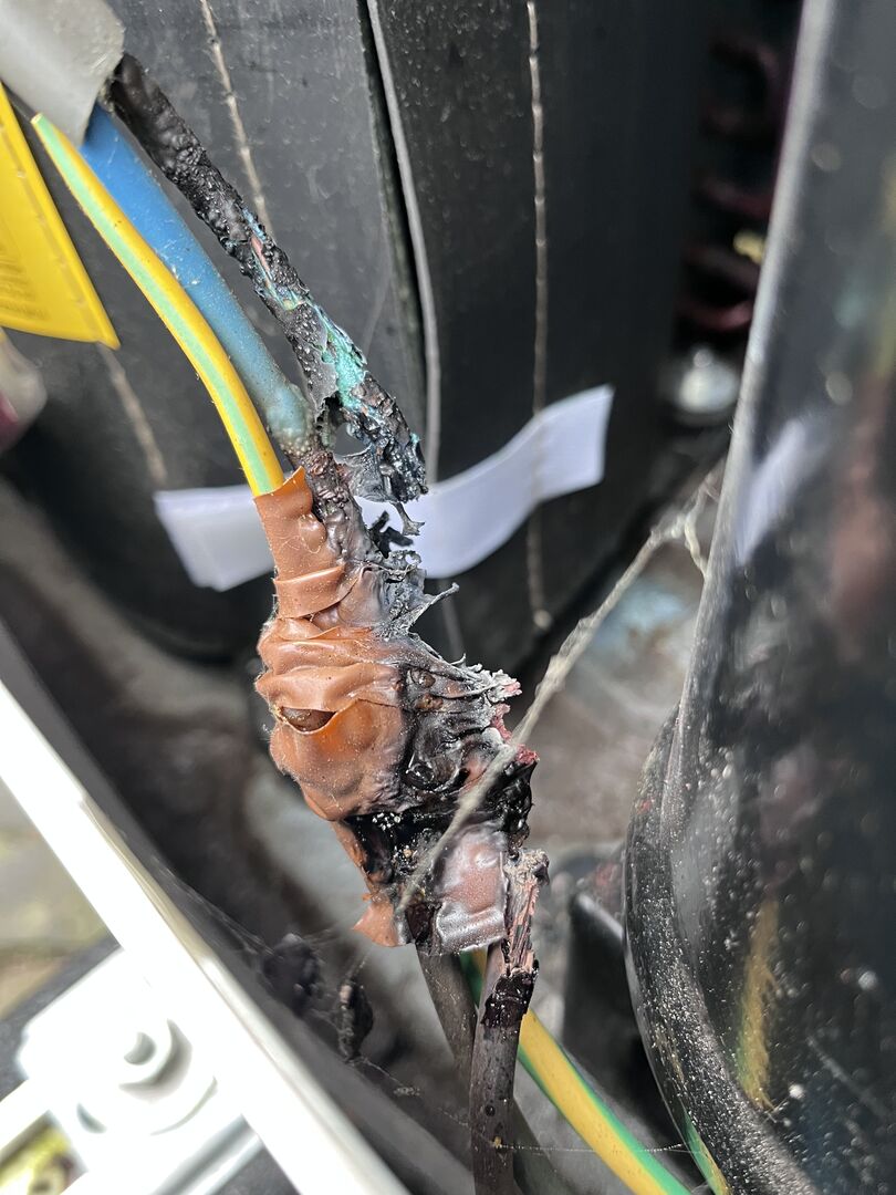

I think the annual ASHP service is a massive con, having paid £300 for one that didn't amount to much more than opening the casing and washing the outside. The technician missed a really bad wiring connection on the power supply right at the front of the unit that literally melted the wiring
a few months later.
So I am self insuring from now on. If something goes wrong I'll get it fixed at the time.
