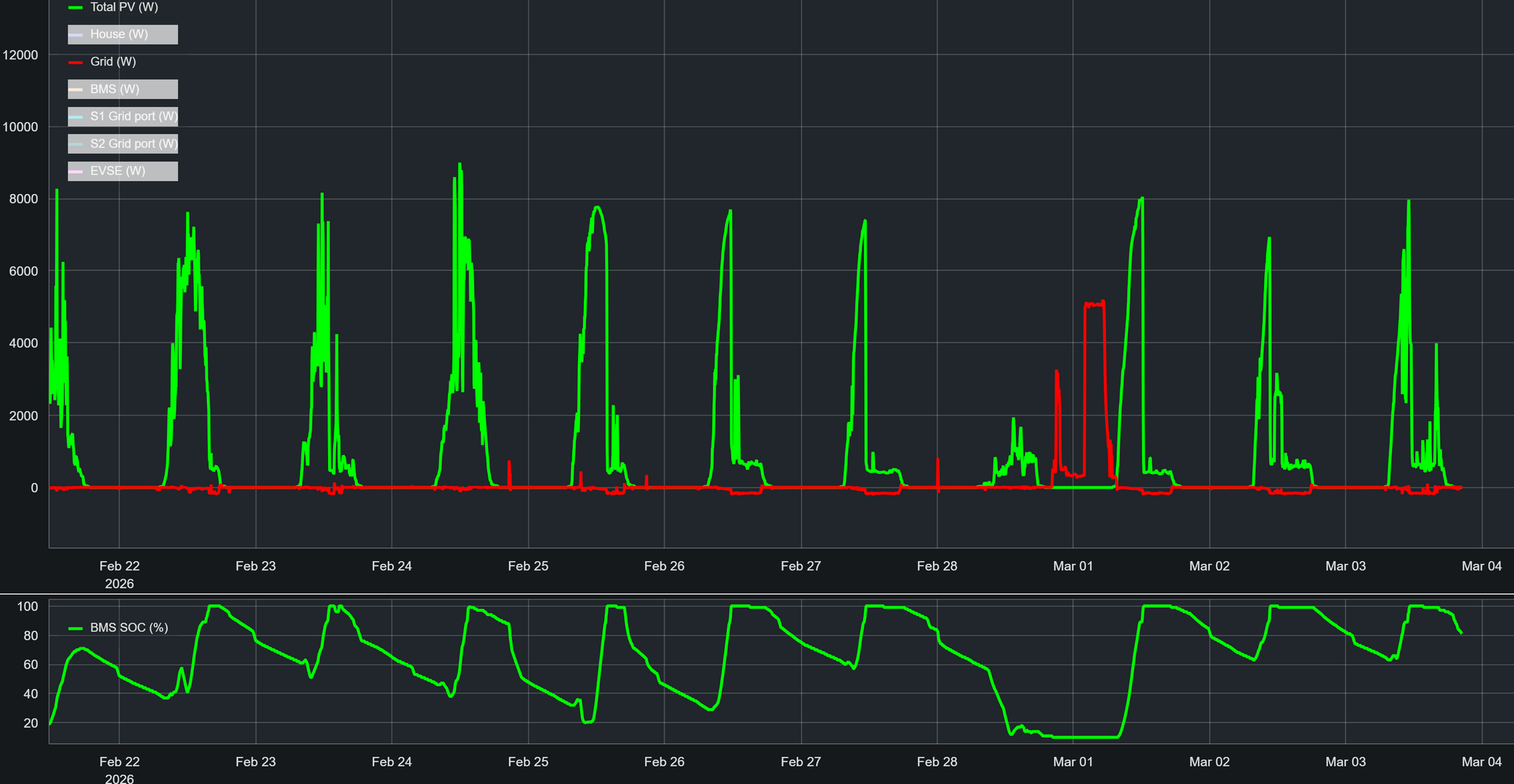

12kWp on the roof, 2x Solis S5 6kW hybrids, 20kWh Pylontech
So far pretty good

@bobflux
Prey what are the SOC% limits you have set for your battery?

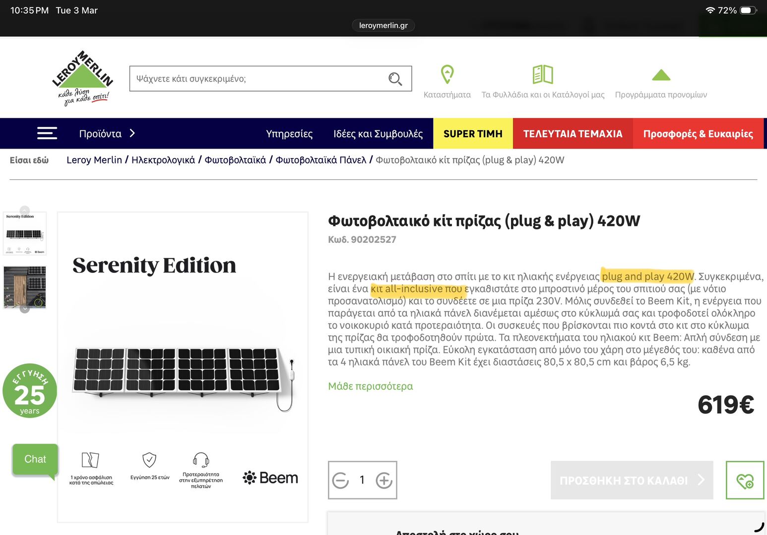

Posted by: @batpred
I meant plug-in like just to connect to a socket.
We do not have Leroy here, but B&Q seems to have tried a similar approach.
I see that in France, there are plenty of items Leroy sell as DIY.
Here is an example of local Leroy offerings (in exotic greek...)
IMG 3330
