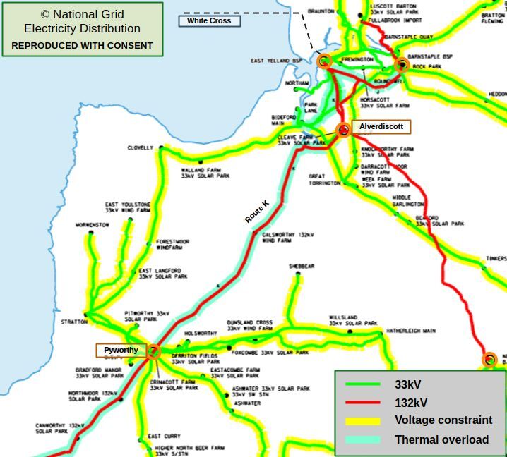

We have been notified by the electricity Distribution Network Operator that they are constraining Derril Water Solar Park and other generators in North Devon to prevent potential network overloads. The problem has been triggered by works being carried out at the Transmission Network sub-station at Alverdiscott near Barnstaple. The constraint is unexpected and has been enforced on our solar park and other generators in North Devon with no warning.
Well, not entirely with no warning.
The over-supply of electricity in the area was known well before Derrill Water applied for planning permission from Torridge District Council.
Here's a section of NGED's EHV Constraints Map; they are the DNO for SW England.
AlverdiscottConstraints
It shows only the two higher-voltage levels of the Distribution Grid, and those generation sites which connect directly to them.
I've placed orange circles around the Bulk Supply Points, where the transformers interface between 132kV and 33kV, and I've labelled both Alverdiscott and Pyworthy BSPs
The Alverdiscott site is also a Grid Supply Point (GSP) which connects to the 400kV Transmission Grid.
Derril Water connects to the grid at 33kV. It's very close to Pyworthy BSP, which takes its output.
Route K is probably the most seriously affected by excess generation in the region.
Potential shareholders in Derril Water Solar Farm should've been made aware of the constraints in the area when they invested.
All solar and wind generation in Devon and Cornwall is curtailed by NGED to prevent damage to cables and transformers from over-voltage and breakdown of insulation. Thus Derril Water isn't permitted to export the theoretical maximum power which it could generate.
In this case it seems that an unexpected fault has affected the GSP side of the Alverdiscott site.

I've heard from others living in the vicinity of Derrill Water solar farm, near Holsworthy in NW Devon..
The indications are that there is a delay in ongoing work to increase capacity at Alverdiscott.
This is both a Bulk Supply Point and Grid Supply Point.
Derrill Water was meant to commence generating this month (June'26), and that has been postponed until September.
I have no evidence of any fault, nor any other generation site in the area being affected.
