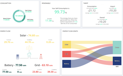

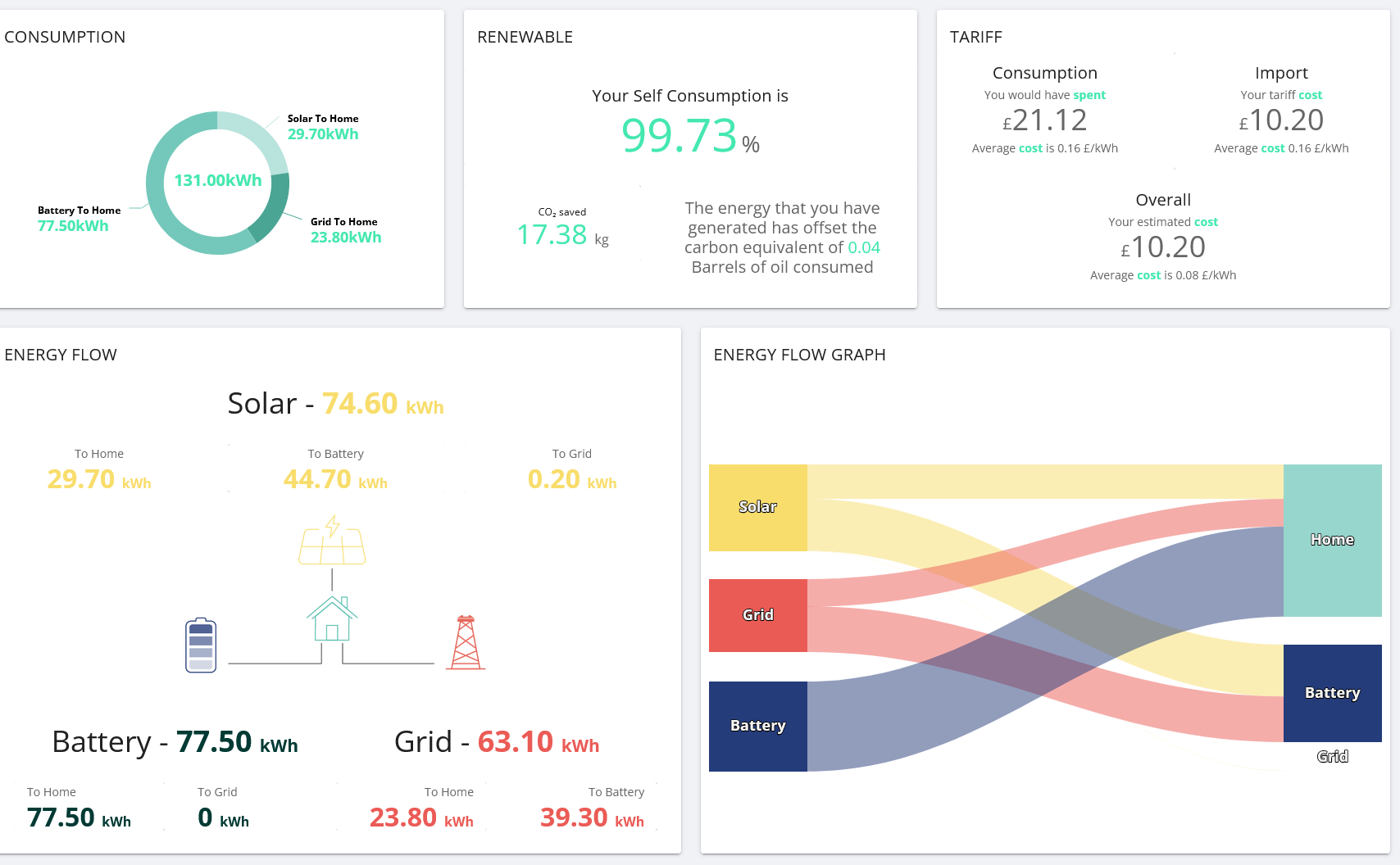

(@txmartyn)
Joined: 7 months ago
Posts: 6
Whatever you say, the amount you will be charged for power from the grid will normally be much greater than the amount that you will get paid for exporting to the grid.
Ideally you want to use all the power generated by your solar installation to offset any grid import, but to do that you really need a battery installation as well.
Attached is a screenshot showing my solar generation, grid import & battery use from last week.
You can see that by using the battery I utilised over 99% of the power generated by my solar panels and, as a result, my power cost for the week was half of what it could have been.
Screenshot 2026 05 30 at 10 55 22 givenergy.cloud
