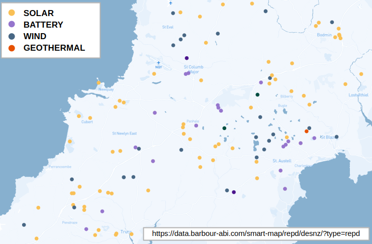

Traditionally reactive power was supplied to the grid by the way in which electricity was generated using rotating turbines.
But when you scatter solar-farms and wind-farms across a large area then the electricity is being supplied by inverters, which use electronics. There's no rotating turbines and the magnetic flux which would be present in their coils of copper wire.
That's the situation in Devon and Cornwall, as you can see from the dots on this Barbour map of central Cornwall:
