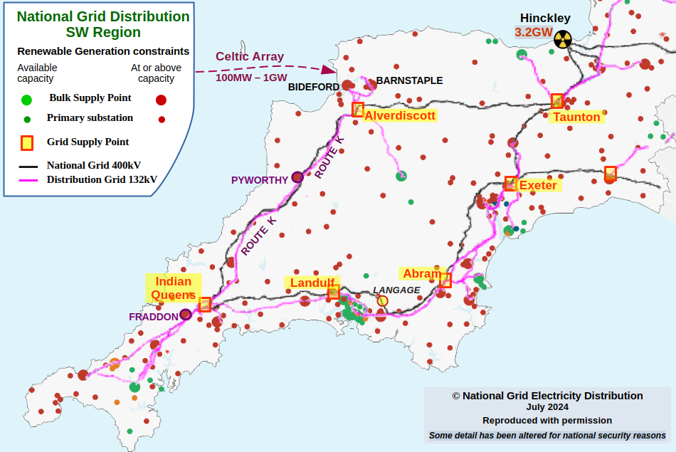

Readers here please note that Derril Water and many other renewable-energy generation sites in Devon and Cornwall are still not feeding into the grid.

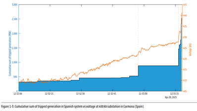

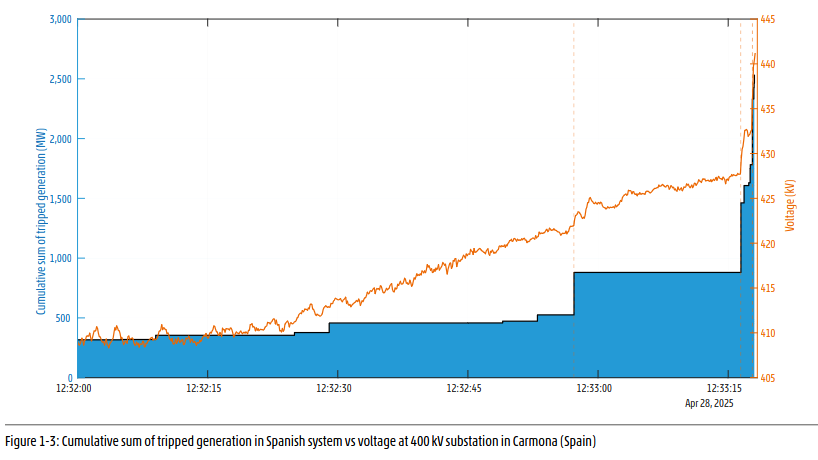

I am in contact with NESO to clarify what is the origin of the problem. It is related to a lack of Reactive Power Support in the West Country whilst the CCGT plant at Langage (Plymouth) is offline for scheduled maintenance. NESO use reactive power within the mechanism for voltage-control.
When grid voltage levels rise above the statutory levels, generation sites using inverters will switch off to comply with G98/99 regulations. That creates an excess of demand over supply, resulting in grid frequency falling.
That's what occurred in Spain on 28th April 2025, as can be seen in this combined chart from the ENTSO-e Incident Report, section 1.3
Most solar and wind generation in Devon and Cornwall connects via Route-K between Indian Queens and Alverdiscott. Derril Water is at the Pyworthy Bulk Supply Point, midway between those two Grid Supply Points.
There is to be a public meeting to inform residents about How the Grid Works, and BESS technology on Thursday 24th Sept, hosted by the Campaign for the Protection of Rural England (CPRE). It's at the Community Hall, Alverdiscott.
I will be delivering the (highly illustrated) presentation on grid functionality... in case you live in the vicinity and you'd like to see just how Transparent I am. But with a seating capacity of 90 for the venue, it might be standing room only.
