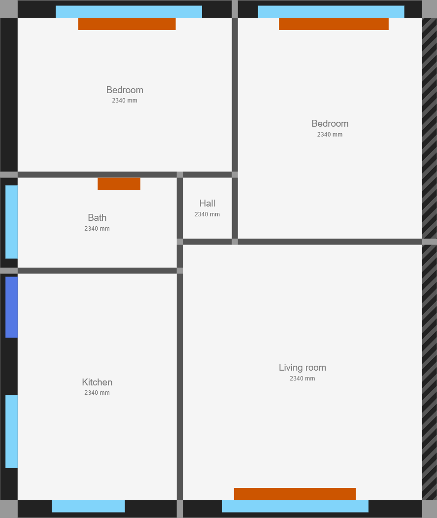

I'm wondering if I need to do any pipe upgrades. My heat loss is about 4kW at -1.9c. I live in York so that should be fine for a 5kW heat pump. The pipes going out and into the boiler are 22mm and the pipes going into the radiators are 15mm. The house was built in about 1965. The main query I have is if multiple radiators share a 15mm pipe or if they all individually branch off the 22mm pipe. Is there any way to figure this out short of pulling up some floor boards? In case it's handy I've attached a floor plan of the bungalow. The boiler is in the kitchen and the radiators are the orange rectangles. Any ideas on what the pipes probably are would be appreciated!
floor plan

If your heat loss is only 4kW and the pipes leaving the boiler are 22mm then its fairly unlikely you need any upgrades; 15mm is good for 3kW at 1m/s flow rate.  If you have access to a thermal imaging camera then you could trace the route of the pipework from which you could make a fair guess when it downsizes, alternatively suck it and see, if the flow speed has to be raised to 1.5m/s its not a complete no-no.  Unfortunately the only absolutely certain way I know is to try it or take up the floorboards.

@falesh having a house of similar age the two issues I faced that were hidden, were 1. Leaking pipes and 2. Mine was a one pipe system, ie no separate return pipe. I had mine completely re piped, for peace of mind.

@falesh
Hi Falesh,
If I were designing your system then firstly given your location my design outdoor temperature would be more like -3/-4 to achieve 21 degrees throughout your property. Given that you are a 1965 bungalow I would be cautious of your walls, unless you know for sure what the cavities are filled with (if anything).
With the above in mind your projected heat loss may not be unreasonable, but best to be sure first before going any further with sizing.
Often bungalows are piped from the loft, are you sure yours is not? With regard to potential leaks, if you currently have a sealed system (combi boiler) then you would know, as your pressure would constantly need to be topped up. If you have a tank fed system currently, and pipes buried in concrete floors then that could potentially be a problem. Given that you mentioned lifting up floorboards, I am guessing that you do not have pipes buried in concrete.
In short there is no 'easy' way to find out pipework size without further investigation, but having 15mm pipes going to all radiators and 22mm leaving the boiler is a good sign so far.
From your floor plan it would likely be necessary to add a radiator to your kitchen in order to ensure MCS compliance, meaning that some work would be required to the pipework to add this additional radiator, and an installer should check pipe sizing (and make appropriate upgrades) as they are doing the installation.
It is only the main 'skeleton' of pipework that needs to be verified, meaning that you have the central part in a larger diameter, splitting down to smaller diameters to pick up radiators as it gets further away. I would deem your property low risk and it would likely need minimal alteration in order to get a well performing system.
