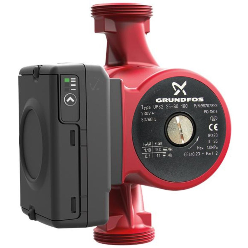

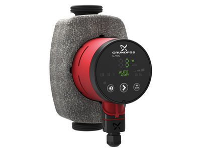

Octopus replaced my old pump :
With a smaller one like this:
They even put in some kind of rubber bracket to reduce the vibration.
I thought it made a difference, but maybe it was a placebo effect, cos it's now noisy again.
I am at a loss, I don't know where to look for the source of the noise.

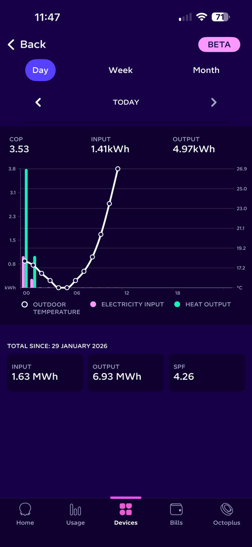

@andrewj depends on your starting temperature, when they moved my sensor to the bottom of the tank it shows  low temperature, yet the water from the tap is actually hot!
This is this morning's graph i’m set to 50 degree. Going to be at least an hour in winter although start temp is a factor. I don’t know what the water temp was last night but dish washer had just run, i had a shower.
I also heat water overnight so length doesn’t bother me,  i do sometimes turn it on fir an hour when grand daughter wants a bath and everyone has showered but its never longer than an hour boost.
