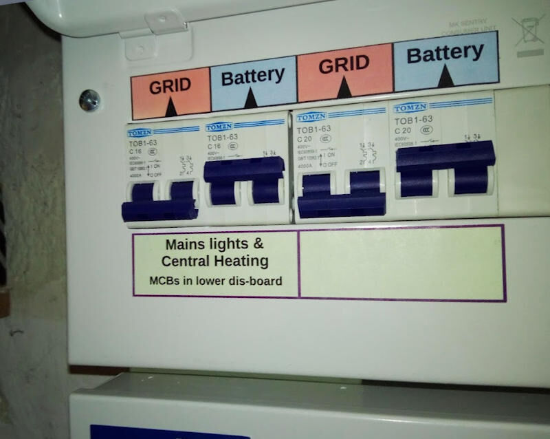

My ideal install would have my battery installed before the CU and have my cu wired to the back up socket.
There are electricians who would be prepared to implement such a strategy...
... but not if the Loads could exceed the 400w available.
AC changeoverMCB
Is it not 3KW?
