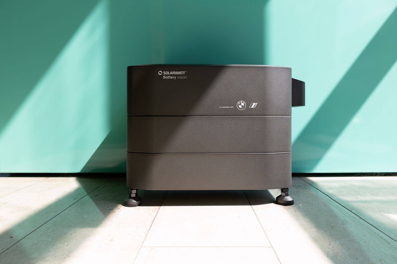

@trebor12345, the Solarwatt product has the same functionality as the Powerwall, and their gateway is coming out later this year that will allow you to island during power outages. It's a good looking piece of equipment too, with a modular system. I'll be covering it in more detail later this summer.
The Indevolt allows for islanding, but it's not as "robust" as the Powerwall or the Solarwatt.
