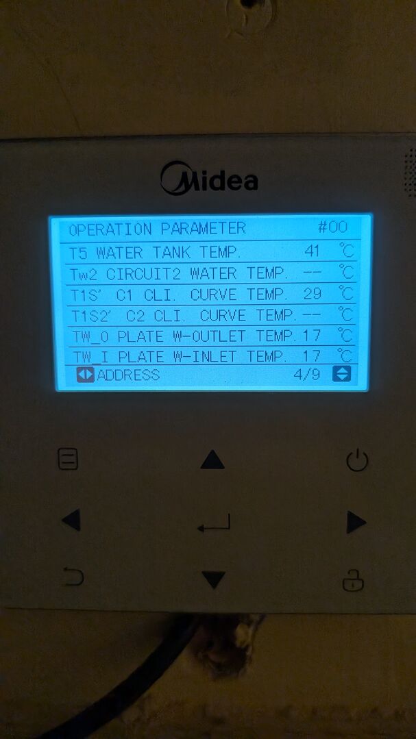

25 degrees does feel cool/cold, remember blood temp is ~37 degrees. I think you may find your compressor is doing very long cycling to keep the output down. Can you read the leaving water temp from the Midea controller, it is on page 4 of the Operational Parameters (not page 3) as TW_O PLATE W-OUTLET TEMP (just to confuse us)? It should average at about 25 degrees. You could also keep and eye on total lifetime kWh use when the DHW is not on, and see if it increases. The compressor data on page 6 may also tell you something.

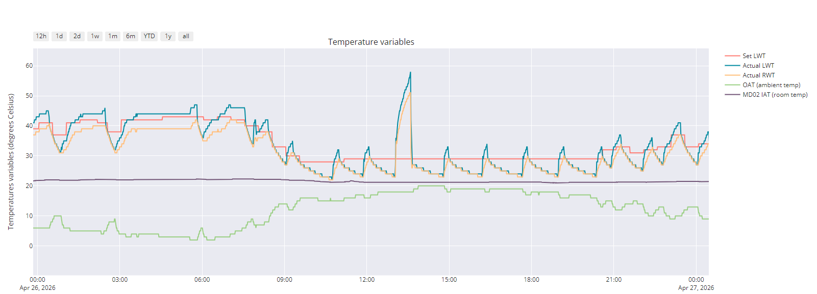

This is my heat pump on Sunday, before I turned the space heating off on Monday morning (yesterday morning). Note that during the middle of the day, when the OAT was above my right hand weather curve OAT set point of 15°, it is still running, with long cycling. The big spike at 1300 is my DHW heating.

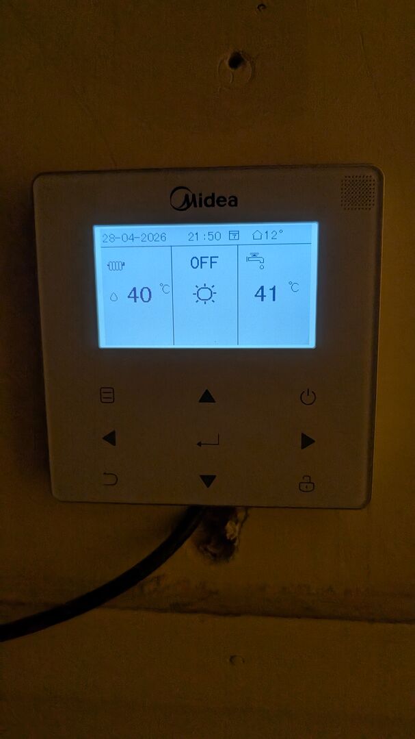

@cathoderay I turned the room stat down to 12 degrees earlier this evening which, predictably, turned off the space heating.
Here's my controller now (I should correct my previous post with my current WCC parameters which are 45 flow temp at -4 OAT / 25 flow temp at 15 OAT):
PXL 20260428 205040881
PXL 20260428 205016054
This post was modified 7 months ago 2 times by Painter26
cathodeRay
(@cathoderay)
Posts: 3164
Your energy: 11 kWh
@painter26 — that all makes sense. Space heating (the sun symbol in the middle panel) shows as off, and the leaving and returning water temperatures are the same, and low, at 17°C. Your space heating is off.
