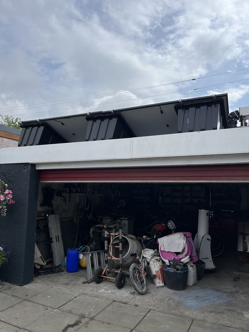

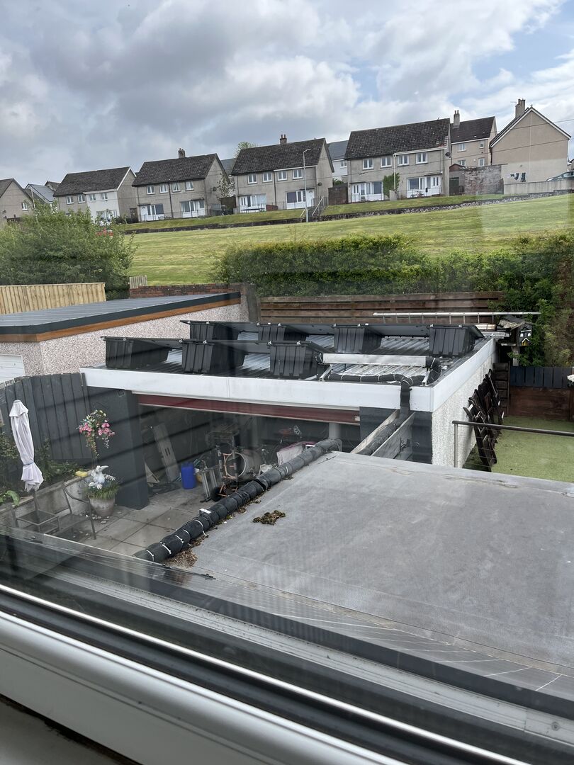

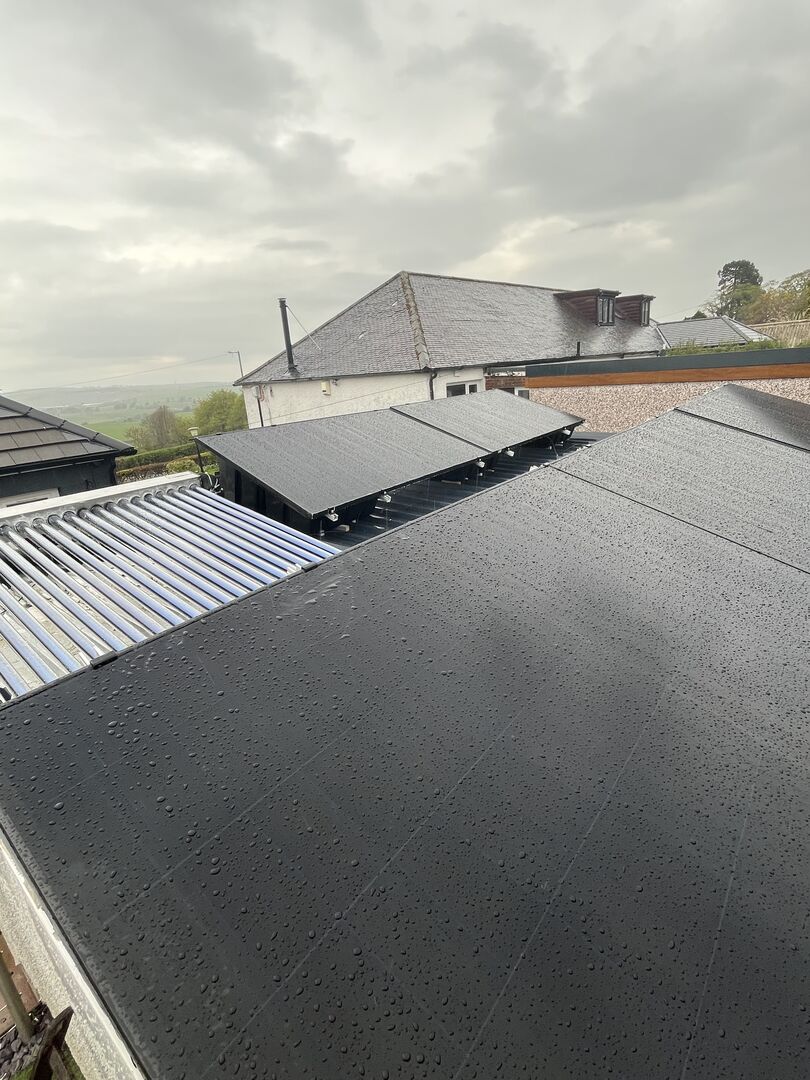

That’s the solar up and running, I don’t think it’s the most attractive addition to my property but very practical.  It’s all bolted down and the tubs also filled with broken up pavers so I hope they don’t go flying in a storm.  At the minute the 6 on my house at 2.4 max and the 5x510 panels are producing 4kwh. A bit overcast today but I’m pleased at that.

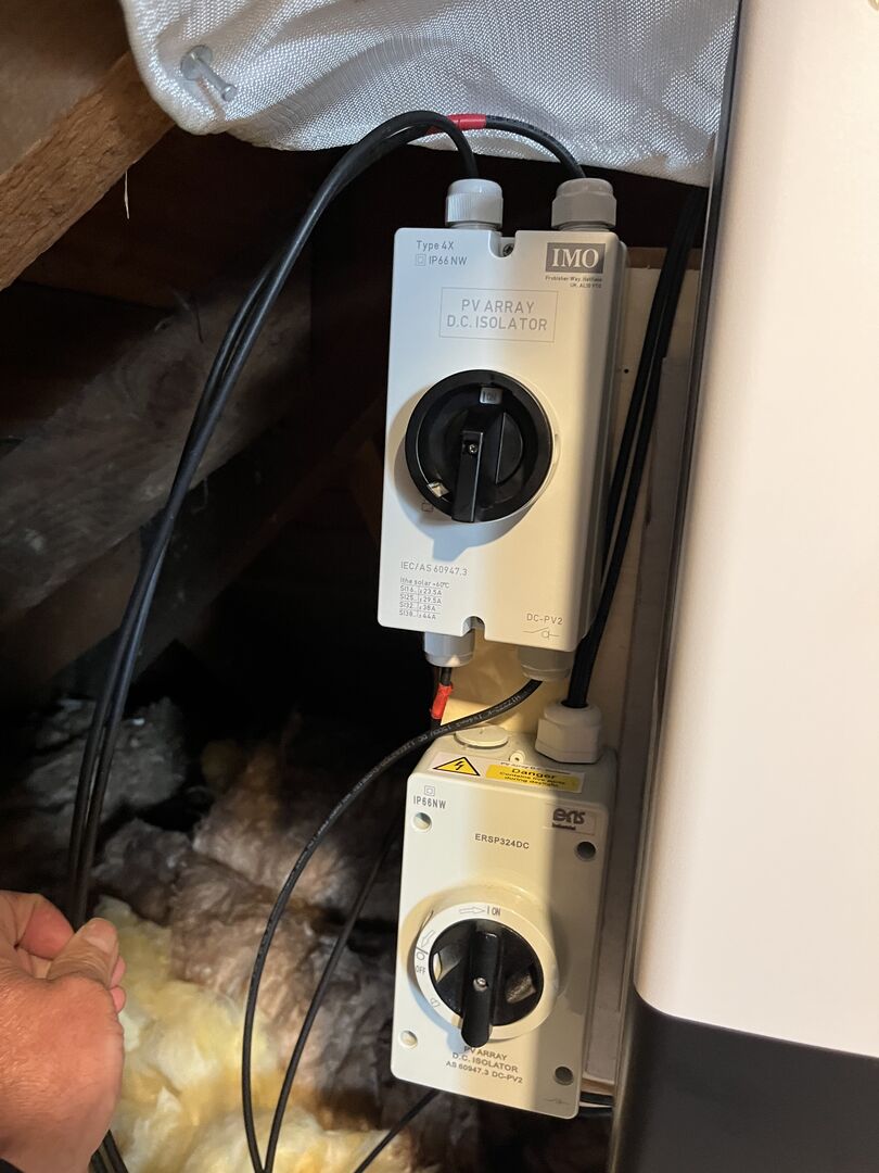

I have just installed another string and now doubled my solar to 4.9 from the registered original 2.6.  Currently output is around 4kwh, do I need to inform the DNO, will they know and will I be in trouble for not informing them.

@jamespa same inverter, just added another string to the spare input.  I read somewhere that a max of 3.6 output was the max allowed in a domestic and I am sending out 4 on a good day. It’s hardly likely to cause an overload though and it’s only producing that on a good day.  Oversized to provide a decent output, most of the time it never got near the 2.6 of the previous panels.

@jamespa my total dc voltage is 490 and the inverter max is 550.  I’m getting confused regarding outputs but it looks like I’m within the working loads. As you say my inverter won’t go beyond that 3680 kw.  Bit confusing the dc max and kw max of panels, but I think I understand now.
