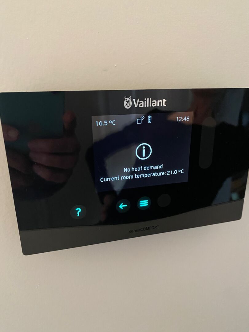

I think the mystery is in the first question;
the sensocomfort is insisting that there is "no heat demand" and the heat pump is therefore not responding; there are in effect 4 zones; and 4 thermostats; the sensocomfort has replaced the upstairs thermostat.
We haven't set time schedules, as it's fairly mild at the moment, I'm assuming weather compensation has been set, as that's what I was told by the installer.

Posted by: @gutoffowcthe sensocomfort is insisting that there is "no heat demand" and the heat pump is therefore not responding; there are in effect 4 zones; and 4 thermostats; the sensocomfort has replaced the upstairs thermostat.
OK, thats progress. The sensocomfort is detecting the local temperature as 21C and, because of whatever it has been told (through the configuration that the installer dialed in) has decided that this means that there is no requirement to heat. Potentially not an unreasonable conclusion, most people want to stop heating at 21. Don't forget that it only knows what it knows and can only react as it has been told to react. It doesn't, and cant, know what you intend to happen, only what the installer told it (and the other control elements) to do.
Which brings us back to the central question. How did the installer intend all the separate control elements to work together? This then triggers a secondary question - has he put in the right parameters/connected them up so that they do in fact work the way he intended.
This really is your installers' responsibility to draw a diagram and explain how the control elements are supposed to co-exist. Prima facie you have too many bosses, and thus its predictable that the wrong thing will happen if not carefully configured. Vaillant cant be expected to support this because its not their (control) system, its the installers control system comprising two sensocomforts and several thermostats connected together in unknown ways.
Its difficult to comment further without more detail of both the house and the control system. Its also difficult without that information to judge whether your installer knew what he was doing but didn't explain it adequately, or just hadn't got a scooby which unfortunately is not impossible. He may have installed a control salad not a control system, it happens, can generally be easily sorted out, but is frustrating.
