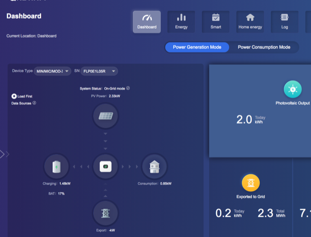

My installer set up my system on "Power Generation Mode" but how does "Power Consumption Mode" differ and how do you choose?

@majordennisbloodnok Thanks for your reply.
My Growatt inverter is Model No: MOD 4000TL3-XH and I have 2 x APX 5 batteries.
I will attach  a screenshot of the Dashboard which uses the terms I mentioned.
Screen Shot 2026 04 20 at 09.57.06

@davidalgarve, thanks for that.
Having had a quick look through the manual (
) it looks like the terminology is as I described above. Also, if you look at the left hand side of your screenshot, it says it's running in "Load First" priority. I've had a look at the Growatt portal myself and I don't seem to have the ability to choose between power generation and power consumption so I'm still guessing but given the Growatt manual doesn't make mention of these I'm a little more confident that they may be modes for how to display information on the portal and not modes for configuring your inverter. If I'm right, switching to power consumption mode may well simply repackage what the web page is telling you so the focus is where the energy is going rather than where it's coming from.

Having seen that screenshot, I think I know what "Generation Mode" and "Consumption Mode" are referring to.
It's simply two different ways of presenting the data on screen.
Those radio-buttons aren't sending any command to the inverter, or defining how it operates.

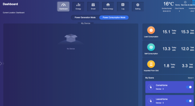

@transparent I have been a little reluctant to select "PowerConsumption Mode" without a full understanding and my installer has not responded to my question. However, I have just selected it on the Growatt Dashboard on my iMac and it reports: "No Device"

Hah!
Well I guess we're all in the realm of conjecture.
Perhaps "Consumption Mode" is a mechanism which requires input from another device, such as a Growatt Storage Battery.
