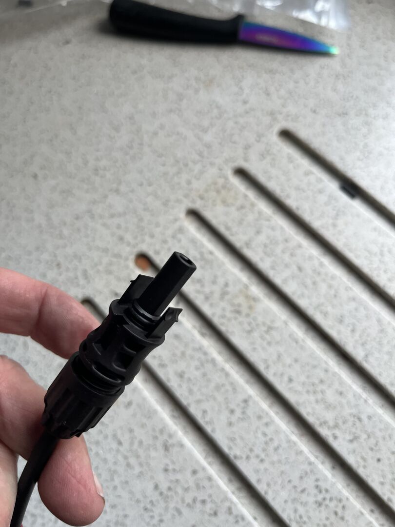

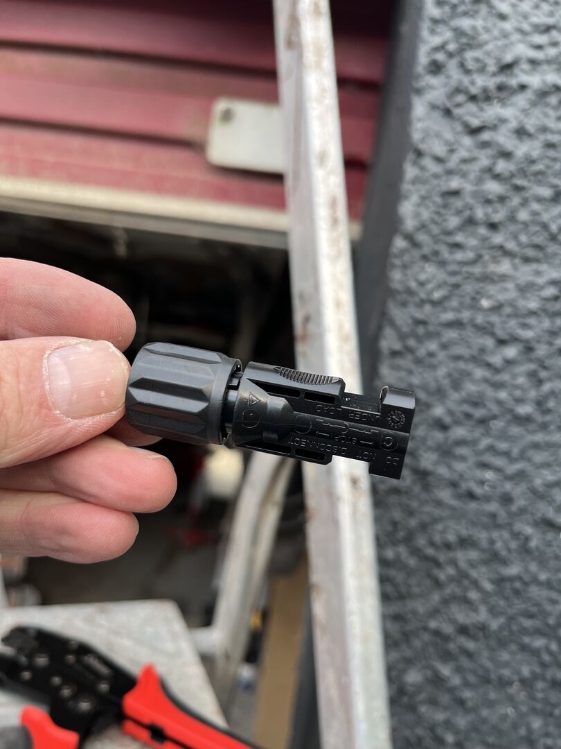

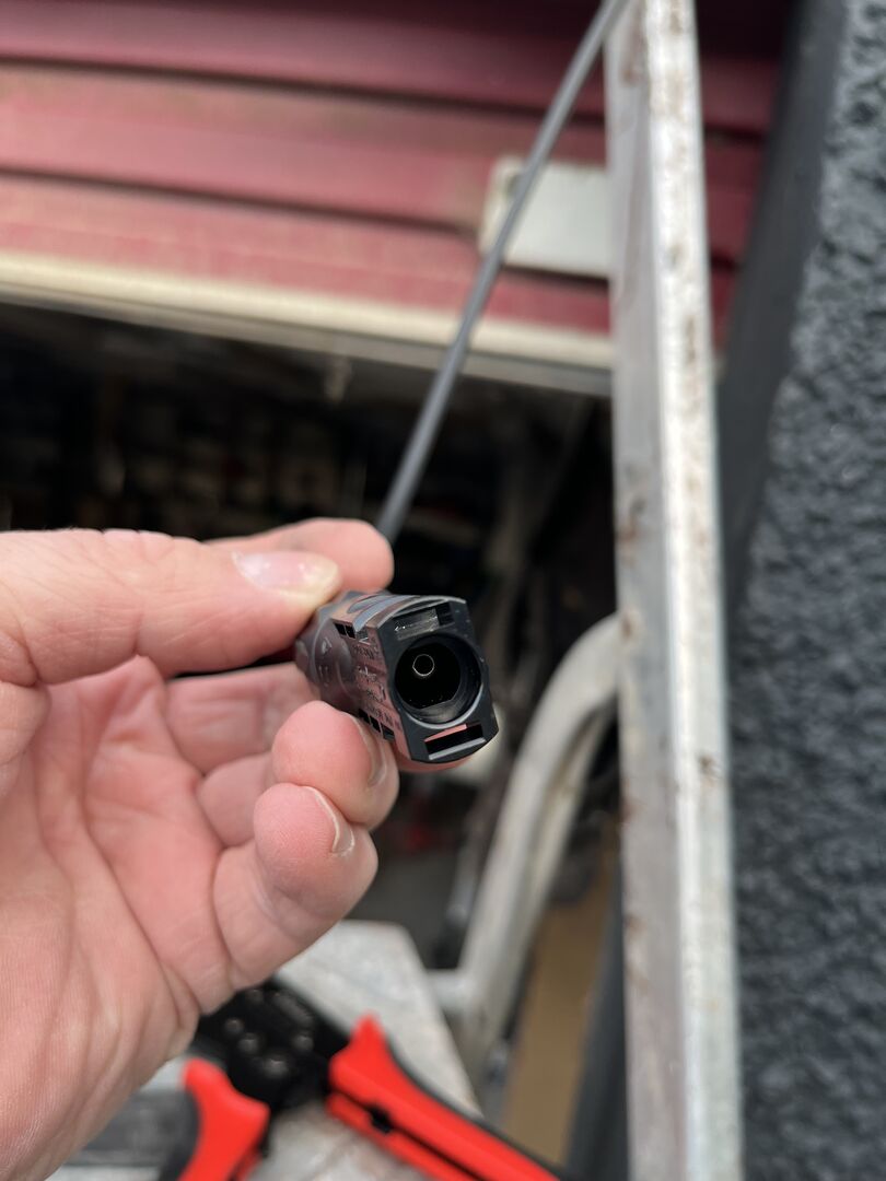

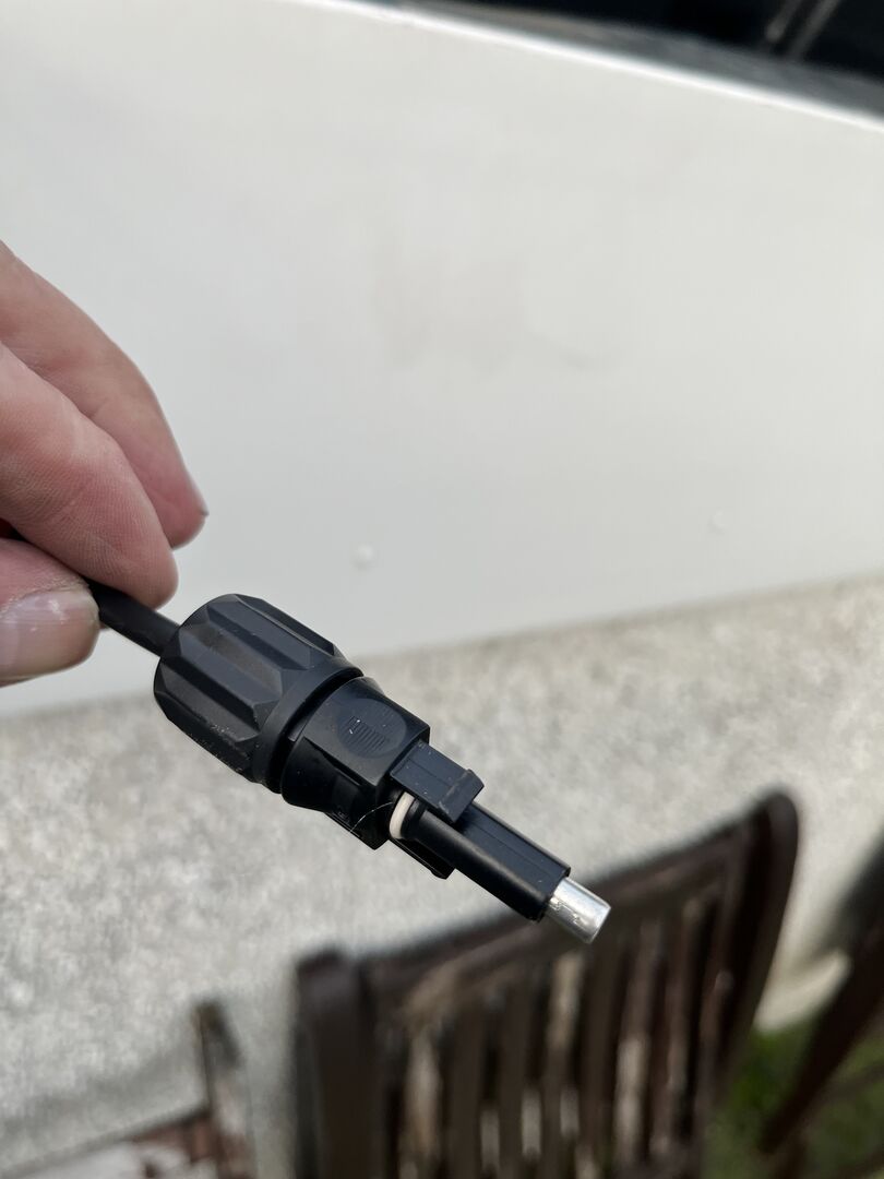

Got myself in a pickle. I have two types of plugs, but enough to change the two last ones, negative and positive on the panels.  Can anyone explain what’s going on here and if they are compatible or should I go off and get new plugs.

Well those are "MC4" plugs and sockets.
Yes the ones on the left do indeed look different to those on the right. But one's the male half and the other is female.
Incompatibility is unlikely.
You should never attempt to change the MC4 connectors which are already on the flying leads of the solar panel. They tell you which is the negative and which is the positive!
The left-most photo doesn't look right to me. When properly assembled there is no bare conductor visible on an MC4. The second photo looks correct.
What is the "pickle" you think you're in?
