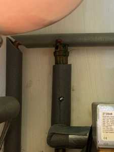

Derek,
Yes, there's been no pressure in the heating expansion vessel for some months.You can see the gauge on the red tank in the picture. The most recent engineer to visit attempted to deal with this by letting in water via the filling loop (this is downstairs in the kitchen, the cylinder in the picture is upstairs). This worked but the pressure fell away again very quickly. I was watching while he did it.
More recently we have had a leak. A pressure valve at the top of the pipe shown started leaking (see other photo). On texted instructions from the engineer who had attempted to deal with the pressure issue I screwed down the valve to stop the leak. It remains like that. The heating continues to work (but clearly not as correctly as it should) but I've been holding off calling an engineer until I'm sure I have one who can sort the problems.
The heating is underfloor upstairs and downstairs and each floor has its own manifold. There are heated bathroom towel rails which also won't heat at present as they are perpetually full of air which I can vent off for only a temporary fix.
Thanks,
Mike

Hi Mike,
Thanks for the info.
Because liquids cannot be compressed, it is necessary to have an expansion vessel in pressurised systems.
Inside the expansion vessel is a flexible membrane (probably neoprene) that separates the bottom part from the top part. The bottom part is connected to the water side of your heating system and the top part has air in it.
When you add water from the mains into your heating system, it eventually starts to fill the bottom part of the expansion vessel with water. This in turn pushes the membrane upwards, and pressurises the air above the membrane until it reaches the required pressure, at which point you would stop adding water.
So the fact that you are losing pressure would indicate that there is a leak.
The leak could be on the air side, either a pin hole in the membrane or a pin hole in the upper part of the expansion vessel, but the fact that you are getting air in your towel rails would indicate it is more likely on the water side.
The fact that you have not discovered a leak, could be as simple as the pressure relief valve is set much too low or is passing, or it could be that you have a leak within your hot water cylinder between the primary circuit and the secondary circuit.
It is not easy fault finding via messages, but lets give it a try.
Here is a link to the manual for the cylinder, download it and check that it is the same as yours.
Try the following and let me know what you find. You may need someone to assist.
1) Having checked and made a note of which pipes are hot/warm and which are cold before you start, try gradually refilling your system whilst trying to maintain the desired pressure, then see if any of the cold pipes are now warmer. If you do find a pipe that has changed temperature then try to identify where it is going.
2) Try gradually refilling your system with water up to the required pressure and then time how long it takes for the pressure to fall. Obviously look for any sign of leaks.
3) Try refilling and bleeding the towel rails at the same time. Again, time how long the pressure takes to fall.
4) Find your Pressure and Temperature Relief Valve and see if it, and the pipework around it are getting warm. when your heating system is on. This would indicate that the valve is passing and hence your are losing pressure.
5) Make some soap solution (washing up liquid and water) and using a small brush coat the solution on the expansion tank. Refill your system and check for air bubbles as the pressure decays.
Is your secondary circuit (the water that comes out of the taps) fed directly from the water mains supply, or via a cold water tank in the loft?
How long have you been losing pressure? Did you notice if it started gradually or fairly sudden?
Try the various test and let me know what you find.
