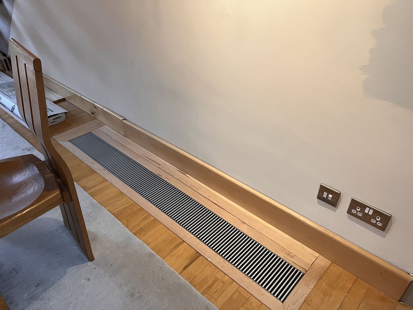

On replacing rads have a look at the Jaga Strada fan assisted units.  Not cheap but we have them everywhere and they work well and the fans allow higher output at lower flow temps than is the case with regular rads. We also have 2 of their Clima Canal trench rads which are great if you have a suspended floor and want to reclaim the wall space - like this:

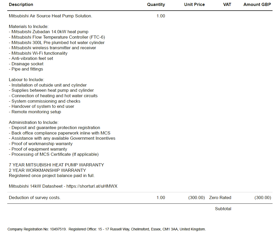

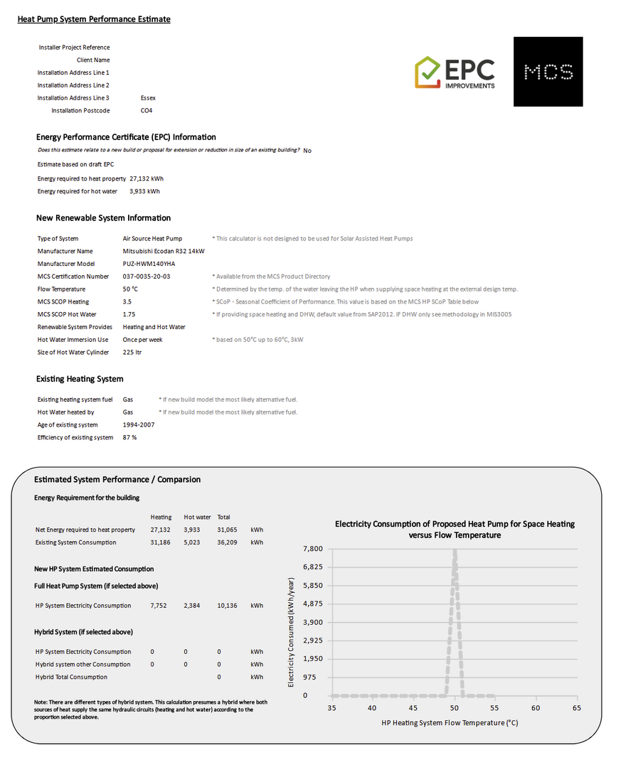

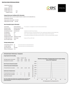

Did you check their heat-loss and radiator workings, did they use a buffer in your system? They used outdated figures on my rads, and I have a shortfall of around 34% just from the radiators alone? They also used the wrong buffer which is causing distortion and a loss of around 10c. Did they do the design or did you get involved and they followed your design and instructions? I saw in your description you have the Mitsubishi 14kW , they originally wanted to install the Mitsubishi Ecodan R32 14kW in our home, but then opted for the 12kW Samsung. Did they do your solar Installation? I originally had them engaged to do that for us too, after the heat pump, but realised they were robbing us blind, so I got pretty much double the system for the same money.
We pretty much gave them the keys and told them do whatever needs doing to get the system correct the first time around. I didn't know anything about Heat Pumps except that they would only be as good as the installers. Marc was a great sales person, and it is ironic I ended going back to the Heat Geek Elite from Ipswich for remedial assessment, which at the time I thought was too expensive but now wish I selected and had them do the installation (heat-loss cost was £600 VS £300 from EPC back in 2023). Happy to name them, Ali from Smart Heating Solutions. Going forward they will be doing my yearly service.
EPC Improvements subcontracted the heat loss to a company called Regenertec Consulting. If I knew they were using subcontractors for the everything, I honestly would have not engaged with them as I wanted someone that understood what they were doing. It explains my situations and why the managers had no clue how heat pumps operate or how they are supposed to be installed, because the owners are not heat engineers or have any experience or knowledge and rely on 3rd parties. I looked up the owners recently and they had and still have all kind of other business, none related to another, no transferable skills or knowledge. They clearly saw an opportunity with the ECO4 grants and jumped on it. Some people are passionate about their work and what they do, for some it's just a side hustle along many others.
I guess this is one of the question you need to ask installers, "Do you subcontract any of the work?". I cannot recall 100%, unless it is in one of the e-mails, but I swear I asked them if they subcontracted, and was told they do not. Anyhow, Heat Geek removed them from their network if that means anything.
Let us know how it goes with them if you have any problems. That's where my issues started, didn't understand the industry, 0 aftercare and lack of support.

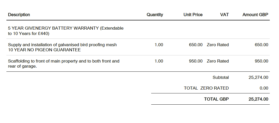

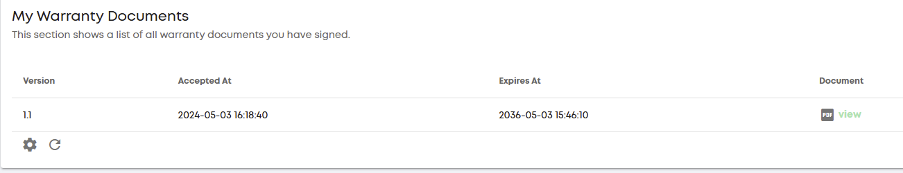

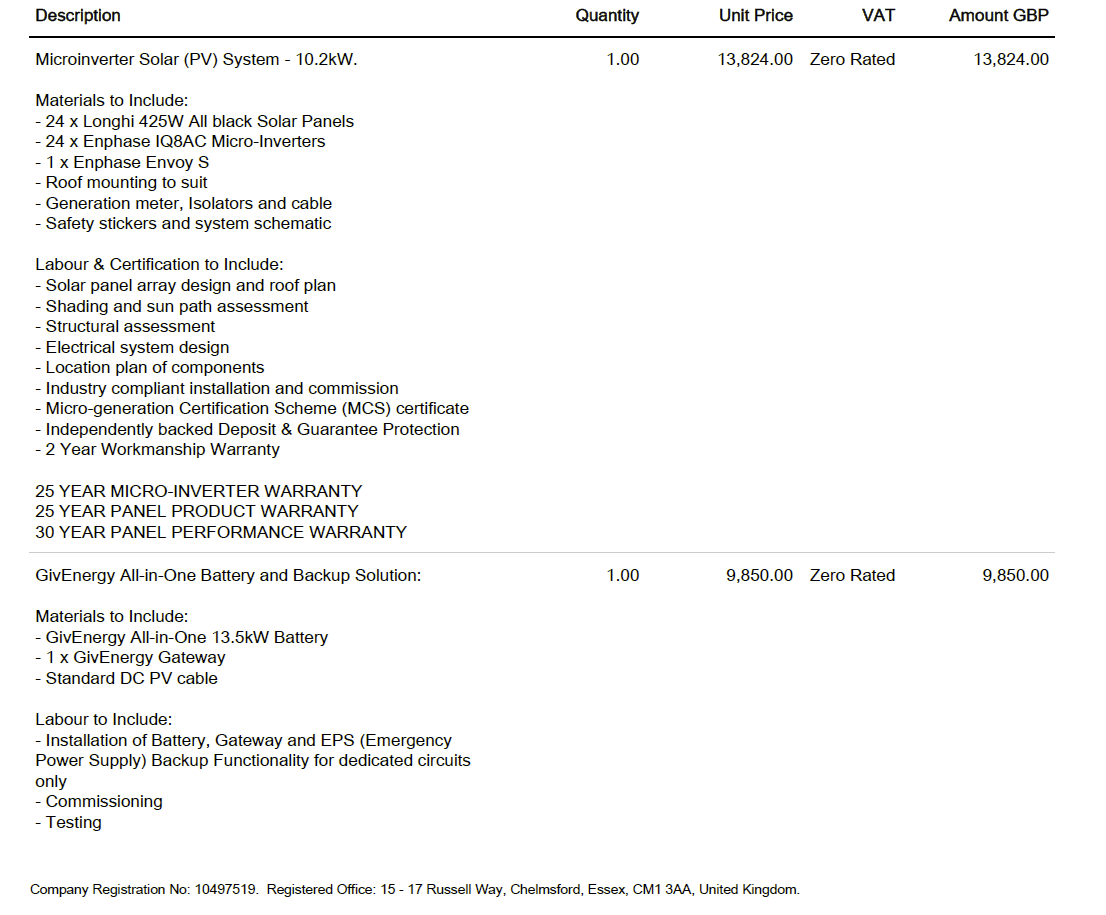

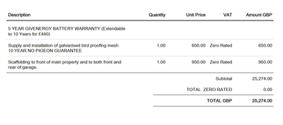

Here is the Solar Quote from EPC Improvements which I went ahead with, but pulled the plug on due to unresolved Heat Pump issues:
I should probably mention that the installers that did my system, somehow provided 12 years GivEnergy warranty as standard, without having to pay the additional £440 EPC Improvements wanted for 10 years extended warranty.
