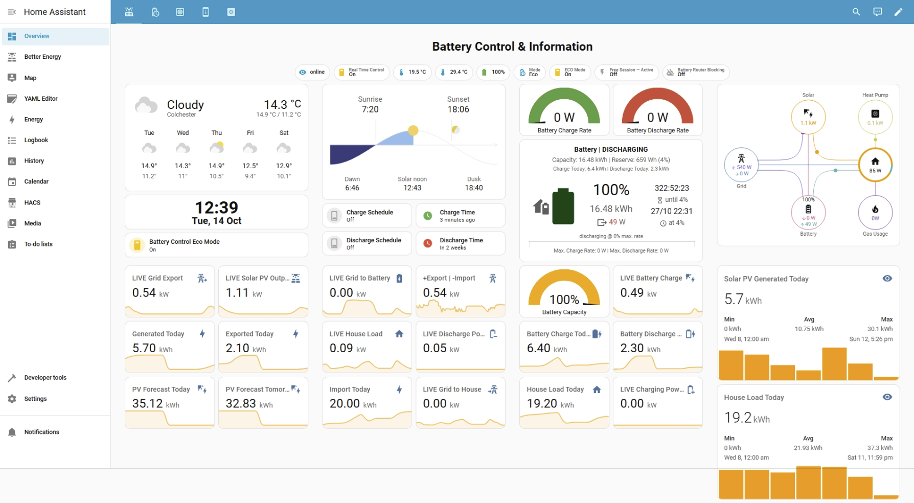

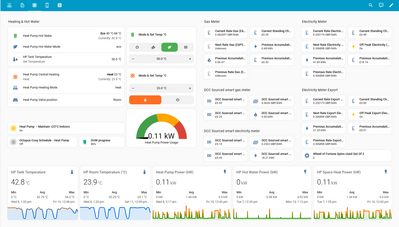

This is my current set-up, with some experimental things running in other views:

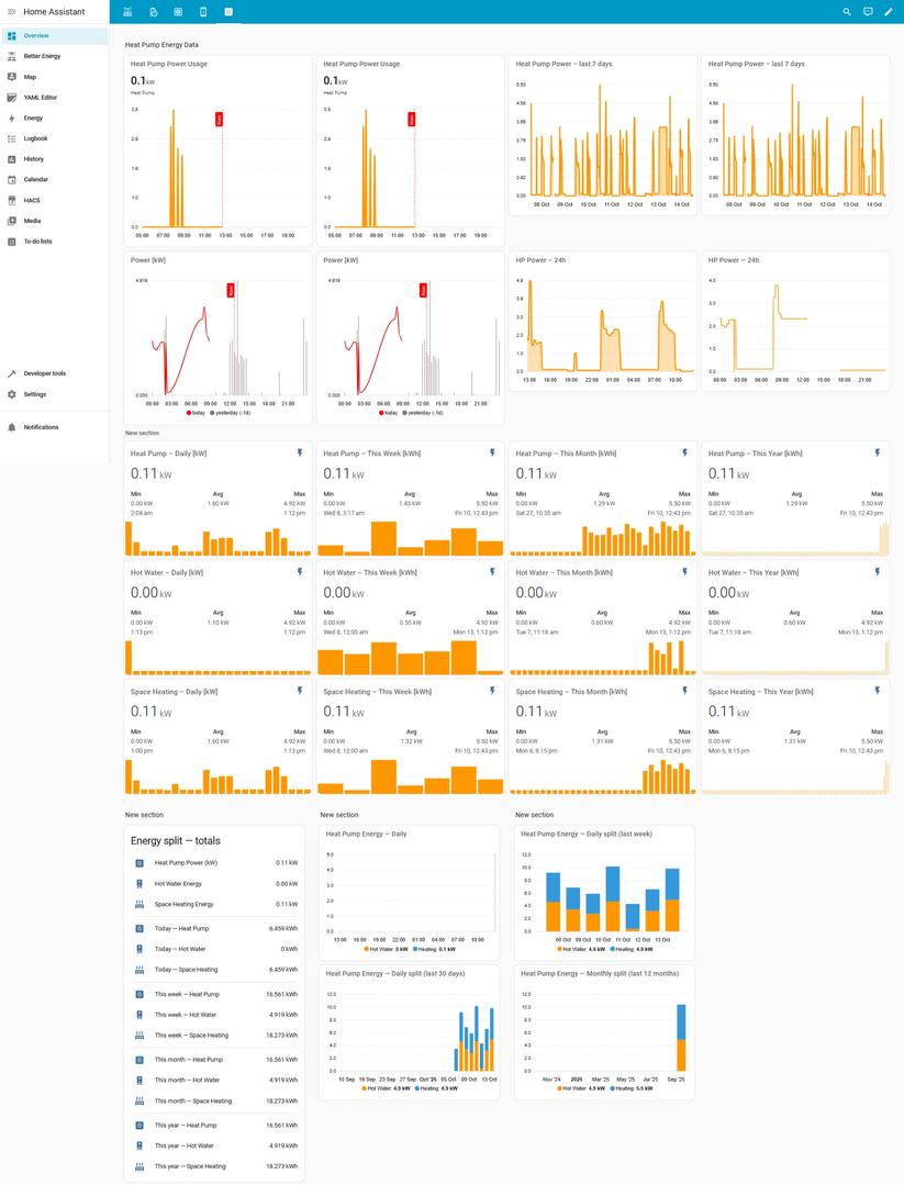

And this is my Heat Pump experimental part:

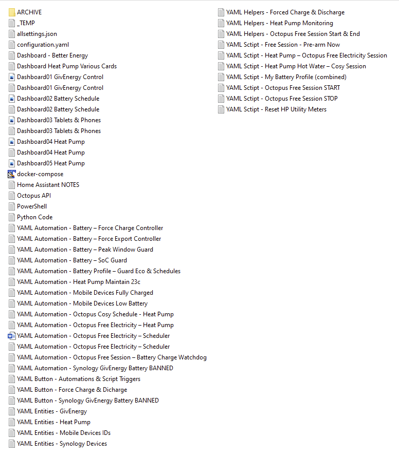

One thing I have been doing, is creating watchdogs for my automations, listening for 2 minutes, so if something hasn't changed, it will retry. Honestly, the amount of automations, scripts and helpers I went through, is nuts. I also tend to do a HA backup every time I change something. Just in case, but I am also saving everything to relevant text files, then backing stuff up in the archive folder:)) So I always have a previous version I can go to.

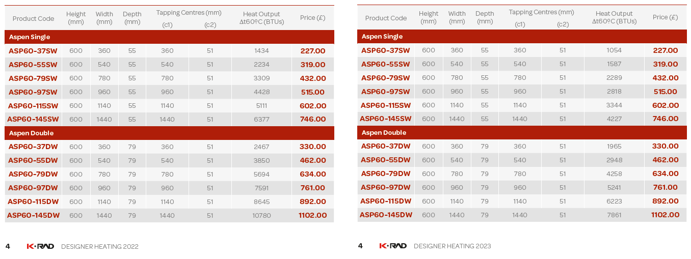

  • Radiator incident: Despite repeated warnings over several months about a loose radiator, a clear safety issue, no one from EPC attended to check or repair it. The radiator eventually detached and injured my 3-year-old daughter (photo attached). This incident was entirely preventable. What makes it worse is that there was no communication from EPC for nearly four months, and by the time an eventual email arrived, I had already given up expecting any contact or follow-up. To suggest that a response should have been anticipated at that stage would be unreasonable, given the complete breakdown in communication. A simple follow-up phone call from EPC would have been the right and responsible action in the circumstances.
  • System underperformance: EPC’s own documentation (attached) projected a system performance of 31,065 kWh output from 9,350 kWh input, a SCOP of 3.92 at 50 °C. My actual metered data over the same period shows 19,703 kWh output from 8,850 kWh input (SCOP 2.23). Despite repeatedly raising these efficiency concerns, EPC never carried out a proper on-site assessment or remedial visit.
  • Lack of accountability: For a year, I have sought meaningful assistance or explanation. To date, I have not received any technical visit or follow-up that has addressed these documented performance failures.

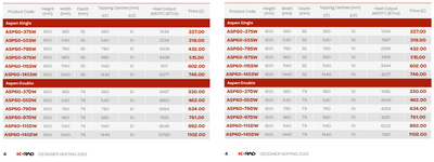

  • Radiator data discrepancy: The radiator outputs EPC relied upon were taken from the 2022 Kartell Designer Heating brochure supplied during design. However, that edition overstates radiator outputs by approximately 33 % compared with the updated 2023 and 2025 catalogues (attached and available on Kartell’s website). This shortfall would have led to systemic under-performance and heat loss across my system, an error that could have been identified had EPC responded to my repeated requests for a system assessment.
  • Hydraulic configuration loss: The system also suffered from a -10 °C temperature drop across the buffer, causing distortion and cycling. Performance improved somewhat after I manually reduced the post-buffer circulation pump speed to L1 (photo attached), but efficiency remains well below the design promise.
  • Accreditation concerns: Finally, I would appreciate EPC’s clarification as to why the company was removed from the Heat Geek network, despite being listed as certified and verified at the time of my installation.

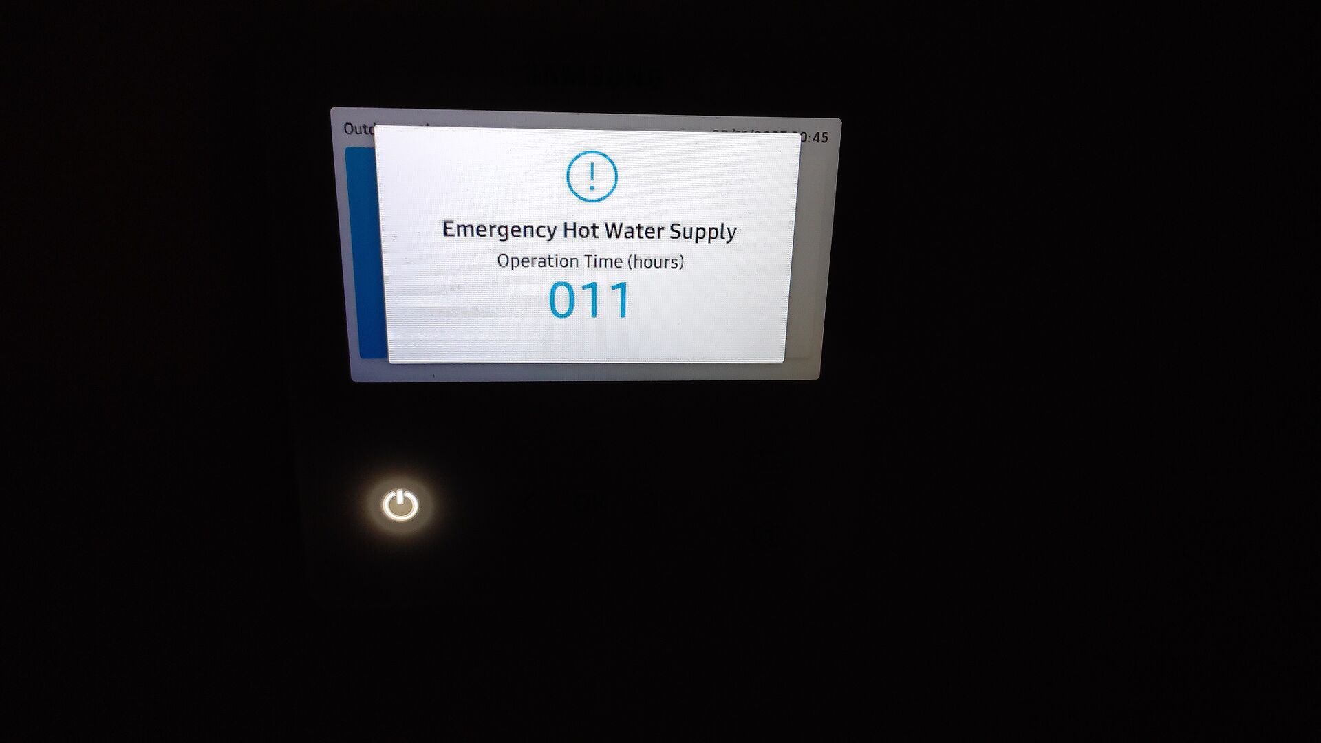

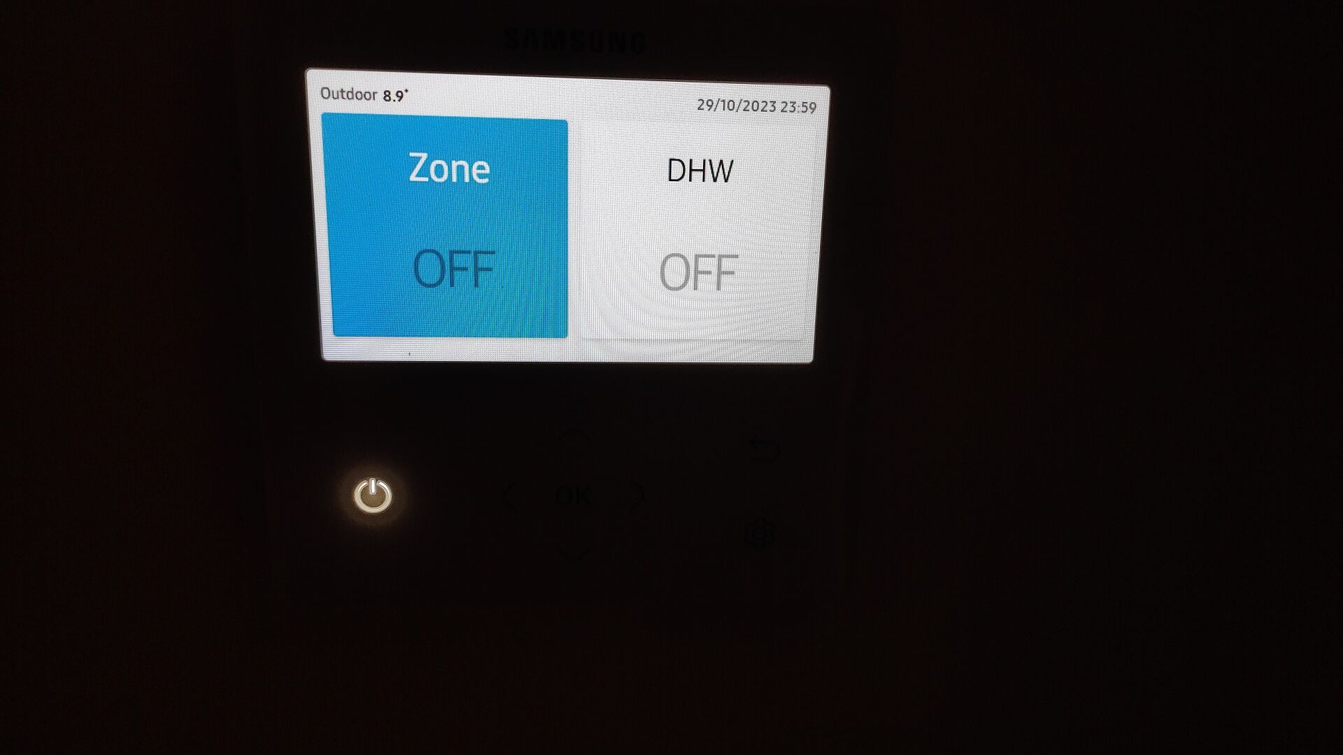

Looking back over the communications, and the photos showing my daughter being crushed by the falling radiator, still makes me feel sick. I had warned EPC multiple times that the radiator was loose.
Radiator Accident 30.07.24

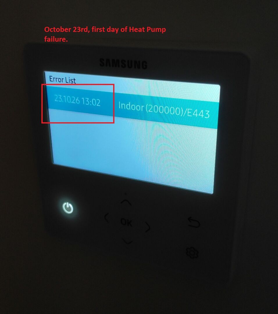

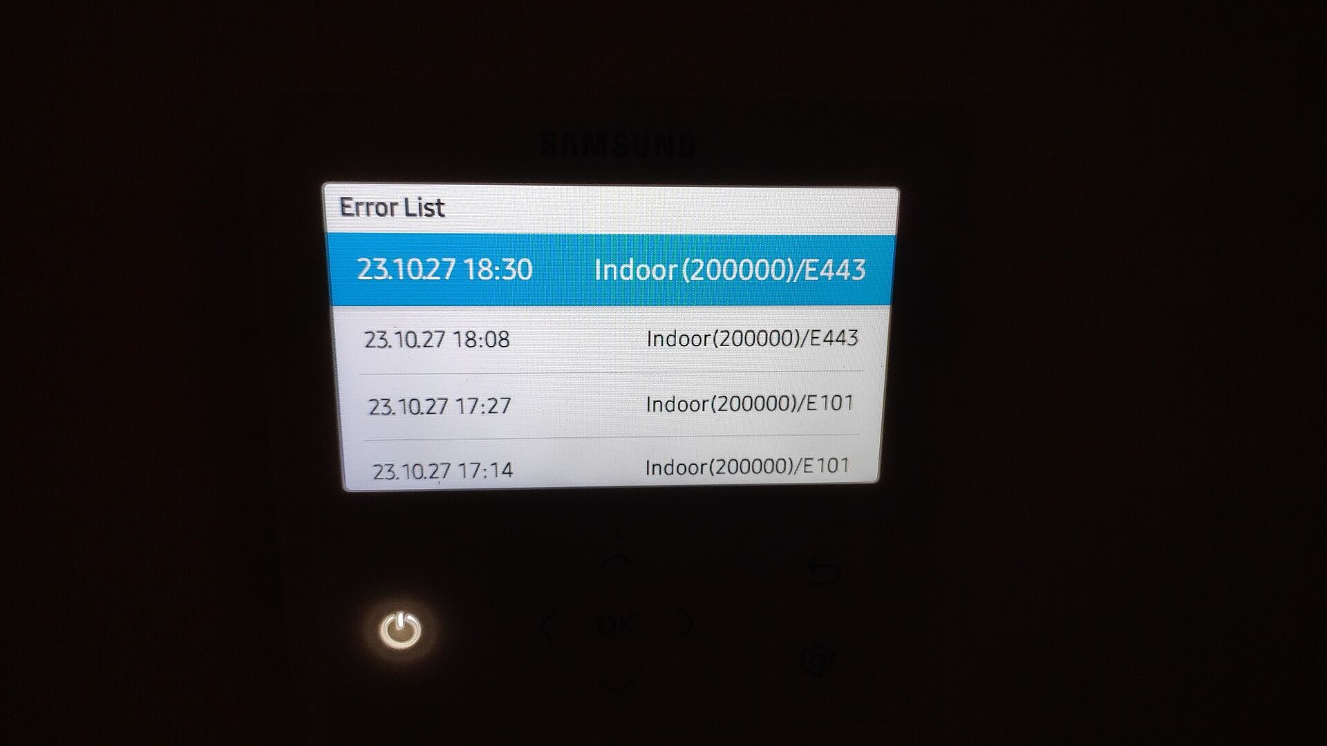

We were left without heating and hot water for 19 days between 23rd October and 9th November, only a month after commissioning, and I had to spend around £500 on electric heaters to keep the occupied rooms habitable.  The cost would have been a lot more if the space heater and oil radiators I purchased were not on offer on Amazon.
03 October 23rd 2023
IMG 20231027 190031
IMG 20231029 225907
IMG 20231102 204452
IMG 20231101 235614 1

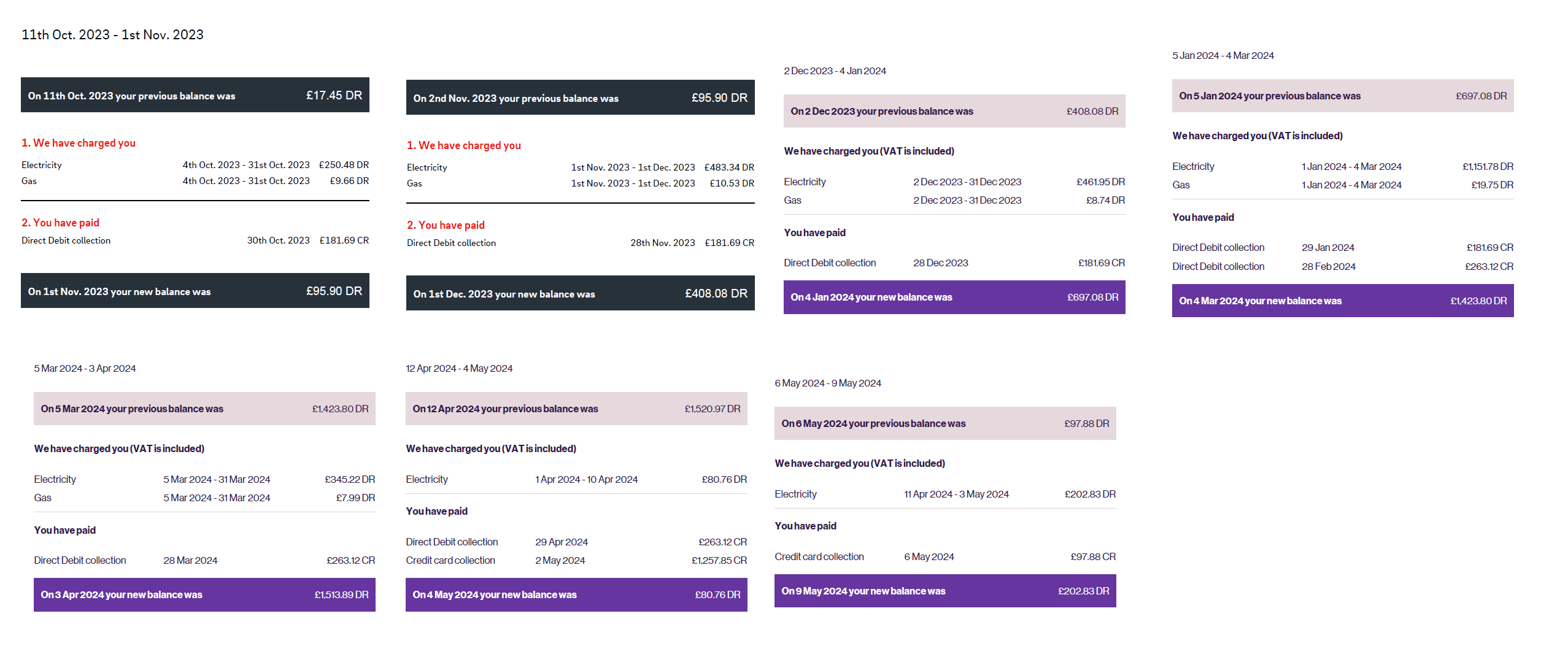

During that first winter, when I told them the heat pump was financially crippling us due to its inefficiency, my emails were effectively ignored, and was told I had no idea how heat pumps are supposed to work, and that mine was working at 350% efficiency.
UtilitiesCosts
Two years of silence, frustration, and escalating costs later, I remain angry, disappointed, and full of regret for ever choosing EPC over the Heat Geek Elite installer I originally consulted, ironically, the same engineer who finally visited this month to assess the system and provide a realistic remedial quotation.
After two long years, there is some hope that the system can be fixed. I only wish this point had been reached sooner, through honest engagement and basic aftercare.
