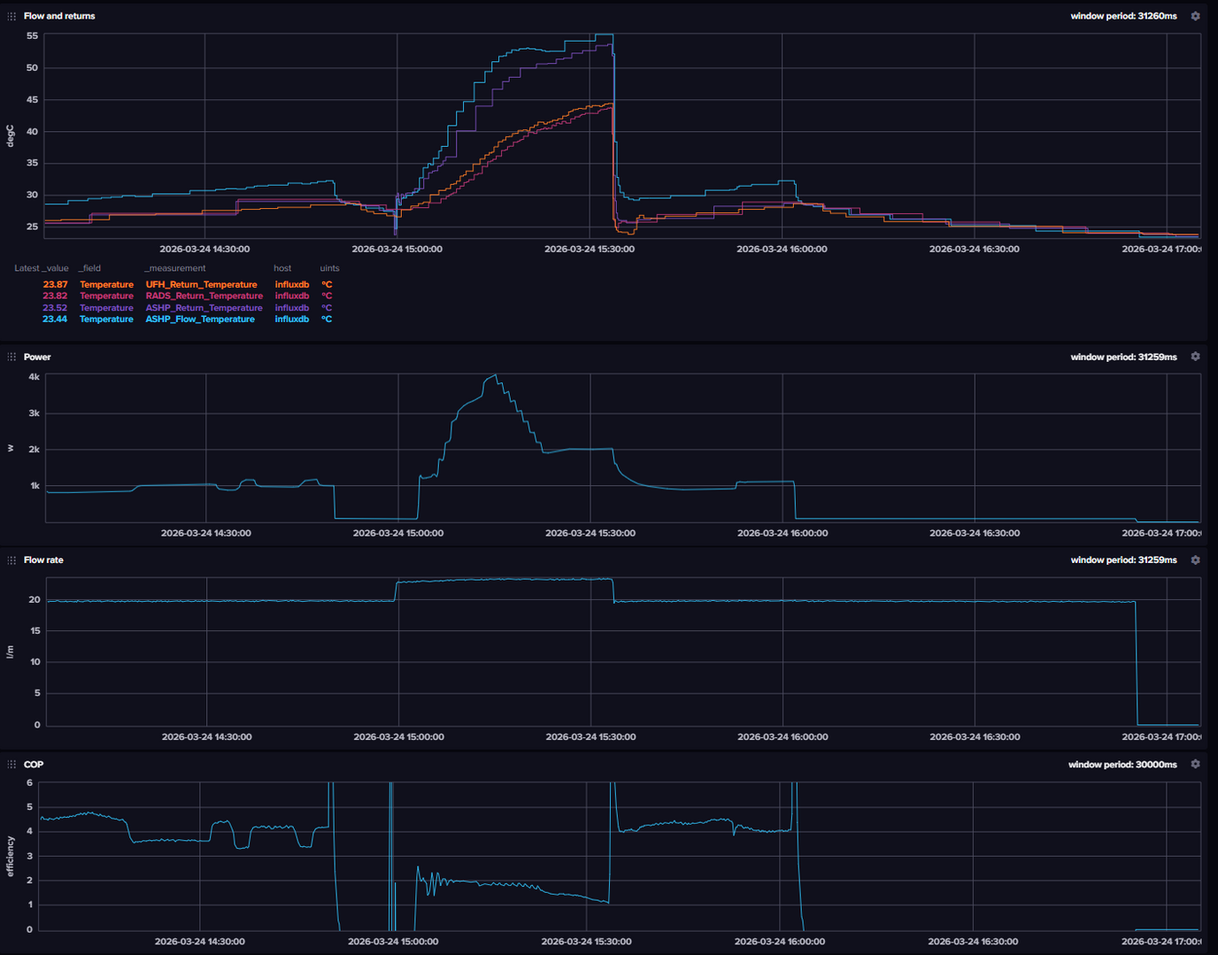

The trace below is from 24th March - The house was being heated (~1000watts). At14:50 heat pump turns off, the circulation pump continues (~100watts) for 13 minutes (10 + 3 minutes). At 15:00 the hot water heat cycle starts (increase in water flow), heat pump turns on at 15:03 (increase in power up to ~4000watts) this finished at 15:32. The heat pump then started heating the house until 16:01. From then on the heat pump was off and the circulation pump kept running (~100watts) until the room temperature was manually changed to force the system to fully switch off. (I have an alarm set to alert me if the power consumption is between 60 and 200watts for longer than 5 minutes.)
Don't read too much into the temperatures, flow rate or COP - it is a home brewed monitor kit. Nothing was added by the installer! The power is probably accurate it is an iEM2155 power meter.
Mitsubishi ecodan 11.2, FTC6, single water pump, one zone. Currently running auto adapt (same issue with weather compensation.)

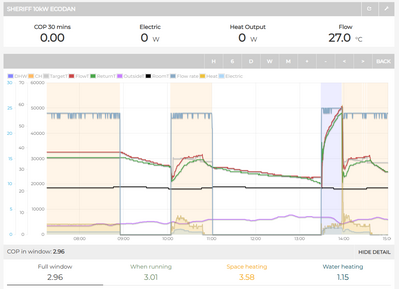

Here's an example from yesterday, where the system has done this on one occasion, but not the other.

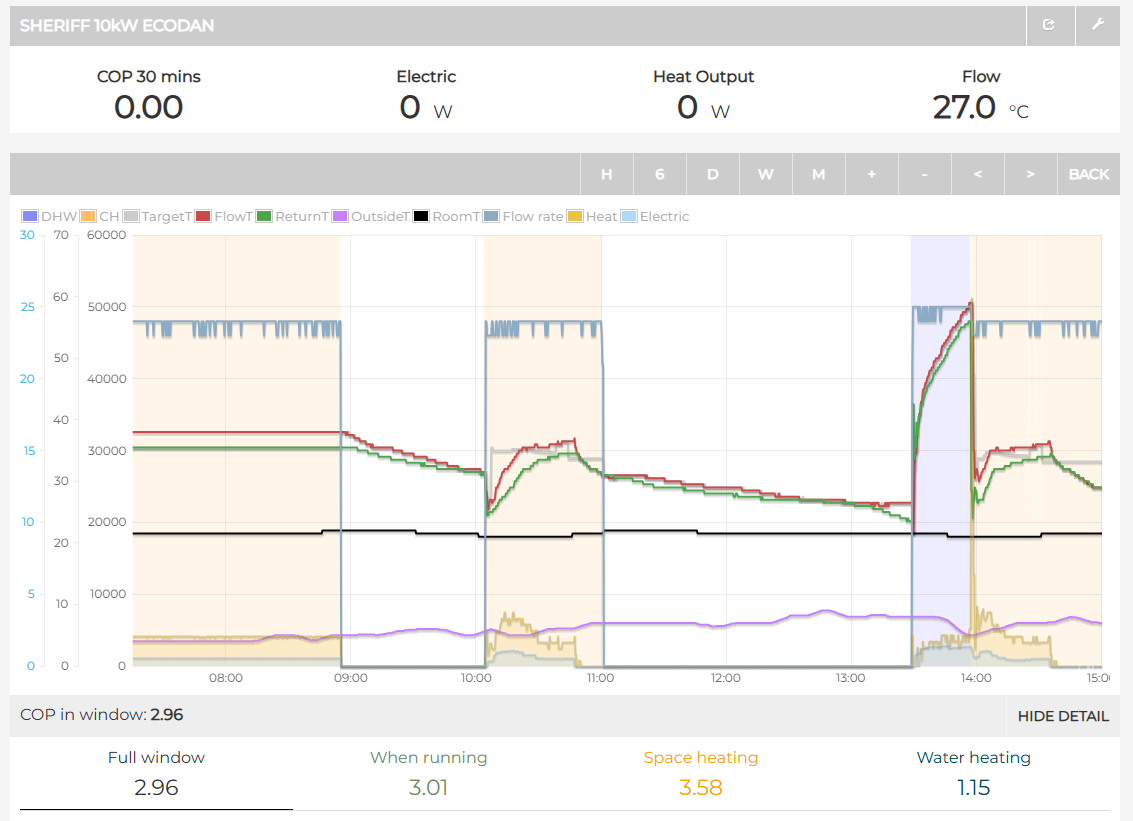

On the first occasion, just before 9am, the pump circulation stops at the same time as the heating switches off and the status changes to 'Idle', which is where the background colour changes from yellow to white on the graph.
On the second occasion, at around 11am, there's a 15 minute period after the compressor stops at around 10:48 until the circulation pump stops at 11:03, visible as a small gap where there's no input or output power within the 2nd yellow block shown. The fact that it's still coloured yellow indicates that the system is still in heating mode at that time, but is not producing any heating power, so that's perhaps the key to understanding it, as it's only when the circulation pump stops that the switch to 'Idle' status occurs. I don't think it's a bug as such, just something within the internal logic when the system switches modes like this.
I have an energy monitor attached to the smart meter for the heat pump, so am able to see the difference in input power between the two, which is a drop from circa 85W to 15W when the circulation pump stops, so it's not a significant consumption difference.
The other time that I see activity such as this is far more understandable, as it's when the system is running anti-freeze protection (NB: a different process to a defrost cycle) and continuing to keep water circulating through the system at temperatures slightly above freezing. The above, I think, is an example of the behaviour you're describing, which is different to this.

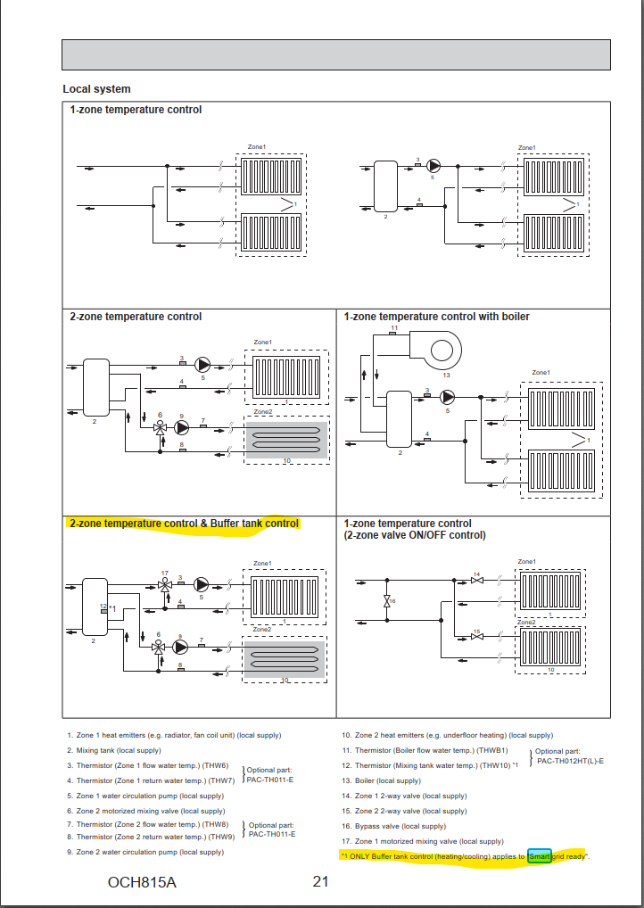

@chimpy it sounds like you might have a dip switch configured incorrectly on the main FTC board
Potentially something like the switch for a buffer tank Enabled but none is fitted in your system

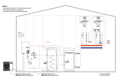

I try to figgure out why my primary pump of hp is running all the time. I want to use the SG ready contact to load my buffer (for e.g. to 60c/normally i have 35c feed temp). So fasr so good - the buffer will load to 60c if the sg contact is triggered. But when i release the SG ready contact, compressor will going off and zone pumps are running. BUT primary pump is still running and destroy the layering in the buffer - this make no sence.
my setup is:
2 zones (z1=unmixed; z2=mixed)
300l buffer tank
DIP 2.6 for butter is ON
Has anyone a idea?

Posted by: @f1pit sounds like you might have a dip switch configured incorrectly on the main FTC board
The circ pump running is normal until heat is dissipated and the flow temperature drops, b

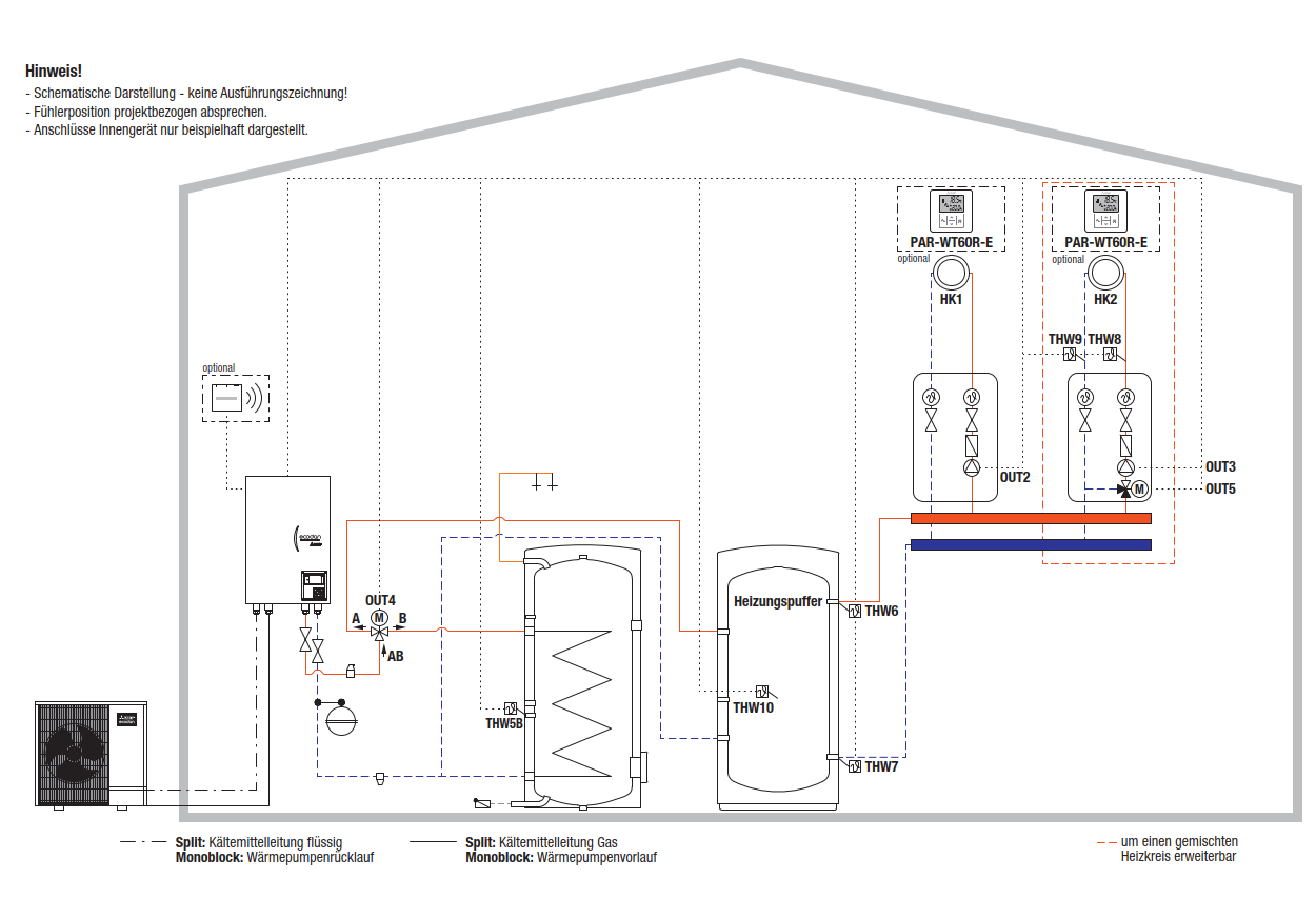

This is something that I did not consider when I converted my buffer tank to a volumiser.
Am I correct in thinking that with my new configuration the dip switch should be OFF?

My comment before should actually say Mixing tank rather than buffer
Dip Switch 2-6 is specifically for mixing and should be OFF if no mixing tank and mix valve is present
