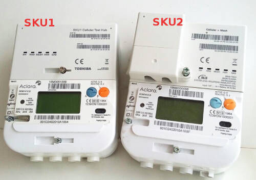

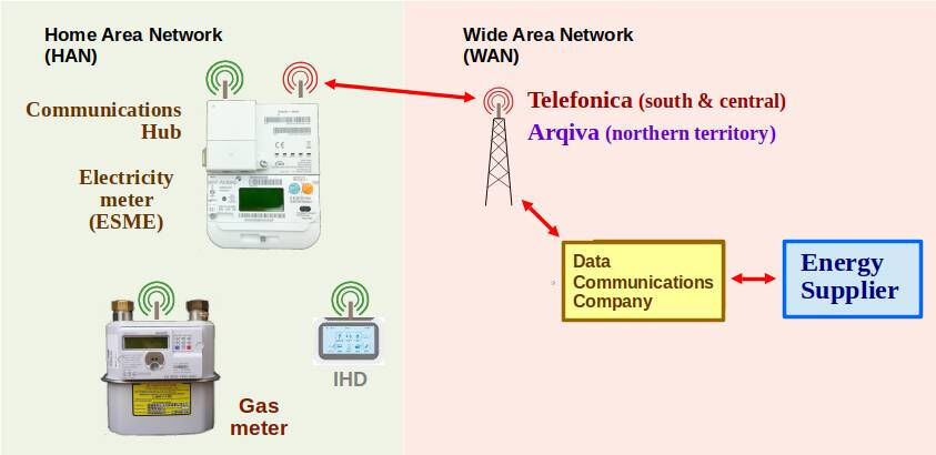

Posted by: @bellabeck
we do not have a smart meter for Gas (no signal as live within a conservation area) despite Octopus Energy changing our gas meter three times in last couple of years
That doesn't sound 'right' to me.
The national Smart Meter Network doesn't work like that!
Within urban areas each Smart Meter has a SKU1 Communications Hub bolted on top of the Electricity Smart Meter Equipment (ESME). That does indeed need to have direct access to a telecommunications mast.
SMETS datapaths
As you get into rural areas in South and Central Britain, SKU2 Comms Hubs are installed.
They have a secondary frequency which used to form a Mesh Network with other SMETS2 meters.
Depending on the terrain, that Mesh port might have an external aerial.
The Mesh forms automatically once four or more SKU2 hubs are 'found', and can extend over tens of square kilometers.
CommsHubsSKU
The SKU2 specification and Mesh Networking are defined in the original SMETS2 documentation, approved by Parliament in Nov 2014.
There are still some 30,000 properties which can never connect to the Smart Meter Network via Telefonica or Arqiva technology.
Over a year ago, the SEC (who regulate the system) approved a new firmware which could use household WiFi to make the Wide Area Network (WAN) connection.
It's still heavily protected by cyber security and encryption, and the data-path can only be accessed by DCC.
If you happen to live in such a house, then Octopus should be able to install that type of Smart Meter.
I suggest you email them, and provide a link to this post from me.
(@will-h)

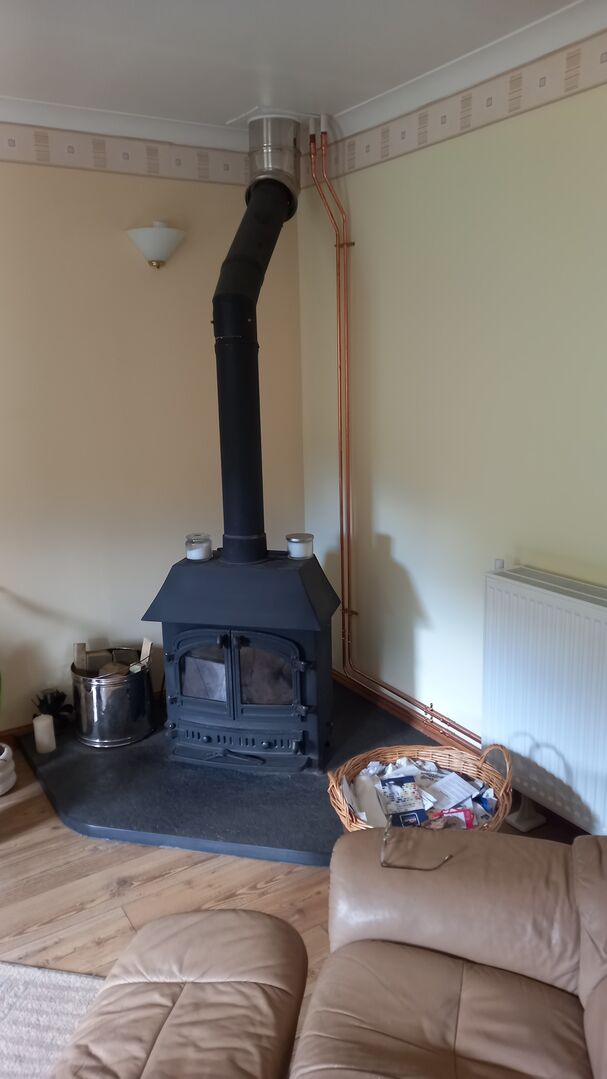

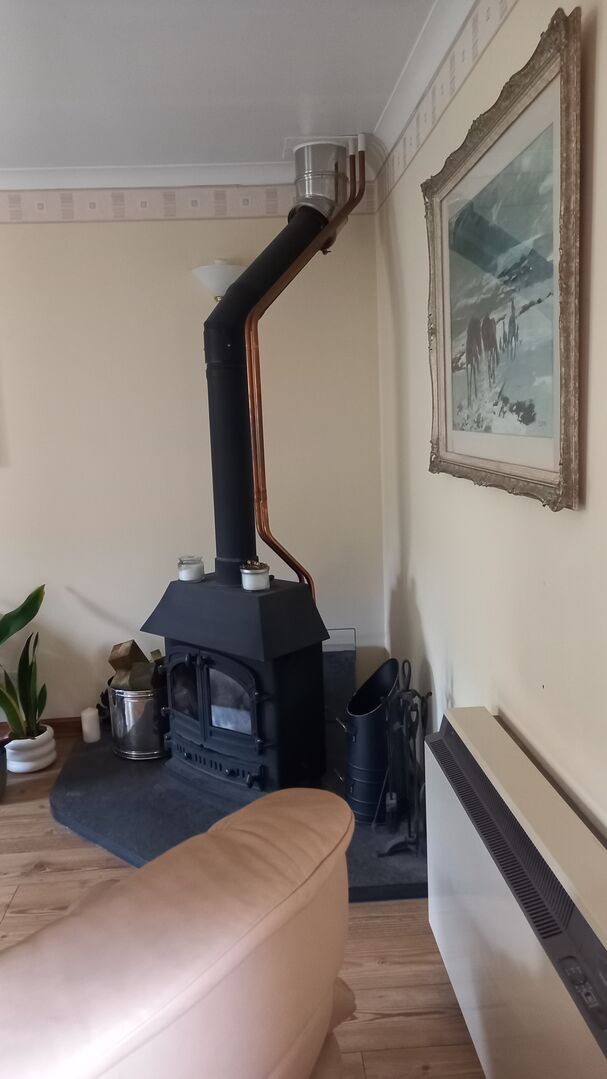

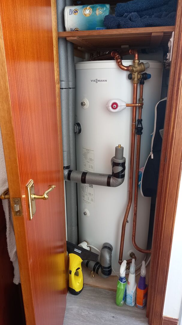

I've been following the forum, watching the podcasts for a while as our heating definitely needed an overhaul.
The house is a 1990 conversion of an old farm building which had storage heaters and immersion for DHW. 19 years ago I installed a solar thermal system heating a 160l HW cylinder. We also fitted a stove with a backboiler that fed a few radiators shortly afterwards.
More recently some infrared heating panels replaced old dimplex panel heaters. These are actually quite good, except for them still being resistive heating.
The solar panel and pump were needing replacing and then a few months ago, the cylinder started leaking from around the immersion. So ripping all that out made sense; however the size of the airing cupboard limited the options of new cylinders to slimline ones or the Viessmann one... which fitted with 15mm to spare and required removing the door frame to fit it in. That was a pain when the first cylinder leaked from one of the stubs when it was first filled. So the second new cylinder went in a few days later. So the journey had begun.
Since then I've slowly been removing storage heaters and fitting four new radiators and getting them connected onto the older well flushed circuit. That old circuit being split into two secondaries with another new secondary fed by new 28mm primaries.
I'm getting close to actually ordering an ASHP, diverter valve, filter ect.
