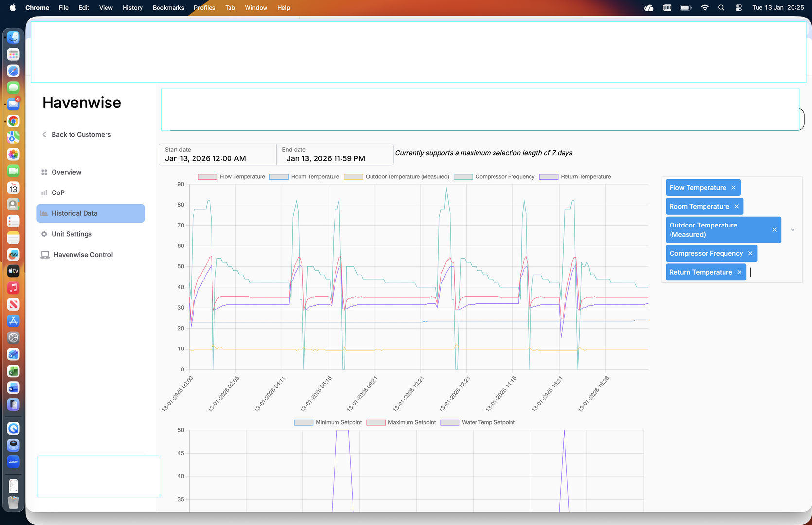

Looking at your graph you are not dissipating the heat so it is overshooting on the DT, it is not just about the loops closing even though you are setting it to run at 35 Deg C flow you still need to use the minimum kW output, the retun flow water temp is always rising rather than steady so the system will keep back off.
(@ashp-bobba)
Posts: 505
Please see attached graph from 8.5kW Ecodan serving a 244m2 hose new build 2025.
see how the return flow is steady. This is dissipating it heat so it can run steady and holding the home temp at 23, they like it very warm.

(@ashp-bobba)
Posts: 505
can you see here it not like a set of steps every 20 mins, it runs flat for 2 or 3 hrs.
I also currently have a Vaillant that is running 808hrs for 432 compressor starts, the best systems have 1 start per running hour, this systems is only 3 months old and only known a winter run, once it has done a year I have a bet with a top Vaillant engineer that I can make it 1 start per 2hrs, I have been informed this is hard to achieve, but I have a special heat loss coils in the walls at my office as an experiment to test this by heating the walls rather than the floors.
Its about the usable energy, if you can generate exactly what you need you can see the system will run gently with fewer starts / cycles. Your emitters will be unable to dissipate the heat if the heat loss is not matched to the ASHP.
