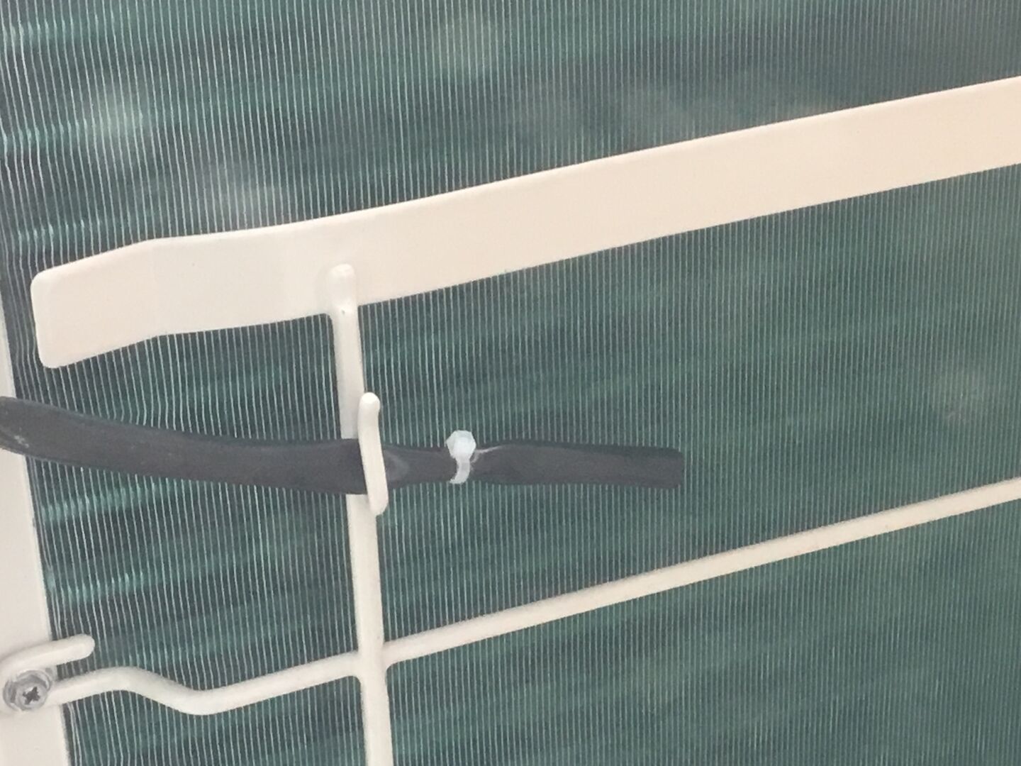

Been having some niggles with cycling and unnecessary defrosts on a newish install. Samsung Gen 6 R32 16kW 1P mono, not getting anywhere fast with installer. Image below is my outside air temp sensor which I would have thought would had a metal sleeve/ sheath covering a PT100 type RTD. What I find on mine is pliable black plastic tube surrounding some type of thinnish wire upto the point where the white cable tie sits, but for the final 2 inches it’s a completely empty plastic tube. I would have expected to see a metal sleeve/sheath sticking out the end. What’s in the picture is wrong, isn’t it? Thanks

Looks very ‘normal’ to me, not that I have seen many probes ‘in the flesh’ so to speak. Those I have seen and photos of others look very much like this one does. I think the ‘empty’ tubing is for protection only, the lead connecting it to the pumps PCB is usually retained as yours is by a clip and the probe may be a cm or two from the rear face of the pump. It looks crude I know but it is quite common that they are mounted in this way. Regards, Toodles.

@toodles thanks, are you sure please, no metal sticking out of the tubing? Like a ferrule.

@papahuhu The sensor (set back in the tube is surrounded by plastic which protects it but the ambient temperature around it is still the ambient temperature as the tubing will have minimal insulating qualities (and is of course a constant; should a breeze blow over the tube, it will still cool it to the ‘feels like’ temperature within seconds) Regards, Toodles.

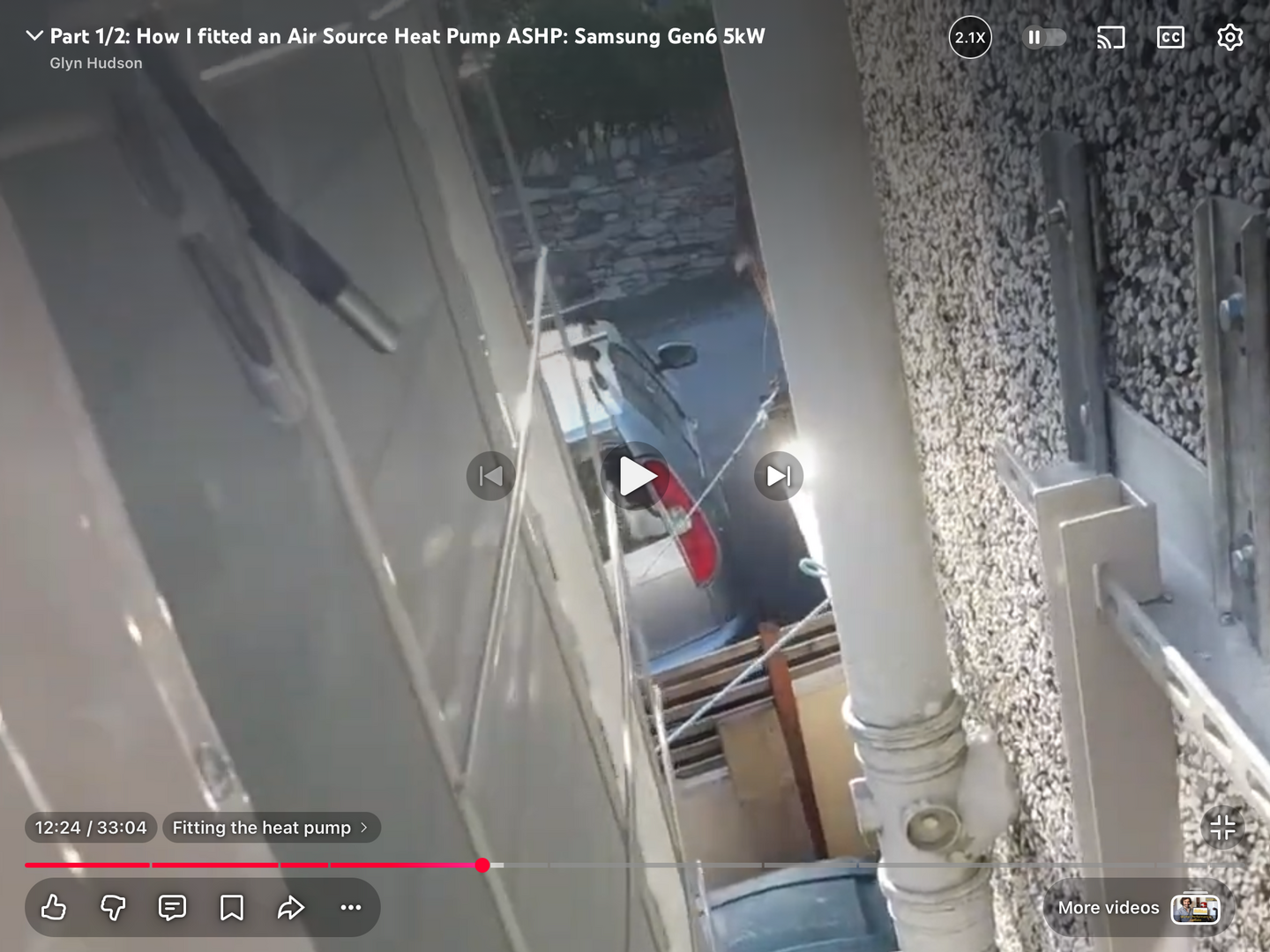

This is the only reference image I can find of the same, albeit smaller unit. Mine looks very different to this.
