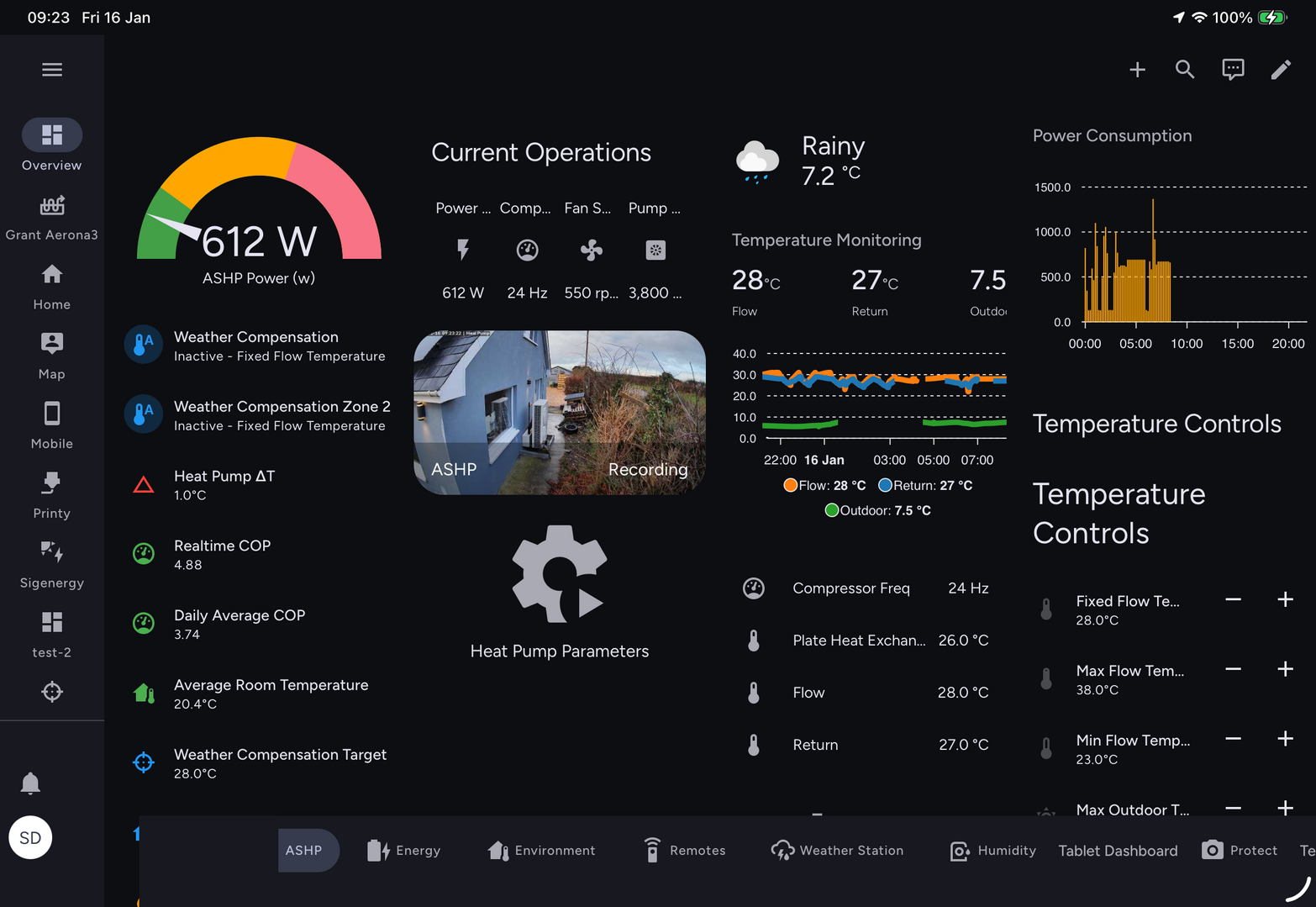

Hi Topher, welcome to the world of ECO4 disappointment lol! I have the Grant 13kw Aerona3 R32. I went down a very convoluted route using Home Assistant and a custom integration I built. For reasons unknown to the sane world when Grant licensed the Aerona3 from the Japanese company Chofu they basically dumbed it down and took out access to some quite useful settings like low tariff mode and night mode. Low tariff mode allows you to set the unit to work harder during that period while night mode restricts the compressor making it less noisy (read power hungry) perfect for peak electric period.
Of course you can set up all these timings in the menu on the caveman controller but unless you can trigger them on the pcb at the unit it won’t work. I initially got a couple of Shelly remote switches which worked well just via the Shelly app.
I then went down the rabbit hole of modbus control via Home Assistant and have built my own smart controller. Either way you are probably going to have run extra cables to the unit. If you want to know more let me know as there are also some semi wireless options as well.

You forgot to mention probably completely unnecessary lol!
