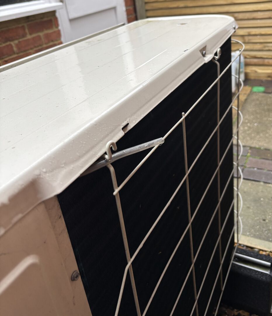

Mystery solved courtesy of @aventus-eco (thanks Sean) who just messaged me saying:
Yes, it's correct.
Should technically be touching the coil.
It’s to send for ice and defrosts.
And with a photo:
WhatsApp Image 2026 01 14 at 16.16.26
There's nothing conventional about Samsung 🤣

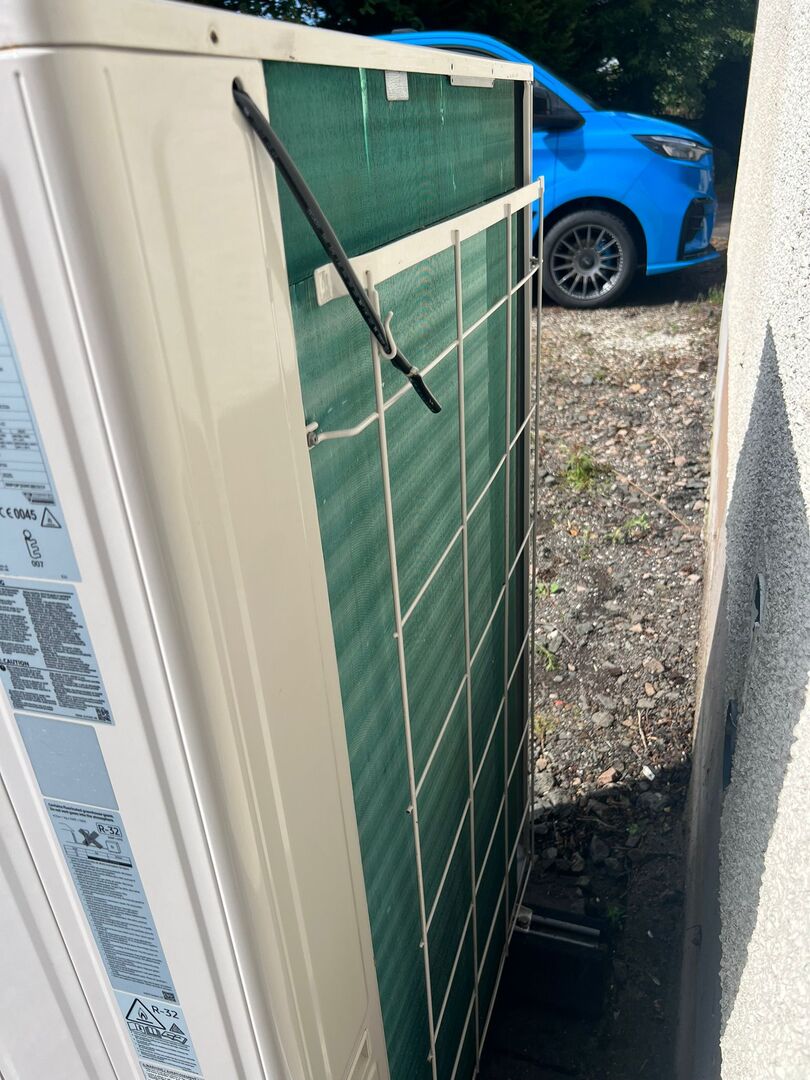

Mine is similar. Is your house not getting warm enough? Are yiu running on weather compensation?
I also have some sensors left over.

Thank you, so it seems it isn’t the outdoor air temp sensor then. How difficult would it be for Samsung to actually produce a engineering diagram identifying each component!
So it’s a frost sensor, mine doesn’t touch the coil nor does the one in the photo that Sean sent you. Either they need to touch the coil or they don’t, it doesn’t seem to be a subjective requirement. I wonder if that’s why mine keeps going through phantom defrosts? Who to ask, my installer is useless, Samsung tech support is not existent. 2 steps forward, one step back, fecking heat pumps!

@papahuhu I am attaching a photo of the sensor siting on the rear of my Daikin Altherma monobloc heat pump; it looks as though the sensor is some ~6-7 cm. from the fins to me. Regards, Toodles.

@papahuhu Comparing our two arrangements of sensors, I suspect that the sensor you attached a photo of some postings back is of the sensor for the OAT similarly to my Daikin. Regards, Toodles.

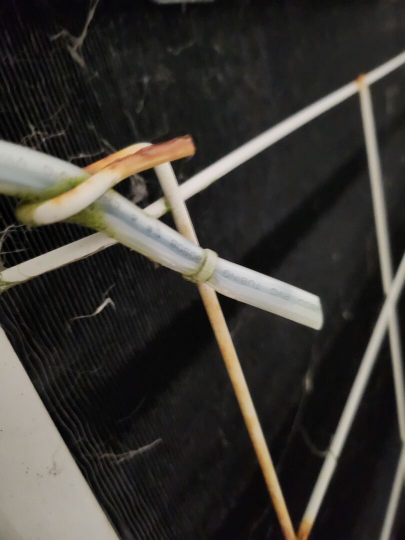

Been having some niggles with cycling and unnecessary defrosts on a newish install. Samsung Gen 6 R32 16kW 1P mono, not getting anywhere fast with installer. Image below is my outside air temp sensor which I would have thought would had a metal sleeve/ sheath covering a PT100 type RTD. What I find on mine is pliable black plastic tube surrounding some type of thinnish wire upto the point where the white cable tie sits, but for the final 2 inches it’s a completely empty plastic tube. I would have expected to see a metal sleeve/sheath sticking out the end. What’s in the picture is wrong, isn’t it? Thanks
IMG 0240
This is perfectly normal. The outdoor temp sensor on my Gen 6 is identical.
Mine reads reasonably accurately, maybe slightly on the low side (~0.5C low).
The data can be read at the top of the home screen, and is used for WL (weather compensation) as well as defrost operation and pump anti-seizure cycles (below 5C).
