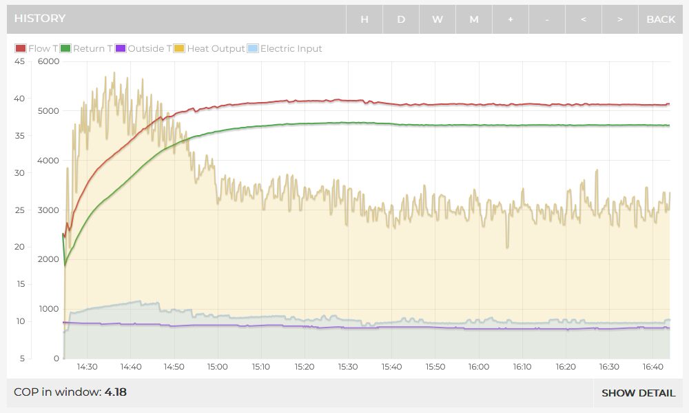

Once the heat pump was up and running, I set about adjusting the weather compensation settings to give us the appropriate heating temperature. We prefer 22C in the living rooms and cooler in the bedrooms. All thermostatic radiator valves were opened to their maximum, and the manual radiator valves were used to adjust flow. Further adjustments were made as the outside temperatures got colder later in the year. We tend only to heat the house during daytime hours.
The heat pump performed well, with heating SCOPs between 4.65 in September to 3.97 in December. After purchasing an electric vehicle and moving to the Intelligent Octopus tariff, I made the decision just to heat the water cylinder via the immersion heater at night for 7.5p/kWh and not to purchase a heat exchanger to enable it to be heated via the heat pump.

I’m curious how your measured SCOP compares to the “generated" and “consumed" energy totals reported by the Samsung itself? I have an oversized Gen6 Samsung 8.5kW in a super-insulated house (peak heat demand 3.3kW, which delivers an average generated / consumed ratio (SCOP?) of 2.75. This includes hot water use with legionella killing switched on. Very frustrating. I know it’s crazy to have such a big HP, it came before the insulation before I knew the word “heatgeek", sized on the old EPC, and cycles like crazy! One cheer for the installer.
Old_Scientist
Sorry for the delayed reply, there was no notification of your question and I just happened across it. The Samsung COP is vastly less than my openenergy monitor COP. For example on the 27th Samsung reported 4.2 whereas OEM reported 5.2. Given the fact I am using a certified heat meter, I am confident it is Samsung that is wrong.
@bontwoody I don’t have a heat meter, but I do have a MID-approved electricity meter measuring the consumption of the heat pump (heat pump only, so excludes MIM controller and pumps), and the Samsung reported figures are more than the MID meter, even allowing for pump usage, measured at 35W each (two pumps, 70W combined). I have to rely on the Samsung figures for generation to calculate (S)COP as that’s all I have, but at least I know my electricity usage is low.

I get reasonably good COPs by trying to extend run times using batch heating. You are never going to be able to run continuously low and slow, and the cycling will kill efficiency. I use an external room thermostat (FSV #2091/2) and run in “continuously on" mode (FSV 2093 = 1) to prevent the heat pump cycling, and then just try to extend run times. This does result in significantly more temperature fluctuation but we do achieve good COPs (currently over 5 on a heating run). At the moment we may run the heating for around 30-45mins and then turn off and allow the house to cool by 1-2C before another short batch of heating. We run with a flow temp of 32-33C at the moment, which is the minimum we can achieve in order for our radiators to be able to dissipate the 4kW plus of heat that is the minimum output of my ASHP.
So we can potentially just about achieve continuous running once the outside temp hits 0C, but as soon as the temp rising above freezing, we are cycling or switching off (and we only seek to heat to 20C)
