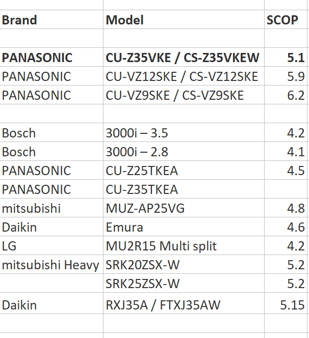

It seems to me A2A has a couple of significant efficiency advantages. By using the heat pump output directly into the room you are always working into the lowest temperature in the system. Typically 21 C though in my case 18. In an air to water A2W system the heat pump heats the water flowing in the emitters. This always has to be warmer than the room of course, and is at it's warmest and so least efficient when demand is highest. The world of A2A seems less concerned about SCOP than A2W but I have seen reliable figures that a SCOP of 5 or 6 is easily achieved. Does anyone know more about that, or of any sources of information?

Here is a screenshot of a spreadsheet I picked up somewhere to give you an idea of SCOPs. We have an A2A in our kitchen and it works well, particulalry in places that dont have to be heated all of the time.

@bontwoody Thanks for the info. Quite a spread of values. I was also wondering if anyone had actually measured the performance of their system.
