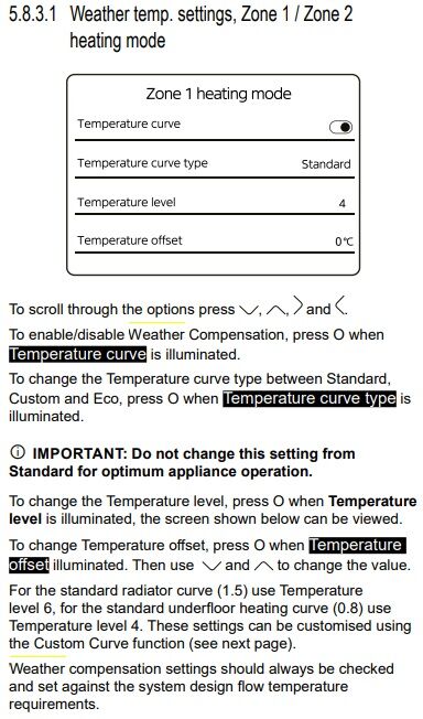

just looked at the HP290 manual.
Weather compensation- the manual states “do not change this setting from standard for optimum appliance operation.”

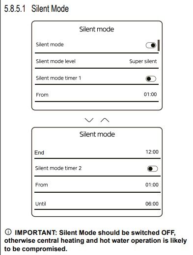

Silent mode - “should be switched off otherwise central heating and hot water operation is likely to be compromised.”

With 'Standard' there are 8 different heat curves (temperature levels) available, I think the idea is that you can change between these (My Vaillant has a very similar concept), whilst still leaving Standard mode set!  Thats certainly how I read it.
The manual is right about silent mode, it may well compromise heating because what it does is reduce the max compressor modulation, which may mean it cant deliver max output.  However as a way to make it quieter at night (and given that @cmartinbwmba already accepts a setback) its potentially an option.  This is not the most important thing however, setting it back on the Halo may well be as good, depending on how exactly the Halo works.  The most important (for @cmartinbwmba) is to get the weather curve right (in standard mode) and emitters balanced.

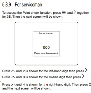

Thanks everyone so much for your replies and help. Last night I took the plunge and removed all the Honeywell TRVs after setting the 4 zones to 24C. I had to remove them as they seem to whirr around of their own accord overnight even if you ask them to stay open or closed with temperature target commands. I then went into the loft (I don't have Halo) and did the following:
Screenshot 2026 01 13 112347
So essentially to gain control the code is 234 once you have pressed the three lines and right arrow together for three seconds. I then went here:

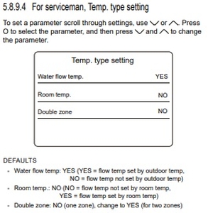

Screenshot 2026 01 13 113224
to make sure I had the right settings, and then here:
Screenshot 2026 01 13 113501
which is how I think one disables the room influence. I then set the weather compensation to 6 here:
Screenshot 2026 01 13 120204
and will see what happens. I guess I just use my own thermometer(s) inside the house to adjust the WC levels, and get to work on the LSVs slowly.
I also tried silent mode:
Screenshot 2026 01 13 120941
 - this seemed to simply turn the system off overnight and additionally probably made the DHW heating ineffective as there wasn't very warm water in the shower in the morning! So will stay away from this for now.
