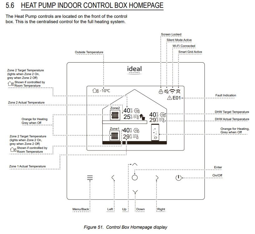

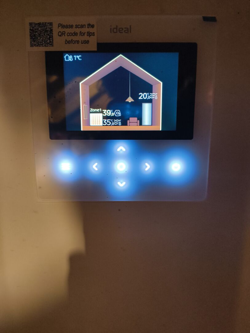

@jamespa Brilliant thanks. Sorry for this - where do I find the flow temp? Is it on the main display?
IMG 20260105 181440594
Posts: 5710
I think so,  I would guess its either 35 or 39, hopefully the symbols are described somewhere in the manual.  If you go down a level it should become clearer.

Screenshot 2026 01 13 154501
It doesn't mention flow temp here but don't know how it could say it was my zone 1 temp if it was 35C on my pic..

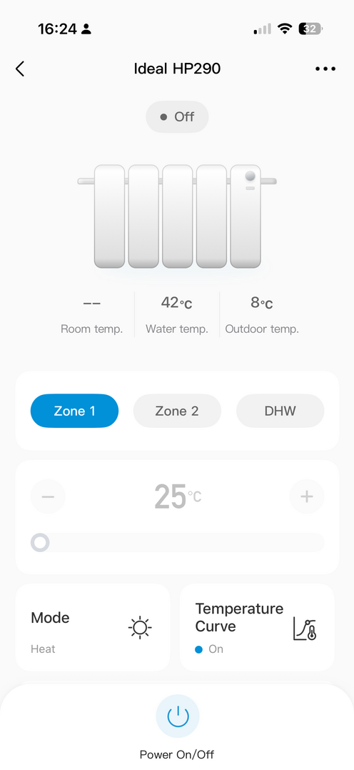

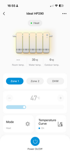

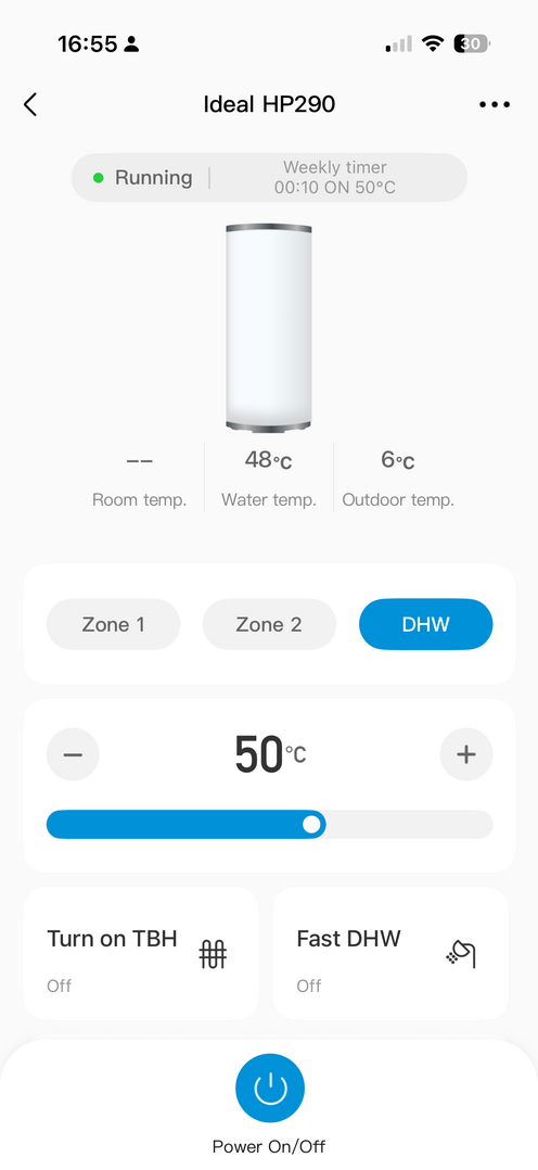

IMG 0023
There is a third party app called iLetComfort available on the App Store which shows some basic data, CoP, flow temp etc etc. You can make alterations to some settings and see your energy consumption. I’ve been using it for 5 months now and it’s fairly useful. Especially as I chose to have my Ideal control box installed in my airing cupboard on the basis it’s a big white box. You can’t adjust the clock for daylight saving. This has to be done on the control box though oddly the Halo auto adjusts. The app also tells me that I’m on temperature curve 7.
IMG 0022
