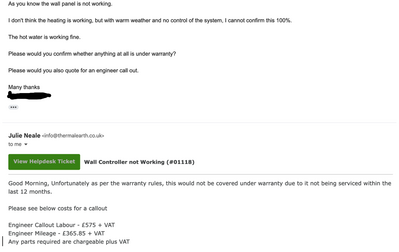

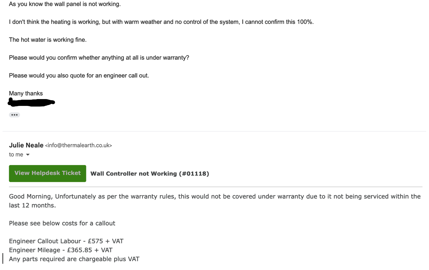

Our Acond heat pump fitted in 2022 by Thermal Earth stopped working in May; as the weather was warm and the immersion heater kicked in automatically it took me a while to realise.  Thermal Earth advise they will charge £575 callout plus VAT and additionally £365.85 mileage plus VAT; this will be payable even if the pump cannot be fixed.  They have advised that the warranty is completely void because the previous occupant only had the pump serviced in 2024.  I was told this was because Thermal Earth refuse to allow other heat pump engineers to work on the pumps they have installed, and their servicing and mileage costs are prohibitive.

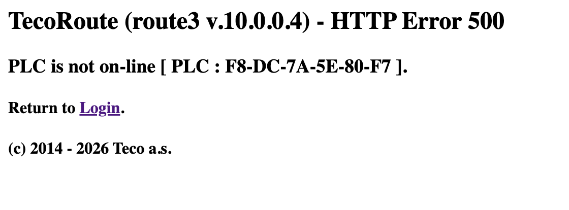

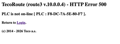

I will attach the error message I initially got when trying to log in to the heat pump.

PLC (programmable logic controller) not online suggests either a failed circuit board or simply a failed connection.  Is the cable connecting the ODU to the controller (or any other connecting cable) in any way vulnerable, that would be my first port of call given the error message.
The fees suggested do seem high, that said circuit board replacements do tend to be very expensive, I had one for a boiler which cost over £400, and that was a few years ago before manufacturers hiked the prices.
I assume you have tried power cycling both odu and controller a couple of times.

I had already asked whether the entire warranty was void, I will attach a screenshot of my question and their response to this; I understood them to be saying yes, it is all void.  There is nothing cut off the bottom of the screenshot, this was their entire response.  Incidentally the hot water was not working, I'd not realised the immersion heater had come to the rescue.
They did not offer remote diagnostics.  They suggested the hard reset then said after that the only option was a callout.
The callout fee includes both diagnostics and, if possible, repair, although they said it is still fully payable if repair is not possible.  They did not clarify what happens if the engineer needs to come back another day to complete a repair, whether there would be another callout charge - I have now asked them to clarify this.
