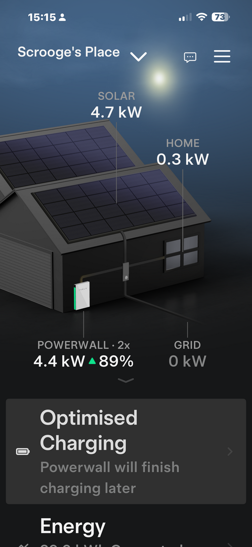

Another ‘feature’ of the Tesla app now is they have introduced ‘Optimised Charging’ and on at least two occasions, my battery was not fully charged at 16:00 so export is reduced slightly. This also means that the solar energy that might have gone into the battery has been sent to the grid at sub-optimal rates before 16:00.

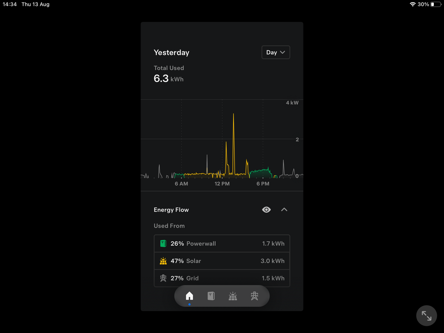

sorry it’s not worked out for you, not much of summer left anyway. It seems you have all your heavy loads in the evening whereas I schedule mine to occur at peak PV output. As an aside, I remember you mentioning you chew through about 20kWh a day, you do realise that is very high for a 2 person household. We are a 5 person household and summer use is never more than 8kWh including hot water. Has anyone ever checked your smart meter calibration or that you aren’t on a shared supply and there’s someone borrowing it.
It’s odd your battery didn’t reach full charge by 16.00. Even on a rainy day mine will import if necessary to ensure this, I don’t get why yours doesn’t but I guess it’s irrelevant now anyway.

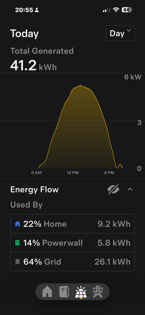

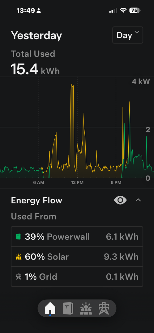

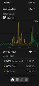

@papahuhu Here’s yesterday’s solar production (Not forgetting that small blip after the eclipse of the sun!) and consumption graphs according to Elon. I am not aware of anyone piggy backing on our power - and who wants to tangle with SWMBO when it comes to when washing / drying and washing up are undertaken?! Life is never simple! Regards, Toodles.

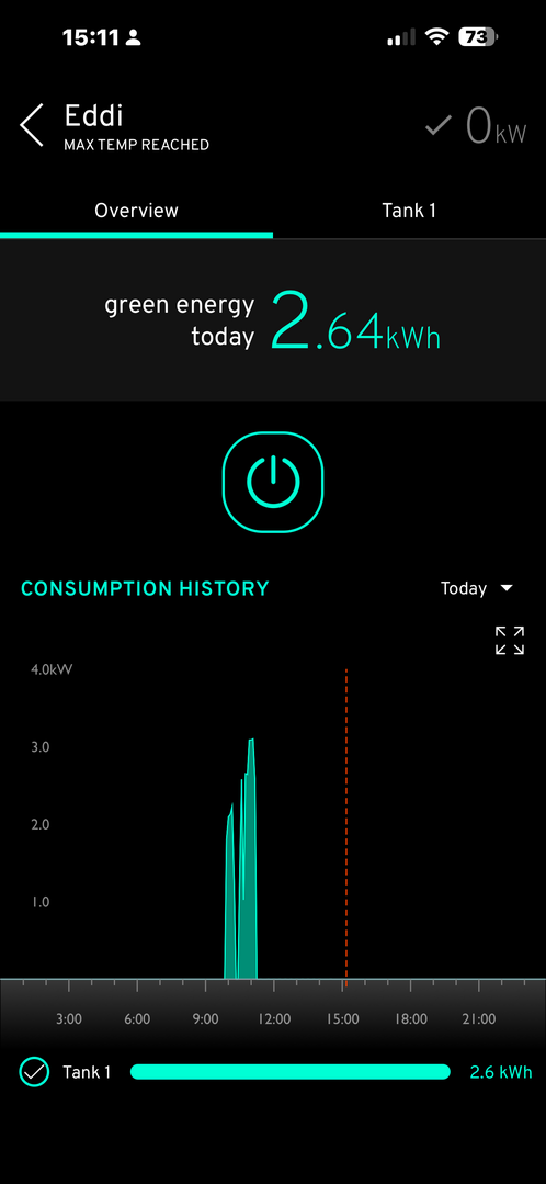

@agentgeorgepapahuhu Our Sunamp Thermino DHW system currently consumes ~ 2.5 - 2.9 kWh per day.
@papahuhu I’m ‘special’!😉. This state usually shows up after ~ 70% charge and will exist for perhaps 30 - 60 minutes then have a few more % charge, then rinse and repeat! Toodles.
I saw the same 0.1kW at 19:07 so thats when the eclipse happened d at 53 def Norf
