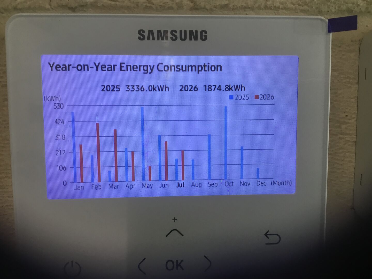

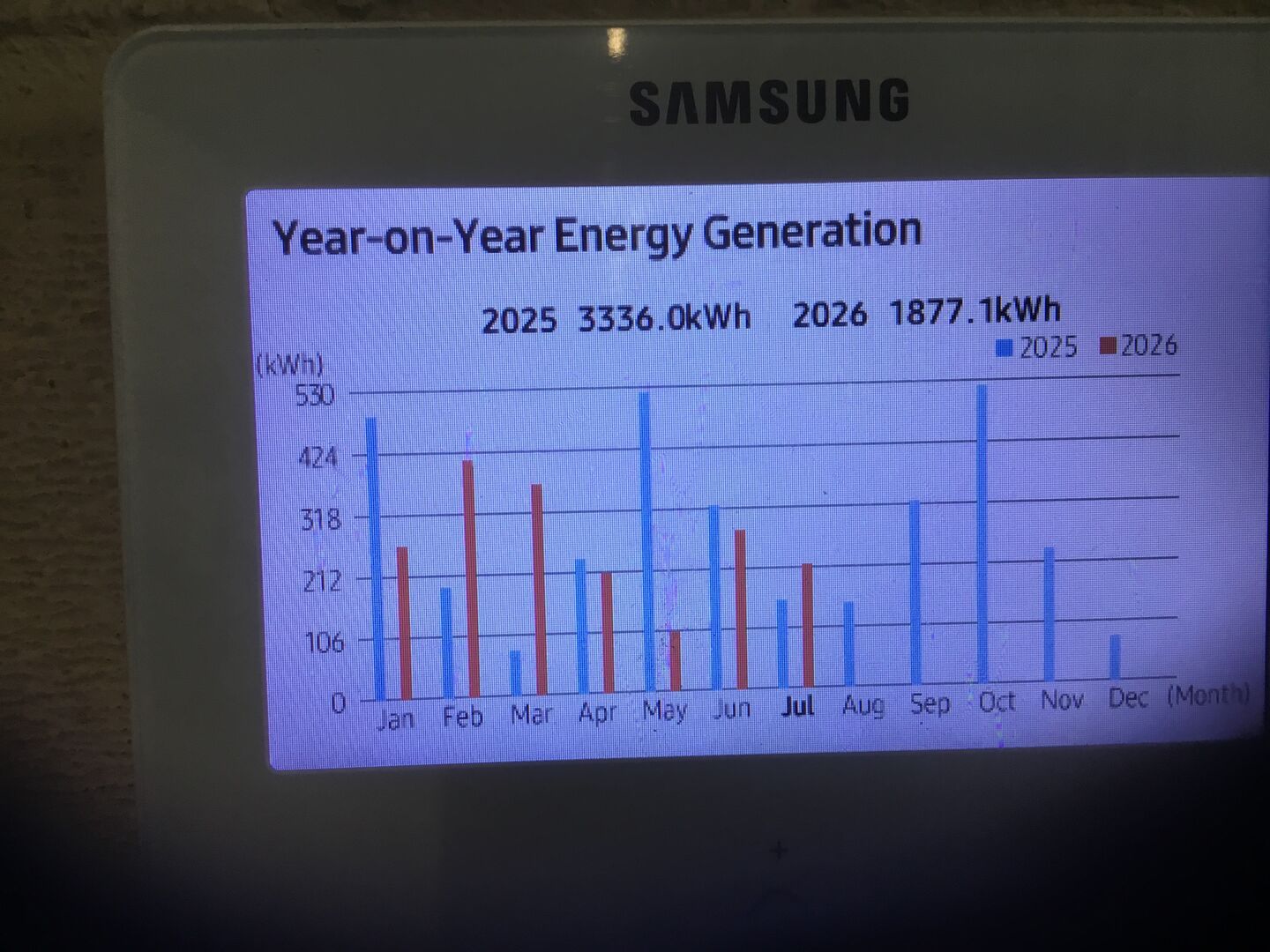

I forgot to ask you, I’ve got something weird going on with my gen 6 controller. It seemed at the 1 year point, all my generation/consumption data went to cock, to use the engineering term. My consumption and generation become identical, giving me a SCOP of 1.0, whereas it was running at 4.9 last time I checked. It even shows generation data from 6 months before it was installed. Did you get this gremlin please, I haven’t called Samsung yet? I tried a full hard reset, it made no difference.
IMG 0300
IMG 0299
@papahuhu I'm away at the moment, but will try to remember to take a look when I get back. I know when I previously checked, mine only showed data for the current calender year. I think mine reset on Jan 1st and all the previous year's data vanished. I don't think mine ever showed multiple years like yours does, but I could be wrong.

Thanks, yes, that was my recollection too. This menu item appeared out of the blue, but it impacts my daily, weekly and monthly figures too. What makes it weirder, is that my homely COP data is fine. To add further confusion, I only saw it after I had my unit serviced, never before.

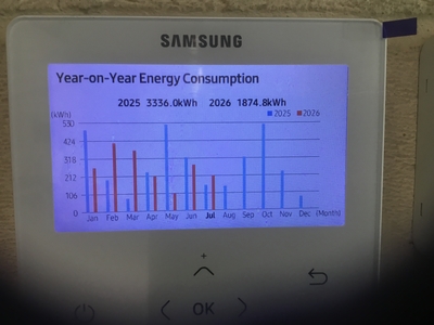

IMG 0300
IMG 0299

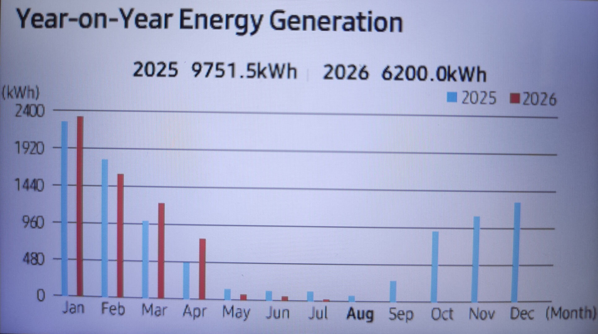

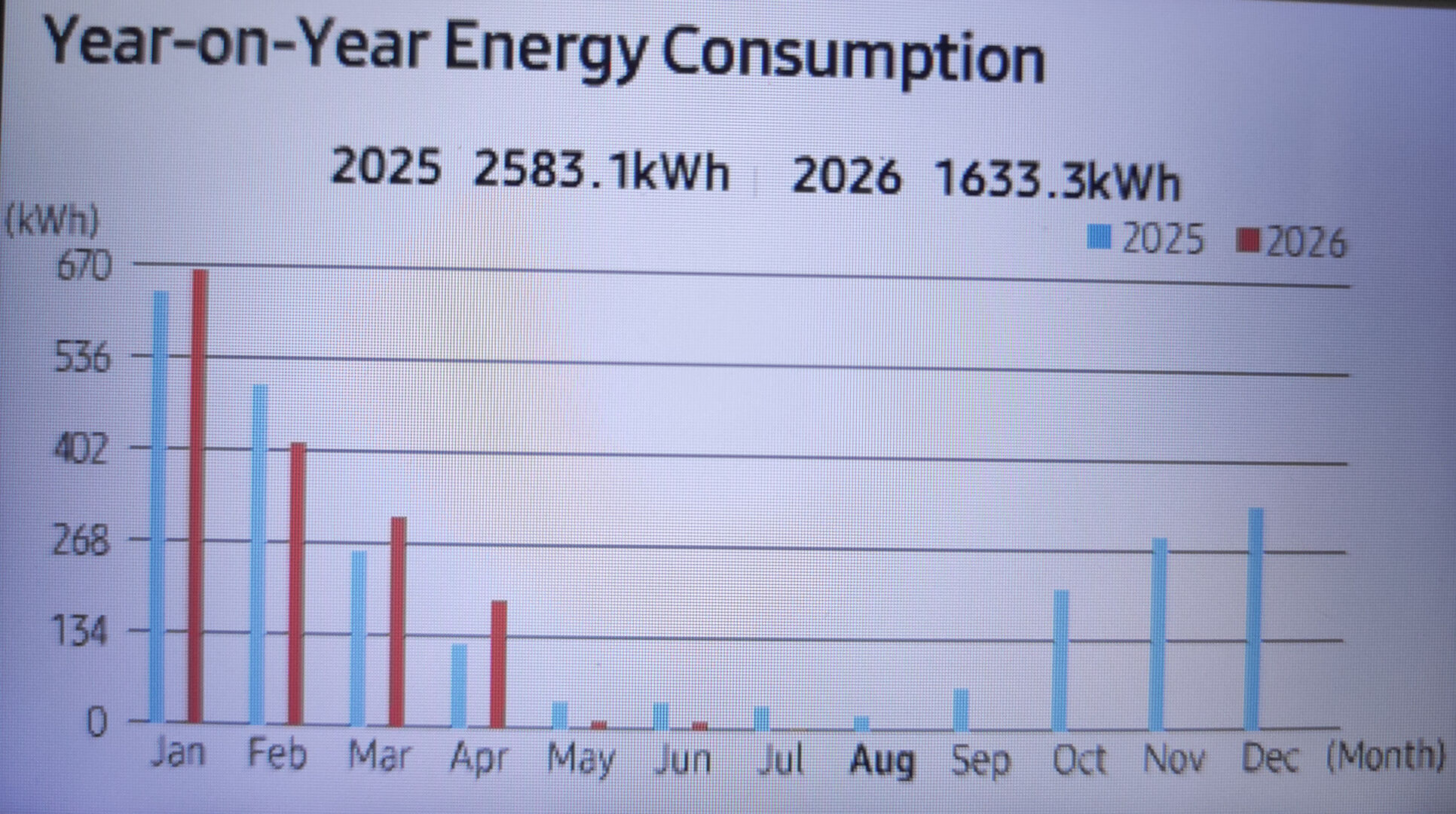

@papahuhu As promised, just checked mine and they look normal. Not sure what has happened to yours. TBH I've never looked at that screen before, I normally only check the daily figures to add them to my spreadsheet, and I get all my annual data from there. The numbers don't match exactly with the summed daily totals, but they are close enough (probably due to Samsung rounding errors). My SCOP is 3.8 from the Samsung data, or 4.3 if I use the electrical consumption from my MID meter (which doesn't include the electrical usage of pumps and MIM controller). The second value gives a more direct comparison to a FF boiler, which of course also have circulation pumps which are never considered when calculating the amount of energy (gas or oil) used.
Samsung consumption
Samsung generation

@old_scientist Thank you, yes, yours look how mine used to look. I’ve already tried the obvious, a reset, so I’ll call Samsung support. I bet it happened during the service, which is ironic!
