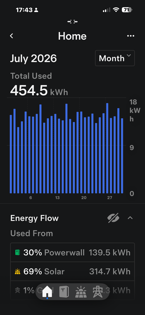

@papahuhu We are only using ~ 20kWh or less a day so should have 20 or so spare. With 27 kWh capacity I can do fairly well - just need OE to do the switch now. They have all the info, I have smart meter facilities and they have previously had control of my export via IOF so I hope it should not take too long to execute. Rewards, Toodles.
@papahuhu Just checked a few days; washing days can consume up to ~16 kWh including DHW, other days - ~10-14 kWh. No canabis though😉 Here’s the totals for each day of July. Regards, Toodles.
@papahuhu I blame all the technology; NAS, 7 smart speakers, iPads, cordless phones …. We are however, an all-electric household with induction hob, heat pump tumble dryer, a Sunamp Thermino DHW system, 2 x microwave cookers, air fryer, washing machine and a fridge/freezer plus a freezer. 😆 Toodles.
