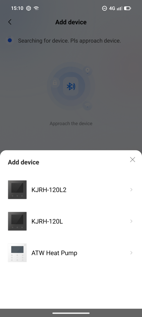

@davesoa I struggled to get in contact with my controller with the iLetcomfort app. It tried to connect with bluetooth and when that didn't work it gave me an option of a few different devices to try to manually connect to:
Screenshot 20260114 151005
none of which are familiar to me! Any ideas how to proceed?
(@davesoa)
Posts: 97
Sorry forgot about the three choices. It’s the 2nd one you need. Start with the WLAN settings on the control box and set it running as per my guide, staying near by, chose the 2nd item. I recall it took me several attempts to figure out how to do it. It’s not discoverable by Bluetooth.

(@cmartinbwmba)
Eminent Member Member
Joined: 10 months ago
Posts: 29
@davesoa Sorted this, really good. Even seems to have a hot water boost which I couldn't find on the Ideal controller. Only hitch is - it's free so I guess the developer only benefits from harvesting data. They can have my heating data if it means I don't have to get into the loft every time I need to make a small change!
