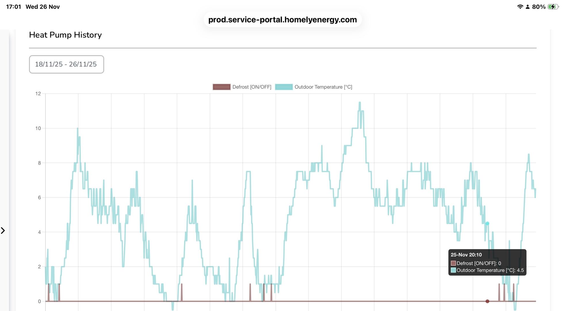

@jamespa I decided to look at my Homely data for defrosts and the first of this season was on the 18th. November (I have only noticed 1 of them myself) but the Daikin EDLA03 8 kW Monobloc has actually had 9 since the 18th. The plot shows outside temperature at the times they occurred.
Considering I live within a mile of the River Thames (as the Fly Crows), this seems reasonable to me. A cycle takes ~8 mins. from start to finish; the radiators go cool for about ~ 3-4 minutes but otherwise, I would be unaware of the procedure happening at all.

Posted by: @toodles@jamespa I decided to look at my Homely data for defrosts and the first of this season was on the 18th. November (I have only noticed 1 of them myself) but the Daikin EDLA03 8 kW Monobloc has actually had 9 since the 18th. The plot shows outside temperature at the times they occurred.

I wish I had only 9 defrosts in that timeframe. I had 16 in the early morning of just the 26 Nov.
