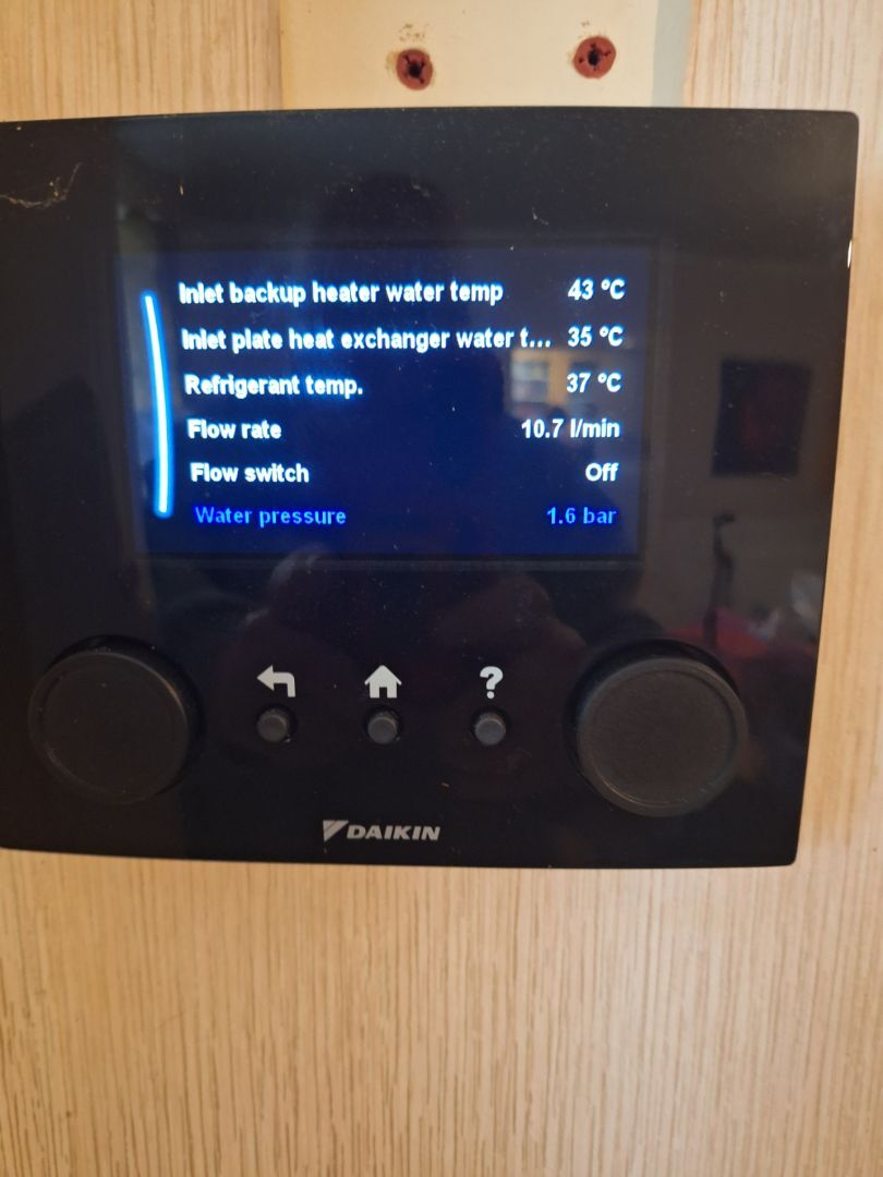

Daikin MMI attached to hot water cylinder.
We've started our Heat Pump install today, a busy day.
One question I wasn't expecting , the location of the Daikin MMI.
They have offered to attach it to the front of the hot water cylinder. I didn't know you could do that.
Is it a good place for it to go, or should I look to get it placed elsewhere in the cylinder cupboard?

Personally I wouldn't without first being certain this makes sense. Nor would I have it in the cylinder cupboard.
Chances are its got a room temperature sensor in and, if it has, you may want to use this unless you are operating in pure weather compensation mode throughout the season, which you cant really know until you have tried it.
The exception to this would be if, like my Vaillant, it has two MMIs, one designed principally for commissioning and the other for day to day operation. In this case the one designed principally for commissioning can of course go in the cylinder cupboard assuming that the temperature sensor is in the other.

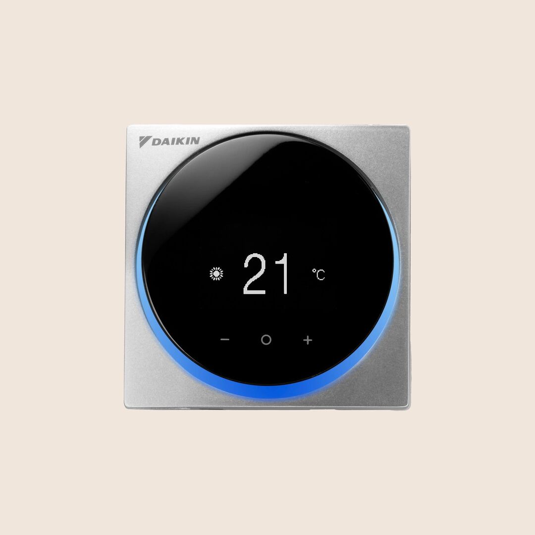

@bash, if you’re planning to use any form of load compensation, as @jamespa has also mentioned, I’d be careful where it goes. In our case the MMI was put inside the utility room cupboard with all the pipework and cylinder, and that space was permanently 24C+ because of standing losses. As a result the controller never saw a realistic indoor temperature, so load compensation was never available to us as a feature.
The MMI can physically be mounted on the front of the cylinder, yes, but whether it should be depends on how the system is being controlled. If it’s acting as a room reference, putting it in a warm cupboard full of pipes will skew everything. The heat pump will think the house is warmer than it actually is and back off when it shouldn’t, and that will be probably be disabled as a feature by the installers. I’ll caveat that by saying that this is obviously only relevant if Daikins have some form of load compensation, which I assume they do.
If you’re not using load compensation and it’s just there as a user interface, it’s less critical. But if LC is part of the design, I’d be pushing for it to be in a representative living space, or at the very least somewhere that tracks the actual internal temperature of the home, not a heat-soaked cupboard or space.

@jamespa I can confirm the Daikin has the modoka or however they spell it. My Daikin is set to LWT and only functions as a thermometer.
Daikin 6Kw ASHP.
Posted by: @jancold@jamespa I can confirm the Daikin has the modoka or however they spell it. My Daikin is set to LWT and only functions as a thermometer.
@bash That confirms it. The Madoka or equivalent (I think there is also another older generation device looking something like the below) should be in a representative room; strongly recommend no third party thermostats. Please dont let your installer fob you off with a third party thermostat as the only thing in a representative room.

The controller (I can never remember if it's Maduka or MMI) is what they suggest to attach to the cylinder so it's easy to access.

I think the one in the cupboard is the MMI and the one that looks like a thermostat the Madoka. The Madoka is described as a wired remote controller so I presume its actually a temperature sensor plus possibly some more functionality. Doubtless all will become clear
