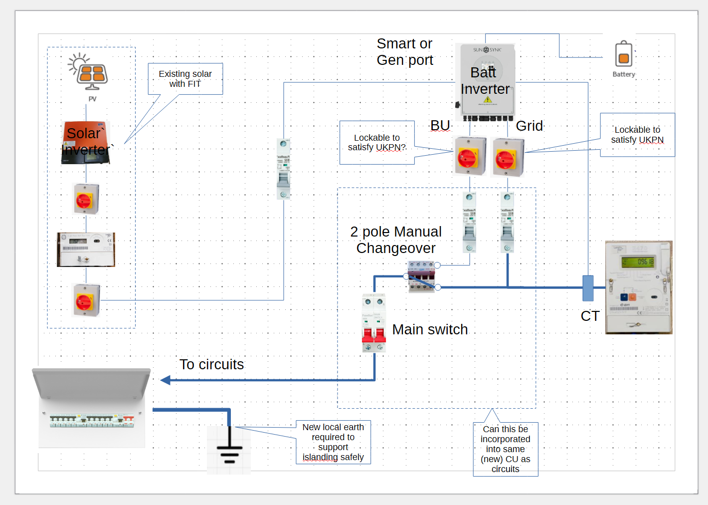

Posts: 5742
Your energy: 79 kWh
@little-lights If I understand you correctly your system is AC coupled, (ie you have 2 inverters).  Its the battery inverter you need to concentrate on which is why I mention battery compatibility above.
FWIW here is where I got to when I was trying to work out what I could do.  This would, I believe, work with either a sunsynck or a solis 'hybrid' inverter, possibly others.  Incidentally several inverters have some sort of 'gateway' module for whole house backup which sits between the grid feed and the inverter/CU.  These tend to be obscure in function, in my diagram I interpose manual switchgear to ensure (I think) that things can never be connected that shouldn't be connected.
My idea is not to separate backup circuits but just rely on the fact that my load rarely exceeds 5kW which is commonly available from BU ports, inverters can stand overcurrent for a short while and then self protect by shutting down, and I can self-censor circuits when its in backup mode if I have manual changeover.  The rationale for this is that I don't want to have to decide in advance which circuits to run on battery, because this will be different from winter to summer!
My proposed circuit is AC coupled because I need to keep the solar separate, due to the fact I have 10years of FiT (generation) tarrif still to collect at the best part of 30p/kWh (this is in  addition to the 12p/kWh I get from export).  In your case you may be able to use a single inverter and feed the solar panels directly to the MPPT ports of a single 'hybrid' inverter.
Hopefully this gives you some further food for thought.

We really need a sketch of what you've got if we were going to take this discussion further.
It doesn't need to be as good as the one James has just posted.
Hand-drawn on the back of an envelope will do, then take a photo with your smartphone.
