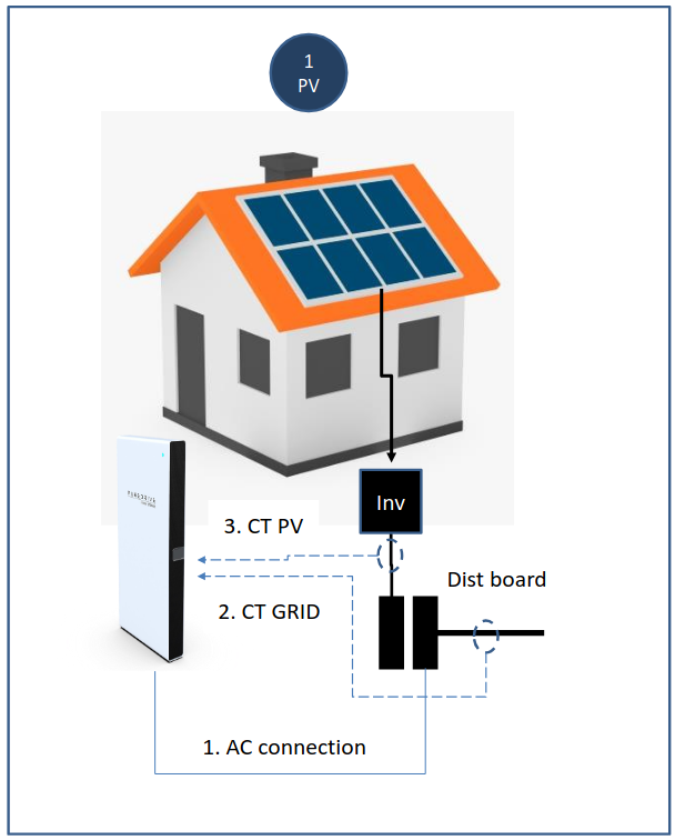

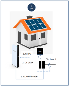

For example, I've come across a PureDrive Installation Manual which contains this diagram:
On its own the diagram suggests that the PureDrive battery can be recharged from the grid or from a solar string inverter.
To do so it requires measurements from two Current Transformer Clamps.
But I don't see any reference to CT Clamps in your description of what's been installed.
Secondly, both the PureDrive battery and the Solis S6-GR1P3K inverter have RS485 ports.
We don't know if your existing installation has already used either or both of those ports to connect to something.
Nor are we aware of the inverter having any external CT-clamp or meter which provides it with feedback.
However, if both RS485 ports remain unused then those have the potential to be connected to a self-built micro-controller such as a Raspberry Pi.
That may be heading into a field of technology which you hadn't intended learning about. But many people now use online AI tools to write the code for their projects, which makes the learning curve less steep.
... just a few thoughts to chew over!
