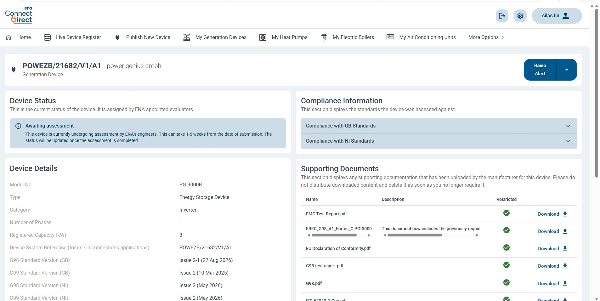

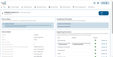

People following this thread who are hoping that plug in batteries will come soon may be interested in the post here
Our portal status is now "Awaiting assessment" under System Reference
POWEZB/21682/V1/A1. -
As confirmed directly by ENA support:"Your device(s) will only show on the Live Device Register once it has completed their assessment, whether found to be compliant or non-compliant. Until they've been assessed, they will not be present or visible in any public space."In short: the listing is temporarily hidden from the public search register while ENA engineers carry out their review. The typical review timeframe is 1 to 6 weeks.
